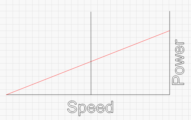

- Enable Variable Power mode to adjust the laser's power output from 0% when the laser is stopped, to 100% of the power output you've set, once the laser reaches the full speed you've requested the job run at.

With variable power mode enabled, if you ask the controller to go faster than it's allowed to go, it will reduce the output power to compensate. If you ask for 100% power at 50 mm/second, but the controller can only go 25 mm/second, the laser will only move at half the speed you asked for. Without variable power mode, the power will remain at 100%, resulting in a much darker mark than expected. With variable power mode, the power will be reduced to 50% to match the reduced speed.
