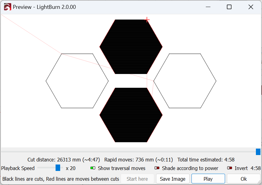

Understanding the Preview Window
The Preview window
When you first open the Preview window, you'll see a still image of the final result of your project — the contours to be scored or cut by Line Mode will be indicated by black lines, and the areas to be etched or engraved by Fill Mode will be shown as solid black areas, or, if your Line Interval is relatively large (or you zoom in close enough) as parallel lines running across the filled shapes.
You'll also see red lines — these lines indicate the path your laser will travel while not firing. You can toggle Show traversal moves at the bottom of the Preview window to switch between showing these moves or not.
If what you see here doesn't align with your expectations, you've got some editing to do. Make sure all of your shapes are set to the correct layers, and those layers are set to the correct modes. If you're working with layers set to Fill Mode, make sure they're overlapping only as you intend.

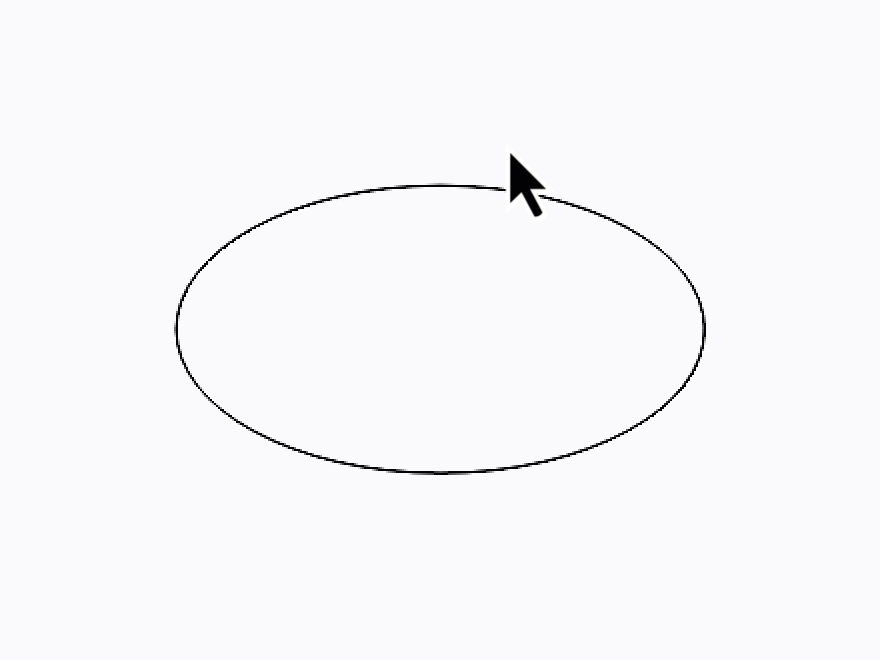

    • Go to Edit → Delete Duplicates or press Alt/Option+D to delete duplicate shapes.
      Delete Duplicates

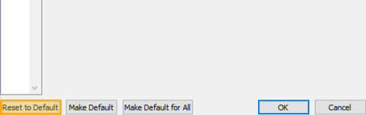

  • If you see several strange things and can't identify the cause, double-click the problematic layer to open up the Cut Settings Editor, click Reset to Default in the lower left corner, then re-apply just the essential settings such as Speed and Power.
    Reset to Default button

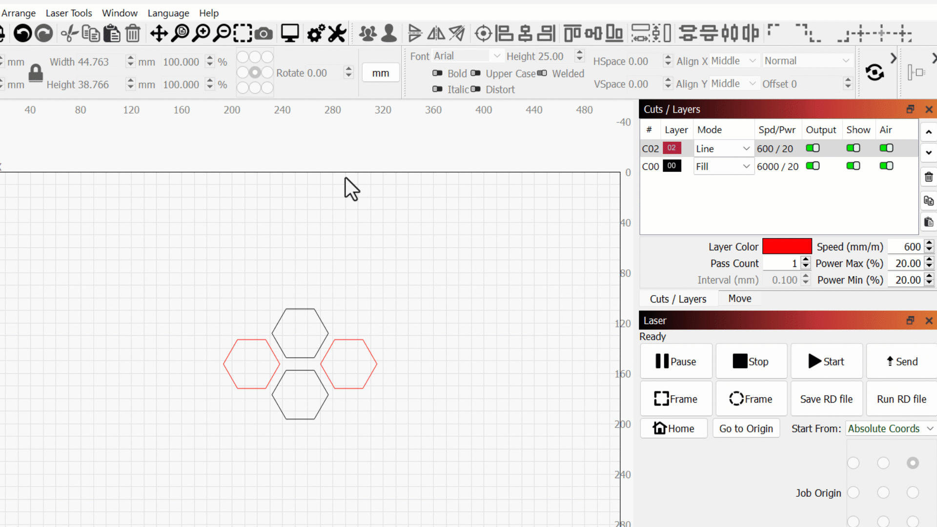

If you don't like the order the operations are performed, change their position in the Cuts / Layers Window. As a reminder — by default, the first layer in the Cuts / Layers Window is performed first, followed by the second, and so on.
