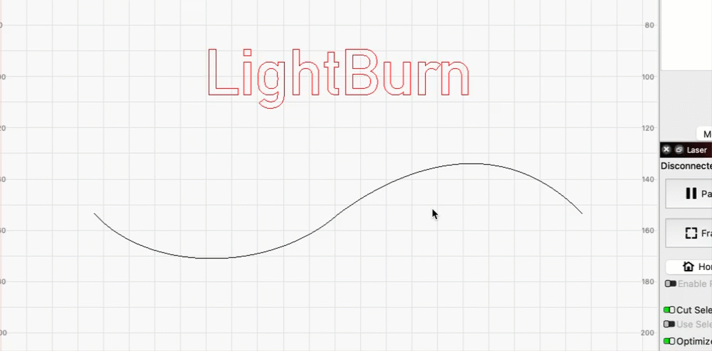

Select a single block of text and single shape at the same time, then go to Tools → Apply Path to Text, or right-click and select Apply Path to Text from the context menu.
The text is automatically moved to the location of the shape, and adjusted to follow its contour.
The text can no longer be independently moved after it is attached to the path, but all text attributes in the Text Options Toolbar can still be modified.

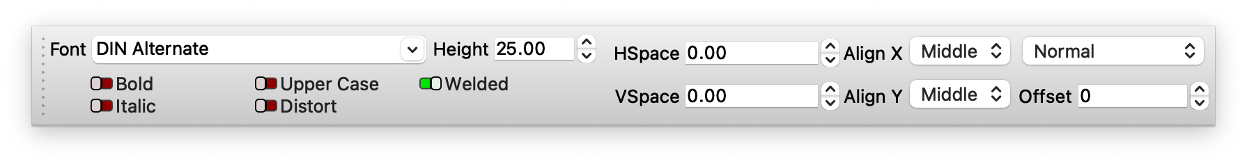

Making Adjustments in the Text Options Toolbar
Note
In the case of text, horizontal always refers to the direction of the text as it is read, regardless of whether the Text Object is rotated. Vertical refers to the opposite direction, regardless of rotation.
The horizontal position of the text is oriented relative to the start and end points of the path using the Align X options. Middle aligns the text between the start and end points, Left aligns it so that the start of the text is next to the start point of the path, and Right aligns it so that the end of the text is next to the end of the path.
The vertical position of the text is positioned using the Align Y options. Middle places the text's vertical center on the path, Bottom places the bottom of the text directly on top of the path, and Top places the top of the text directly under the path.

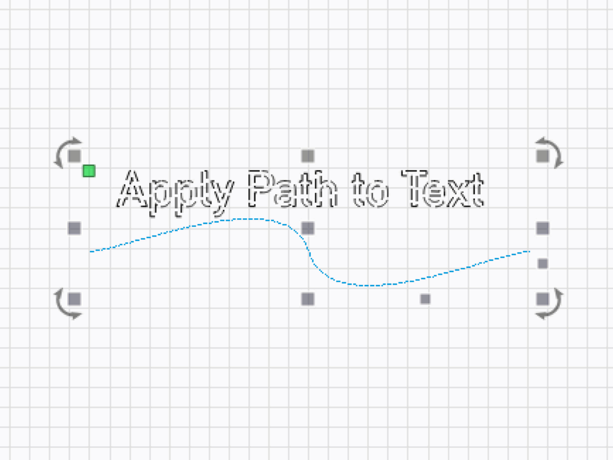

The position and shape of the path remain manipulable, and the text will automatically adjust to follow any changes made to the contour of the path.
Using Edit Nodes to manipulate paths

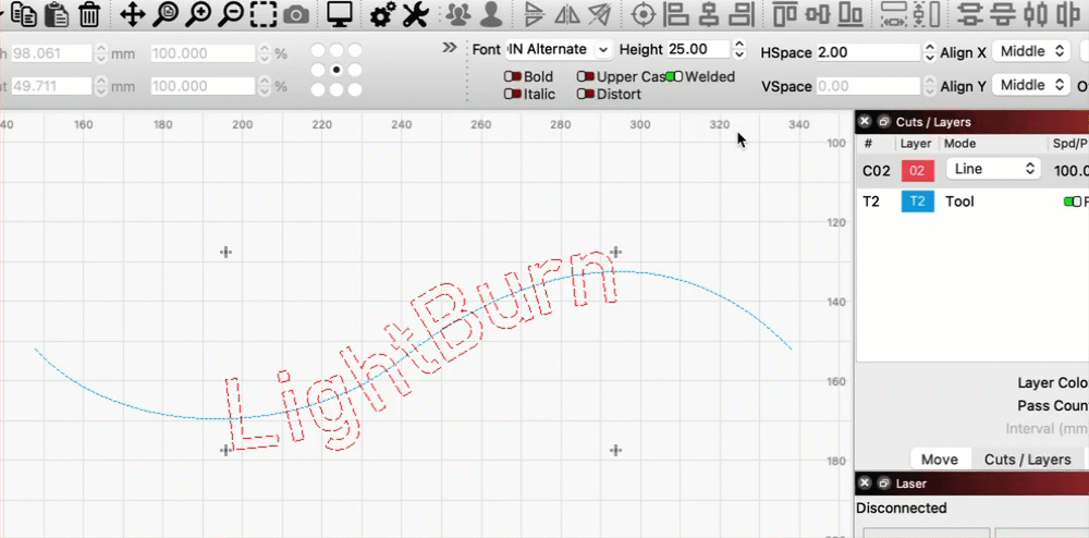

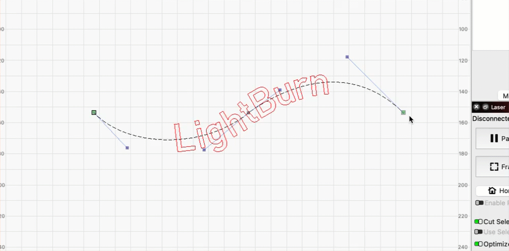

Use the Edit Nodes tool to manipulate nodes on a path that has already been applied to text, and adjust its appearance according to your visual preference.
Adjust Path
To remove the text from the path, the path must be deleted. Deleting the path returns the text to its original orientation, but does not affect any settings in the Text Edit toolbar.
