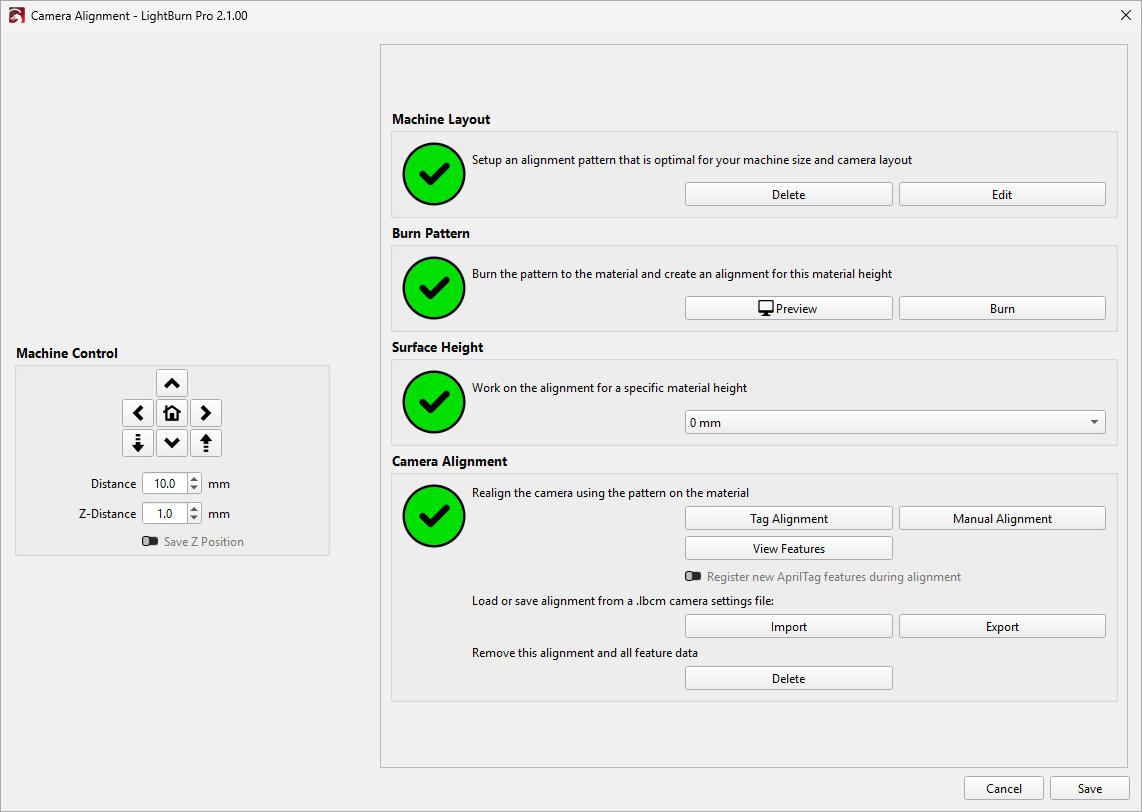

3. Select your Alignment Method.
You can use automatic or manual Camera Alignment. The automatic method is quicker and easier, but requires good lighting and high contrast between the marked pattern and the background material.
Screenshot showing the start of automatic alignment
Overview screen for automatic alignment.
Screenshot showing the start of manual alignment
Overview screen for manual alignment.

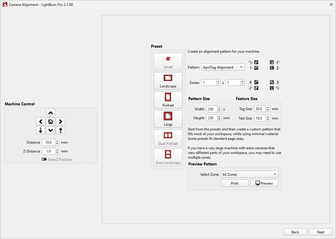

4. Set Up Your Alignment Pattern
Next, you'll set up your alignment pattern. The screenshot below is from the Automatic Alignment wizard, but the only difference for Manual Alignment is that there are no AprilTags - all the settings work the same between the two.
Screenshot of alignment pattern generator
Place and Scale Pattern
When creating the pattern, it should be:
  • Roughly centered in the camera view.
  • Sized to fit on your engraving material.
  • Created with features large enough to be clearly visible in the camera, but not so large they take an excessively long time to engrave.
Pattern Size Parameters
  • Feature Width: The size of the calibration features.
  • Pattern Width / Pattern Height: The width and height of the overall pattern.
  • Preset: You can choose one of several presets as a starting point. To go back to the defaults, you can select Center from the dropdown.

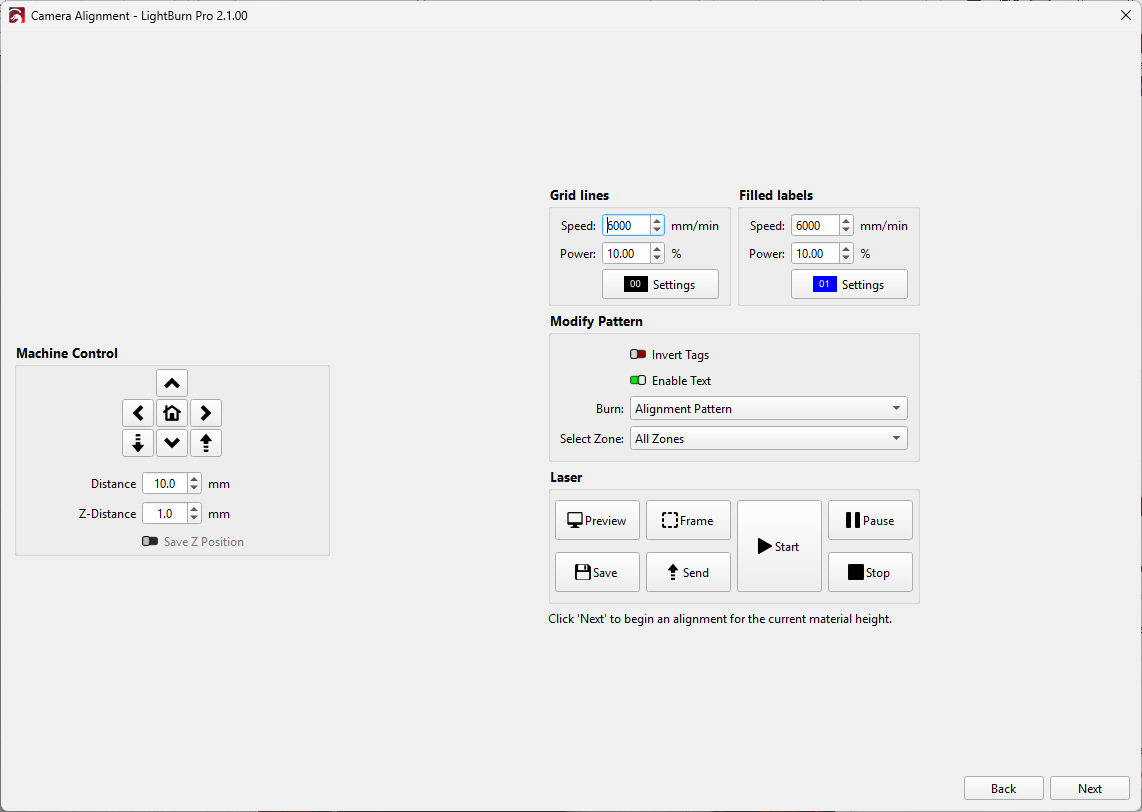

5. Burn Alignment Pattern

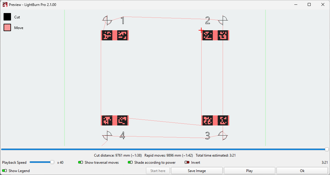

Place your material in the laser cutter and get ready to burn the alignment pattern.
Screenshot of Burn Alignment Pattern screen
Use the camera preview to make sure the material is near the center of the image and clearly visible. Use Frame to make sure the pattern fits the material, and use Preview to see what will actually be burned. Use the Machine Control section in the lower left to move your laser head around if needed.
Adjust your cut settings to engrave a dark, crisp mark without cutting through the material. You can adjust your settings in a few ways:
  • Adjust speed and power right in the Alignment Wizard window, just below Laser Settings.
  • Click the Import button to load a layer from your Material Library.
  • Click Settings to adjust your layer settings in the Cut Settings Editor.
Run the job using Start or Send, however you'd usually control your laser.
Do not move the pattern after you burn it, or you will need to burn a new alignment pattern.
