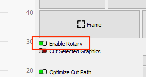

Enable Rotary
Tip
If Show rotary enable in main window is enabled in your Settings/Preferences, you can also enable or disable Rotary Mode using the switch in the Laser Window.
Rotary Enable Switch
This switch controls whether Rotary Mode is enabled. When enabled, rotational commands are sent to the laser to control rotary motion, and output is split into segments.

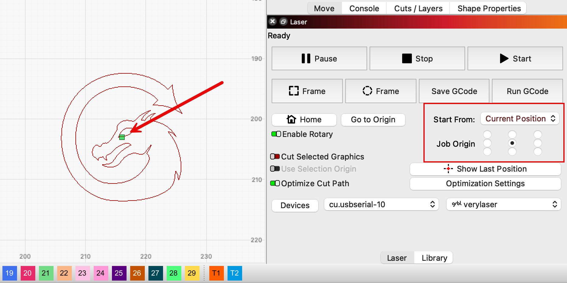

In most cases, Current Position is the best Start From mode to use when working with a rotary.
Align the object under your laser head in the X dimension. Output will be positioned on the object in the X dimension relative to the laser head and Job Origin selection. The Job Origin is indicated on your graphics by a green square. Parts of the graphic to left of the green square will output to the left of your laser head, and parts to the right will output to the right.
Turn the rotary or object on the rotary to determine where the engraving will output on the object in the dimension of rotation. Output in this dimension is also determined relative to your Job Origin selection — the rotary will turn to reach graphics positioned above or below the Origin.
See Coordinates and Job Origin for more information on the Start From mode and Job Origin settings.
Job Origin Rotary
In the above example, output will be centered around the starting position of the laser head.
