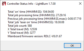

The Controller Status Info window provides information about your connected laser's controller. It primarily shows usage statistics, but also contains information about the controller's firmware version.
To view Controller Info, go to Edit → Get Controller Info.
Note
Get Controller Info is only available for lasers with Ruida controllers.
Name Description
Total "on" time Total time the laser has been on for.
Total job processing time The total time the laser has spent processing jobs sent to it.
Previous job processing time The time the laser spent processing the most recent job sent to it.
Total job "laser on" time The total time the laser has spent running jobs.
Total job count The total number of jobs run on the laser.
X Total travel The total horizontal distance traveled in meters.
Y Total travel The total vertical distance traveled in meters.
Mainboard firmware version The firmware version installed on the laser controller.
