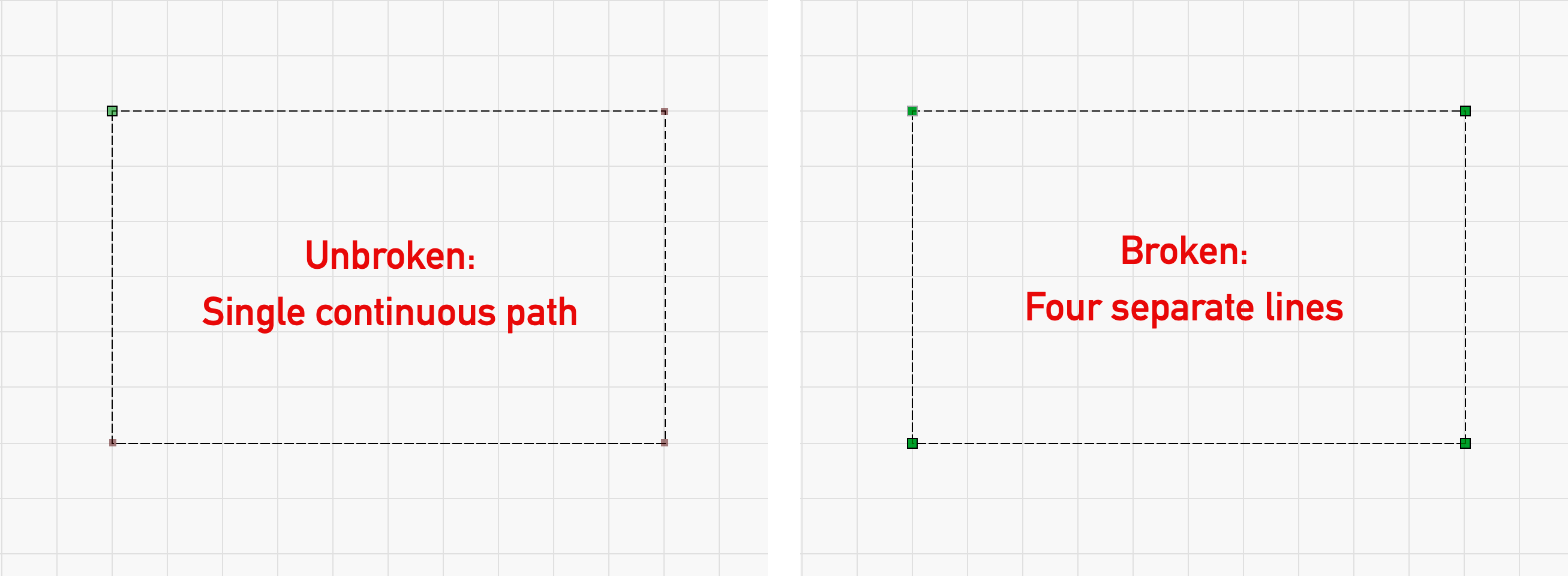

For example, a rectangular vector graphic is a path made of four straight lines connected by four nodes, with one node that is both the start and end of the path. Breaking Apart a rectangle results in four disconnected lines, each with their own start and end node.
Left: an unbroken rectangle with one start and end node in green Right: four separate lines with eight start and end nodes
