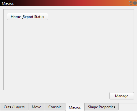

Screenshot of the macros window with one macro present
Click on macro buttons in the Macros Window to use them.
