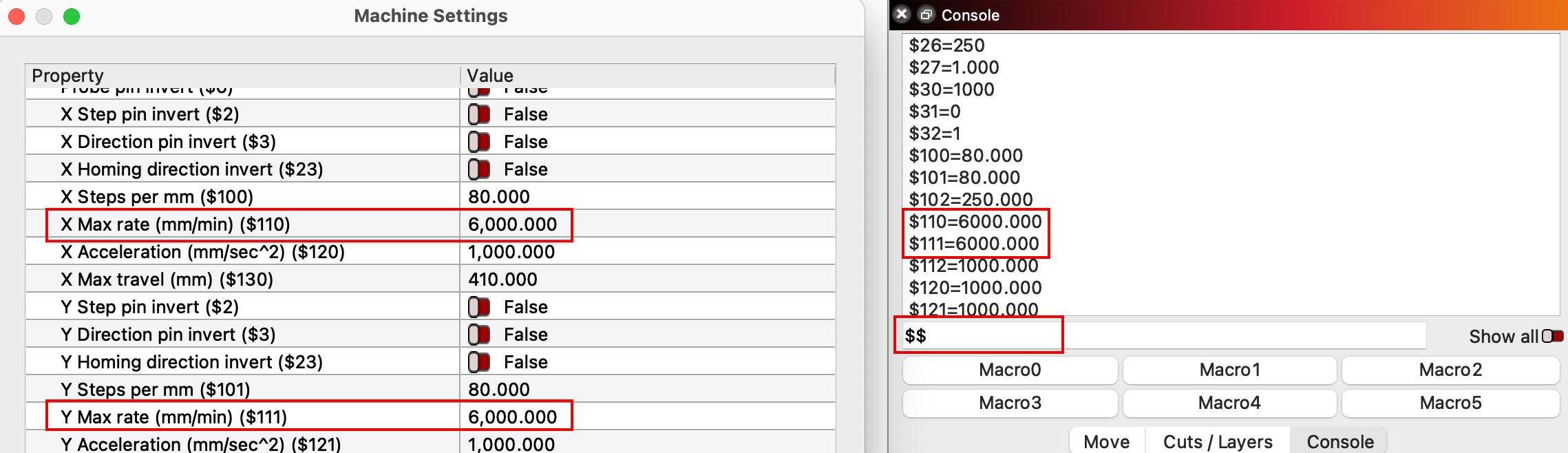

Setting Speed Too High in Variable Power Mode¶
The most common cause of this issue is commanding your laser to run faster than its maximum allowable speed, leading to power downscaling. When Variable Power mode is enabled, the power level is 0 when the laser is stopped, and increases as the laser head accelerates toward the requested speed. This makes the resulting burn more consistent. However, if you ask the laser to go faster than it is able, it will never reach the requested speed and therefore never reach the requested power level either.
Solution¶
Set speed within the allowed range of your machine. Go to Machine Settings or enter
$$in the Console window to see the \(110/\)111, X/Y Max rates set in your machine's firmware. The X and Y Maximum rates are the fastest you can command your machine to travel, in mm/minute. -
Double-check the units of speed you are using. A given value in mm/second is much faster than the same value in mm/minute. Most diode manufacturers provide suggested settings in mm/minute. If you prefer to use mm/second, take care to properly convert the values. You can switch to mm/minute, or another unit of measurement, in the Settings window.

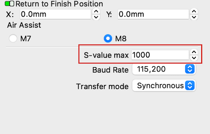

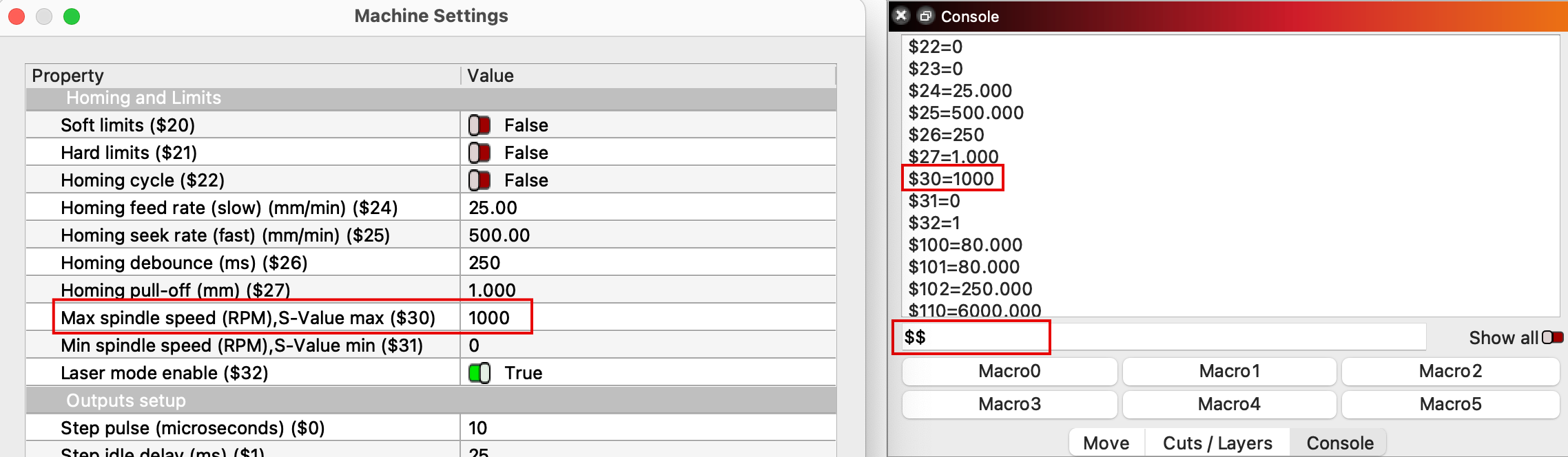

S-Value Max Set Incorrectly¶
If you've already lowered your speed and are still seeing lower than expected power output, the S-value max setting in the Device Settings window could be incorrect. This number tells LightBurn how to represent 100% power for your machine. Current versions of GRBL default to 1000 for this, while older versions use 255. The important thing is for the numbers to match. If your machine expects 1000 to mean full power and receives 255 from LightBurn, you'll get roughly ¼ of the expected power output.
Solution¶
$$in the Console window to see the $30, Max spindle speed setting in your laser's firmware. -
Adjust the S-Value max setting in Device Settings to match.
