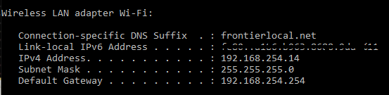

Open the command prompt (type "cmd" in the start menu or in the Win+R search box). At the command prompt, type ipconfig, and press Enter. Your results will look similar to this:
The line that says IPv4 Address is what you're looking for. Make a note of this address and move on to choosing a unique IP address.

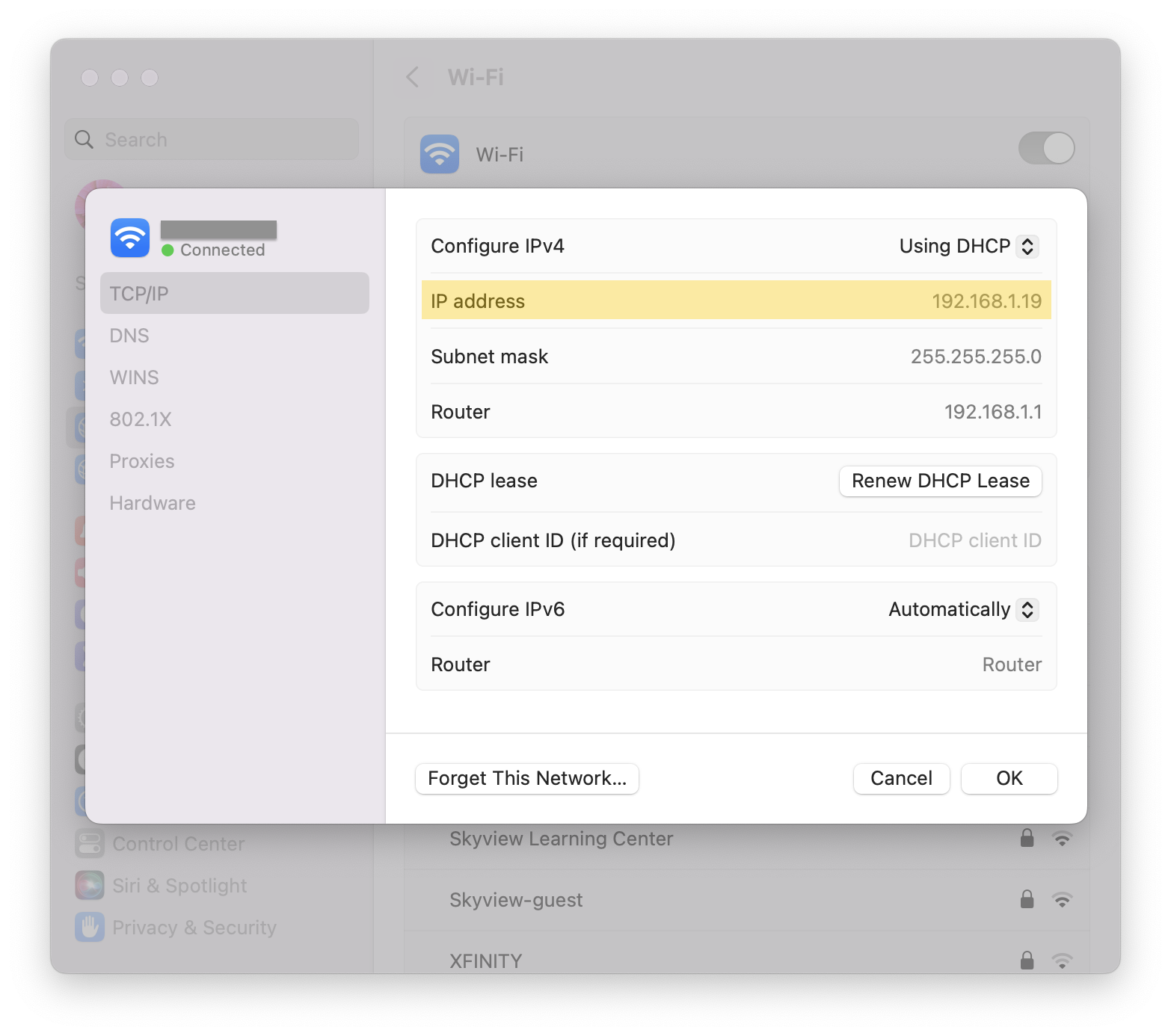

Mac
Open Spotlight with Cmd+Space and type IPv4 into the search bar to bring up your IP address in system settings.

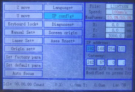

On the Ruida controller, use the Z/U or Menu buttons to enter the menu, navigate to IP config+ , and press enter to access that menu setting. On the right side of the screen, the IP address field and gateway will be visible. Use the left/right arrows to move through the octets (sections), and the up/down arrows to change the value. Press and hold the up/down arrows to change the value.
When done, press the Enter button.
