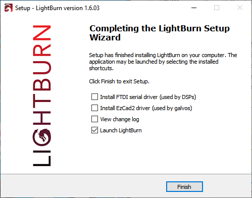

Installing the Driver (EZCad2 and EZCad3 Lasers)
When installing LightBurn, the last screen of the installer has a set of checkboxes to install additional drivers needed for certain types of machines. You'll need to select Install EZCAD2 / EZCAD3 driver in order for LightBurn to communicate with the Galvo laser you're trying to set up.
If you didn't check this box during initial installation, you can run the installer again, and select the box to ensure the driver is installed. Windows will prompt you for permissions escalation to install it, and replace the driver provided by default with one LightBurn can use to communicate with your galvo-based laser.
If you prefer to install the driver manually, you can find the installer at C:\Program Files\LightBurn\EzCad2Driver\ and can be run again via the dpinst-x64.exe file directly.

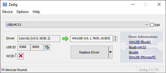

If the driver installed automatically isn't working, you can try using Zadig to replace the manufacturer's driver with a generic one so LightBurn can communicate with it. This occurs most often on Windows 7 computers.

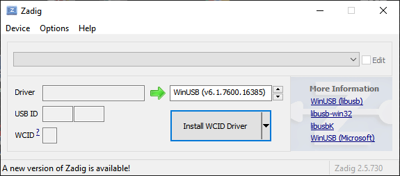

Download Zadig, the driver replacement tool from https://zadig.akeo.ie/ and run it. Zadig doesn't need to be installed.
You'll see a window that looks like this:

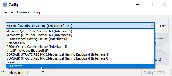

In Zadig, go to Options → List All Devices.
If your EZCAD laser is powered up and connected with the USB cable, you should see USBLMCV2 (or very similar) in the device list, like this:
Select that device and choose WinUSB as the target driver, like this:
Zadig ready to swap

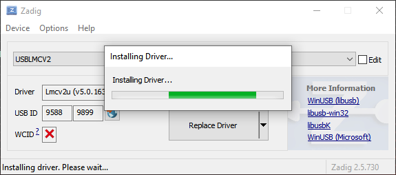

  1. Double check that it says LMCV2U in the Driver box, and that the USB ID under it matches what you see above. If you haven't used the laser with this computer before, the Driver box may be empty instead.
  2. Click Replace Driver and wait for the process to complete. Make sure that you are not running EZCAD when you do this — if anything is actually using the hardware, the driver swap will likely not complete, and time-out after five minutes. If everything goes as expected, it takes about a minute, often less.
  3. You'll see some different messages cycle through while it does the install. When it's done, it might ask you to reboot, but that's rarely required.
    Zadig installing progress bar

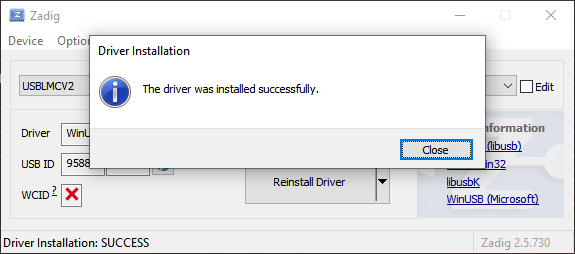

  4. On the rare occasion that Zadig fails, try it again — it almost always works, and sometimes reports a failed installation erroneously, when it actually succeeded. You should see this:
    Zadig success message

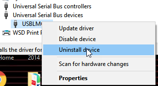

Open the Windows Device Manager.
Windows device manager
Next, find the USBLMC device in the list - it should be near the bottom, under Universal Serial Bus devices, shown below:
Find device in device manager

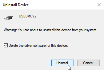

Right-click the device and choose Uninstall Device from the pop-up menu.
Uninstall device
In the next window, check the box to delete the driver. This doesn't actually delete anything from your system, it just completely disassociates the driver from this device.
Really uninstall device
Click the Uninstall button. The process should finish quickly.
If you power off the laser and power it back on, Windows will reconnect, realize that it already has a driver for this device (the old LMC driver) and it will appear in the Devices list again, near the top, as a BJJCZ Device. Now you can use EZCAD again.

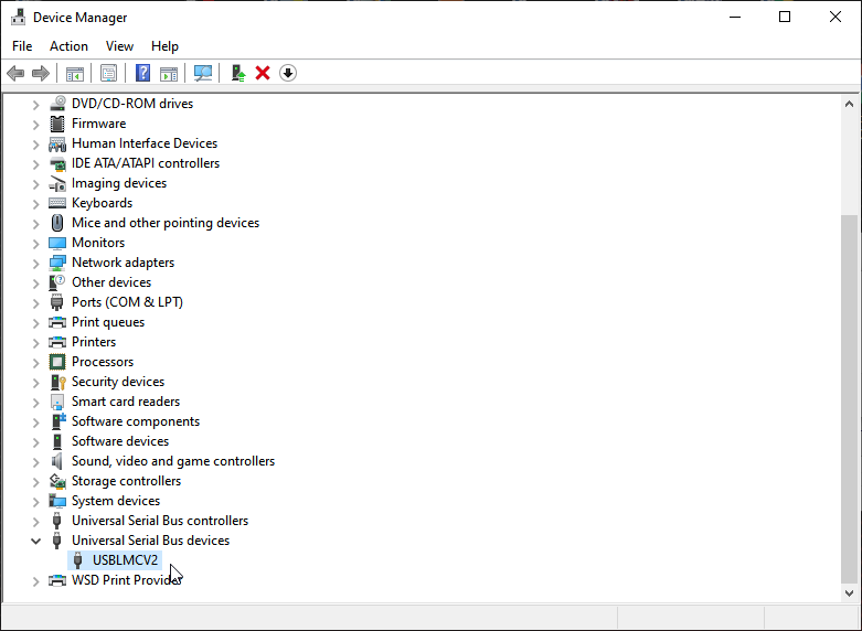

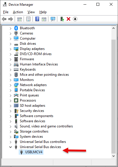

Verify Driver Installation

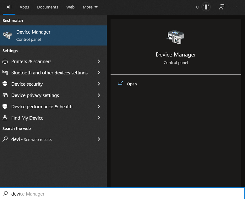

Opening Device Manager
To open the Device Manager, type "device manager" in the search box on the taskbar, then select Device Manager from the menu.

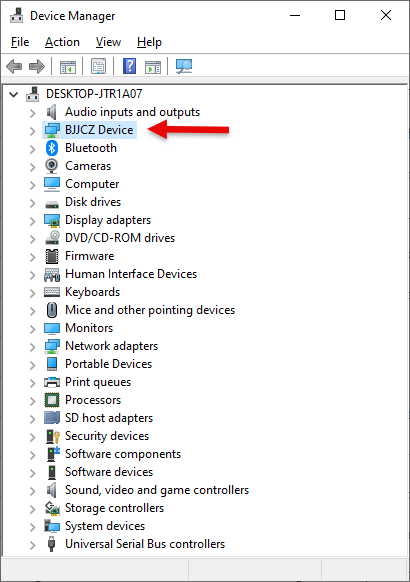

Your laser will appear differently in the Windows Device Manager before and after the driver has been successfully installed.
  • Before installing the driver, the laser will appear as a BJJCZ Device. If you see this, the correct driver is not installed.
  • After installing the driver, the laser will appear under Universal Serial Bus devices:
  • For EZCad2 devices, you should see something along the lines of USBLMCV2, USBLMCV4, or something else with LMC in it.
  • For EZCad3 devices, you should see a name that contains some variation of DLC.
Before Galvo Driver Installation
An EZCAD-based Galvo device as it appears before the driver has been installed

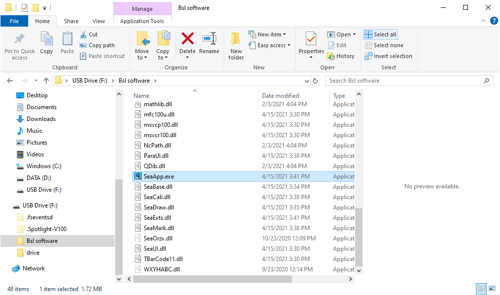

Install Stock BSL Software
Search the USB drive that came with your laser for the executable file that installs your laser's stock software. Double-click the file to begin the installation process.
The SeaCAD executable file
The SeaAPP.exe file will install SeaCAD, along with the necessary driver. The specific name of this file and stock software may vary for your laser.

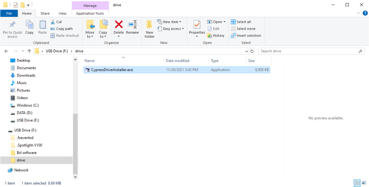

Install the Cypress Driver
Search the USB drive that came with your laser for the executable file that installs the Cypress driver. Double-click the file to begin the installation process.
The CypressDriverInstaller.exe file will install the necessary driver for this laser. The specific name of this file may vary for your laser.

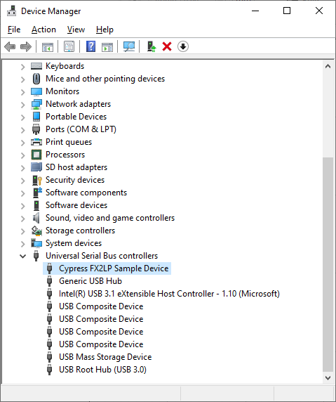

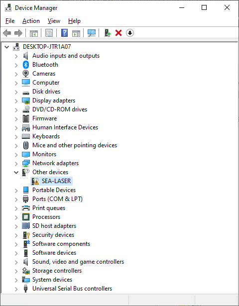

  • Before installing the driver, the laser will appear with a caution/warning symbol next to its name. If you see this, the correct driver is not installed.
  • After installing the driver, the laser will appear under Universal Serial Bus controllers as SEA-LASER (with no caution/warning symbol), Cypress FX2LP Sample Device, or something else similar.
A BSL-based Galvo device as it appears before the driver has been installed
