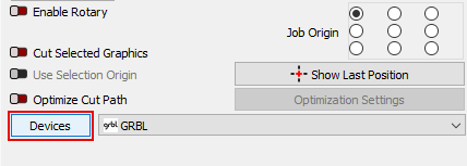

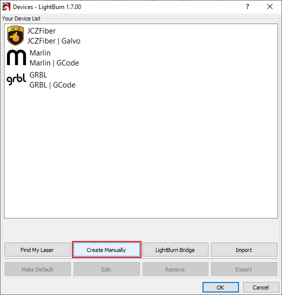

Start by clicking the Devices button in the Laser window to open the Devices window.
Devices Button
Click the Create Manually button in the Devices window to open the New Device Wizard.
Create Manually

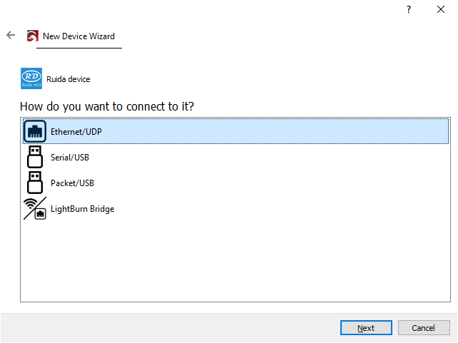

Connection Type
The next step is choosing how you connect to your laser. The choices you see will depend on the type of connection methods supported by your controller and LightBurn.
Create Manually Connection Type
  • Ethernet or Wifi/TCP is used for both wired and wireless network connections.
  • Serial/USB is the most common connection type, used for direct USB connections.
  • Packet/USB is an alternative option for Ruida controllers only, which uses a built-in driver, similar to RDWorks. This option can be inconsistent on some systems, and is best not to use unless you're having issues with a Serial/USB connection.
  • LightBurn Bridge is used to connect to a LightBurn Bridge. This option is available for Ruida controllers only, and if this is your first time setting up a Bridge, it's best to use the Bridge Discovery Wizard instead of Create Manually.
After selecting your connection method, click Next.

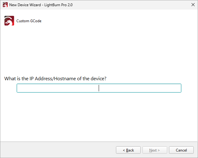

Ethernet and LightBurn Bridge — Set IP Address
Ethernet on macOS 15+
If you're using macOS 15 or higher, you'll need to allow LightBurn access to the local network.
If you selected Ethernet or Wifi/TCP, or LightBurn Bridge as your connection type, you'll need to enter the device's IP address or hostname on your local network.
Network IP Address
After setting the IP address, click Next.

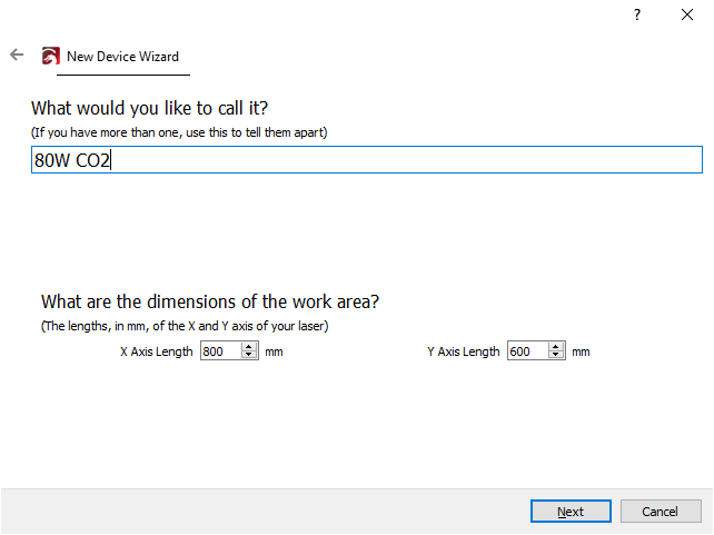

Name and Work Area Size
You can give your laser a custom name, which is often useful if you have more than one, or just leave it as is.
You must set the size of the work area for your laser so that LightBurn can customize the Workspace to match the laser's working dimensions. If you don't know the exact size, you can change this later in the Device Settings window.
Name and Dimensions
After naming and entering your machine's dimensions, click Next.

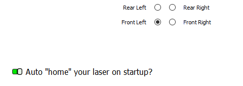

Laser Origin And Homing
The Origin setting is your laser's 0,0 point — where the X & Y Axis both meet and begin. If you get this wrong, you can change it later in the Device Settings window.
New Device Origin Settings
  • With a few exceptions, the Origin for GCode lasers is almost always the bottom left.
  • If you have a DSP laser, set the Origin to the location the laser homes to when it first powers o.
  • If you are unsure about your laser's Origin point, consult your laser's manufacturer.
  • The Origin also controls the orientation of output to your laser — if it's wrong, output to your laser may be mirrored or upside down.
If you have a GCode based system, you'll see the option to send the homing command each time LightBurn first connects to your laser. You can change this setting later in the Device Settings Window.
New Device Wizard Auto-home Option
Warning
If your laser does not have homing switches, leave this off.
After setting the Origin, click Next.

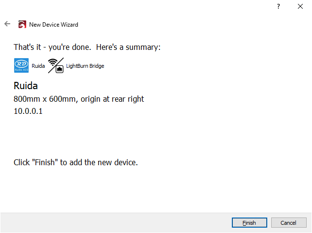

Review Settings
The final page will show you a summary of your choices. You can click Back to return to a previous step and fix anything if necessary, or click Finish to create the new device entry.
NewDevice-Finished
Confirming Device Creation
Click OK to save and confirm the creation of the new device. You'll return to the Devices window once you've exited the New Device Wizard.
