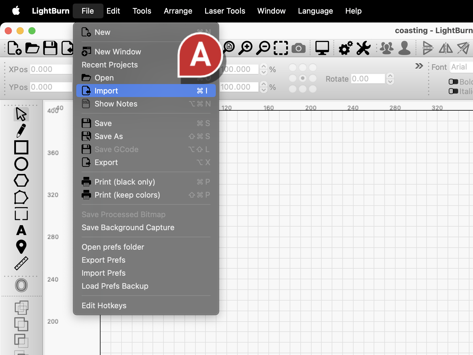

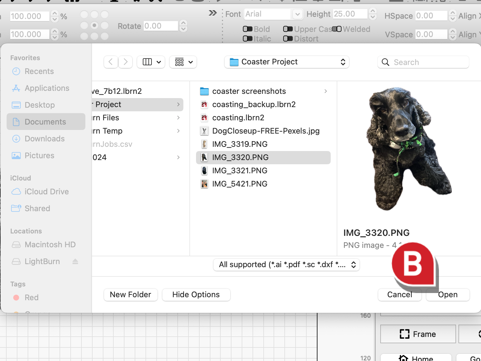

1. Import Your Image Into LightBurn
  1. Go to the File menu and select Import, or press Ctrl+I for Windows, or Cmd+I for Mac.
  2. Navigate to the location your image is saved to on your computer and select it.
Note: I removed the background from this photo using my iPhone's Lift feature, but you can also use a free tool like Pixelcut or delphitools to do the same.

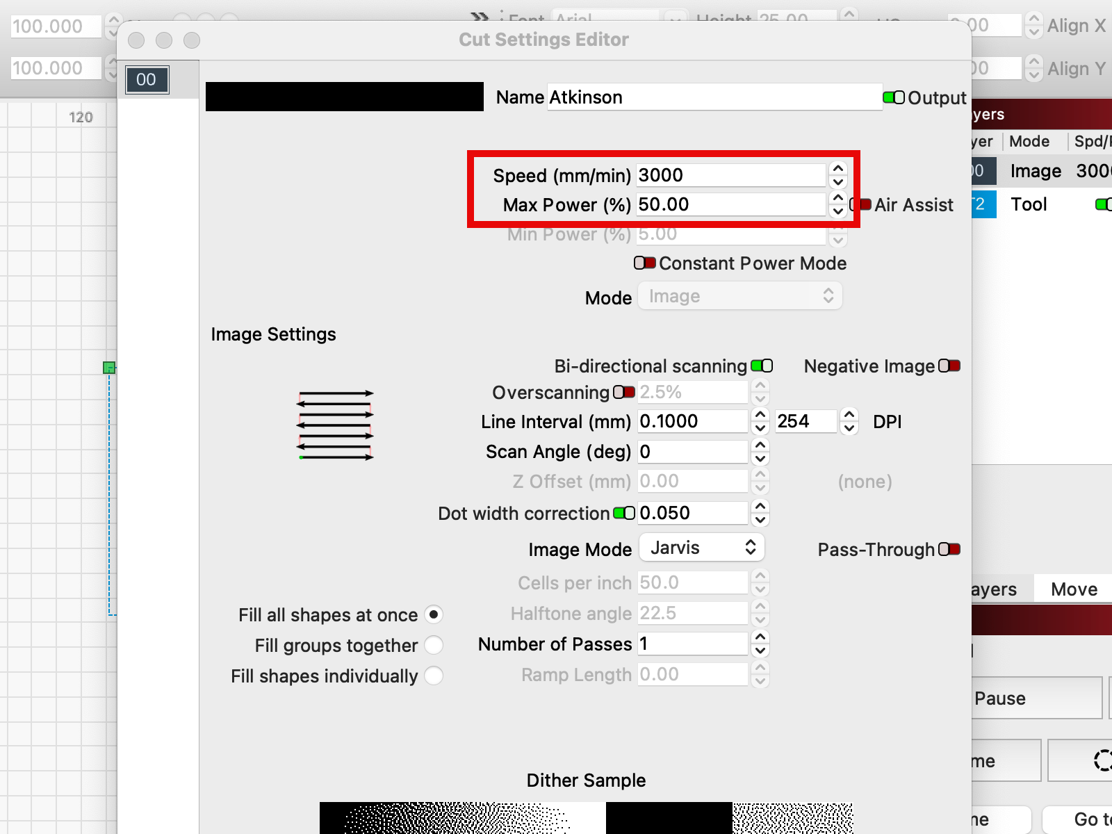

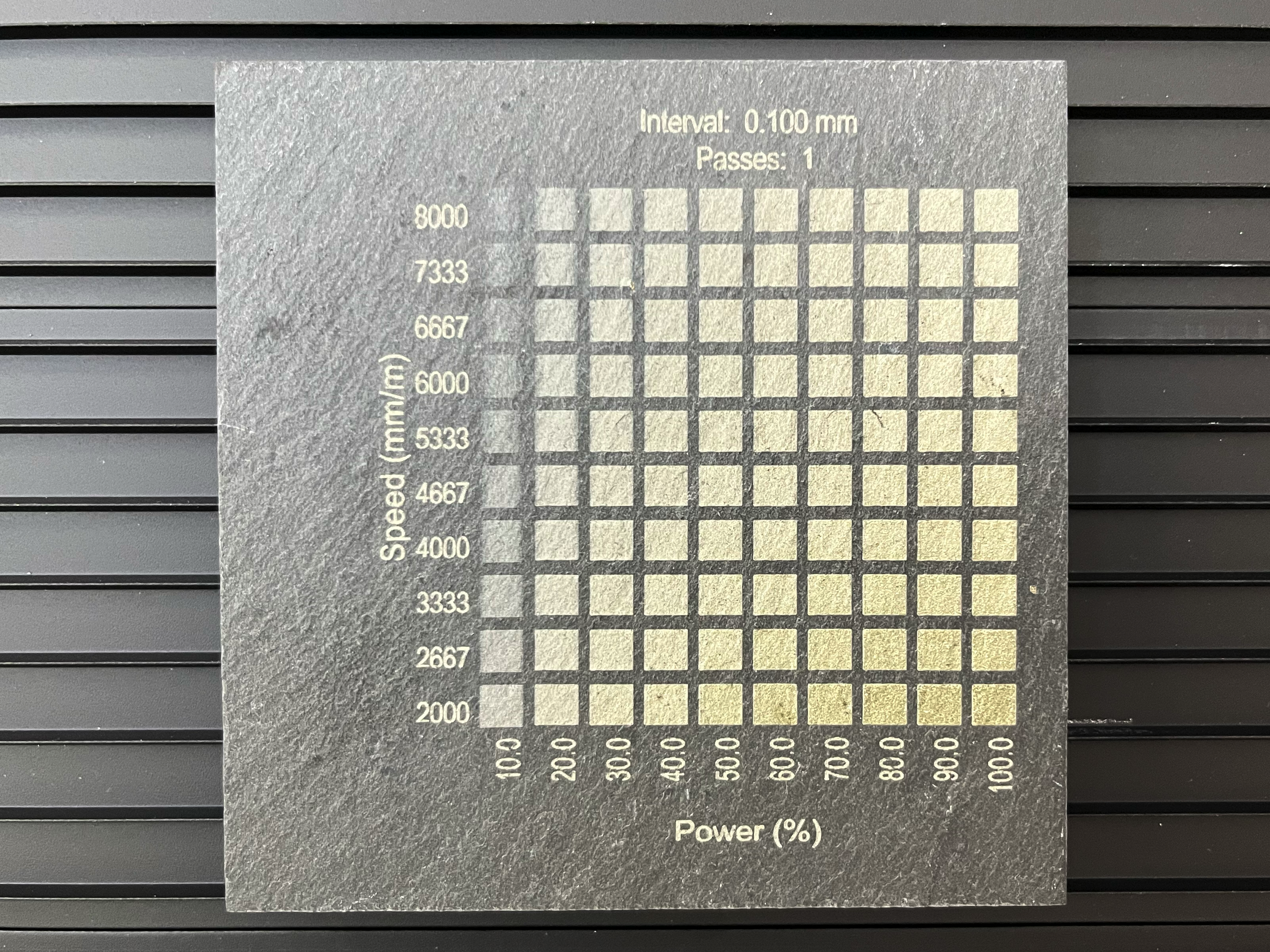

2. Apply Layer Settings
  1. Double-click the Image layer in the Cuts/Layers window to open the Cut Settings Editor and apply Speed and Power settings.
  2. If you're unsure what settings to apply, try running a Material Test. A test grid ranging from 10% to 100% power, and 2000 mm/minute to 8000 mm/minute is a good place to start. Watch our full video guide on setting up a Material Test here. You may also enjoy our guide to better image engravings.
  3. You may also be able to find some suggested settings on your laser manufacturer's website.
There is a lot of variability between lasers, and no one-size-fits-all settings, so be prepared to test and experiment with your settings.

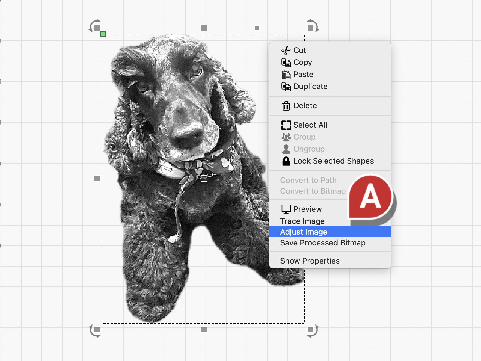

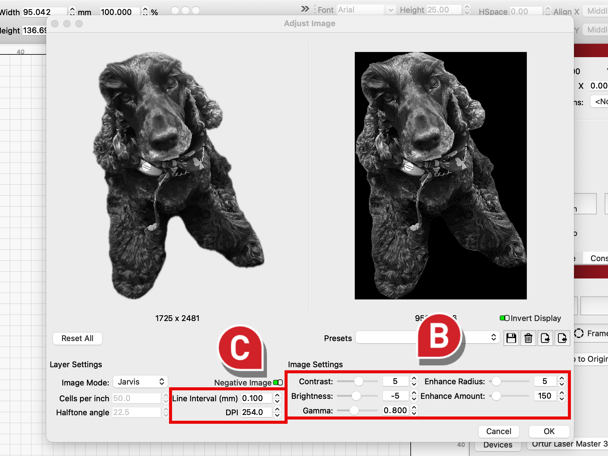

3. Adjust Image
  1. Right-click the image and select Adjust Image.
  2. Apply some standard starting point settings:
    • Stucki or Jarvis Image Mode
    • DPI: 254
    • Gamma: 0.800
    • Contrast: +5
    • Brightness: -5
    • Enhance Radius: 5
    • Enhance Amount: 150
    • Gamma adjusts mid-tone shading. Lower values make the mid-tones brighter, and higher values make them darker. Contrast makes bright shades brighter, and dark shades darker. Brightness makes all shades brighter or darker. Together, Enhance Radius and Enhance Amount increase contrast along edges.
  3. When engraving on a dark surface like a slate coaster, you'll want to enable Negative Image.
As with the Layer settings, be prepared to test these settings, and adjust according to the results you see.

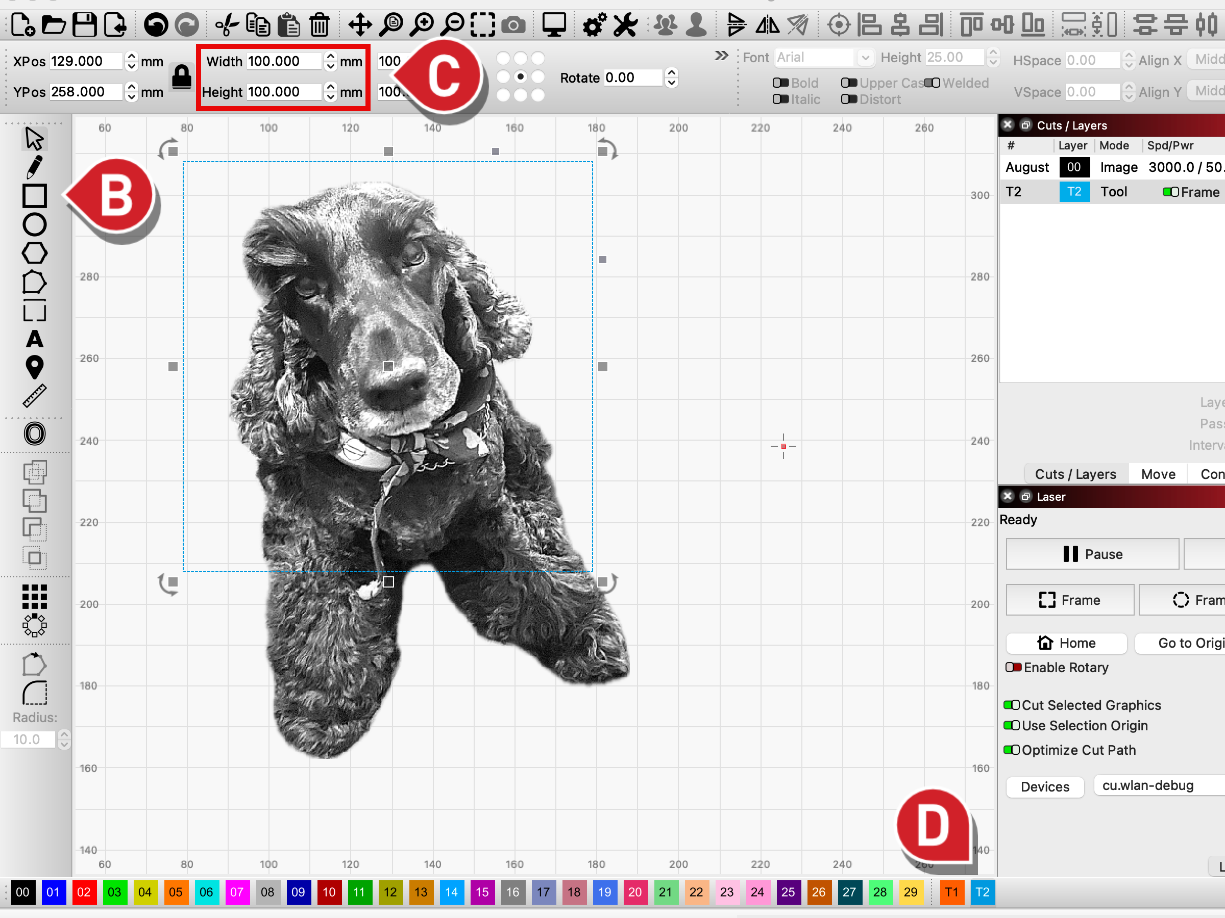

4. Create a Template of Your Coaster
  1. Measure your coaster.
  2. Create a shape in LightBurn using the Rectangle tool, for square coasters, or Ellipse tool, for circular coasters. Holding the Shift key while creating the shape will keep it perfectly square or circular.
  3. In the Numeric Edits toolbar, set the shape's dimensions to match the measurement you took of your coaster.
  4. Set it to a Tool layer.

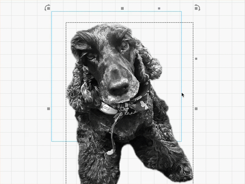

  5. Resize the image to fit to the shape - it's ok to leave some of the image outside the shape, we'll take care of that in the next step.

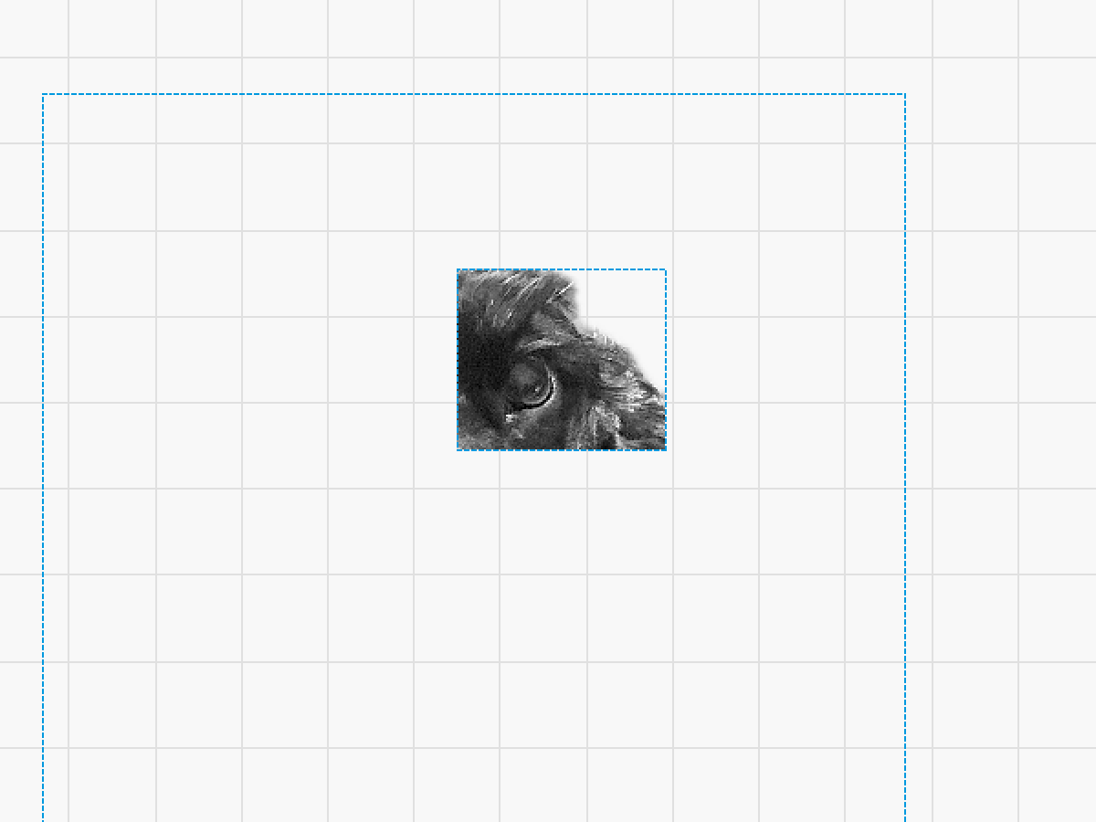

5. Apply Mask to Image
  1. Select your image and the Tool layer, then right click and select Apply Mask to Image, or go to ToolsApply Mask to Image.
  2. You can move the Tool layer around after applying the mask, if you'd like to adjust the area of the image that is masked. To remove a mask, right-click and select Remove Mask from Image.
  3. Masking can also be a great help in testing settings. You can mask off a small area of your image and etch just that section to keep runtimes low as you test different settings.

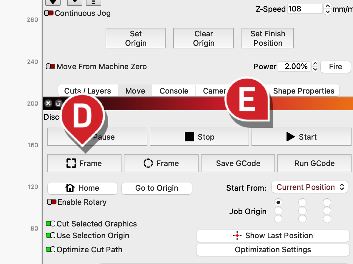

6. Select a Start From Mode and Job Origin
  1. Select Current Position as the Start From mode.
  2. Set Job Origin to a corner if you're engraving on a square coaster. If your coaster is circular, select the center.
For more information on the different Start From mode options, watch our full video guide here.

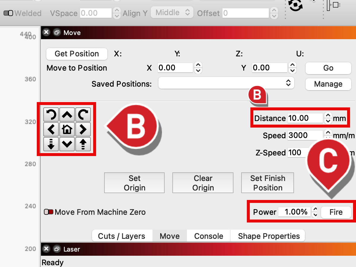

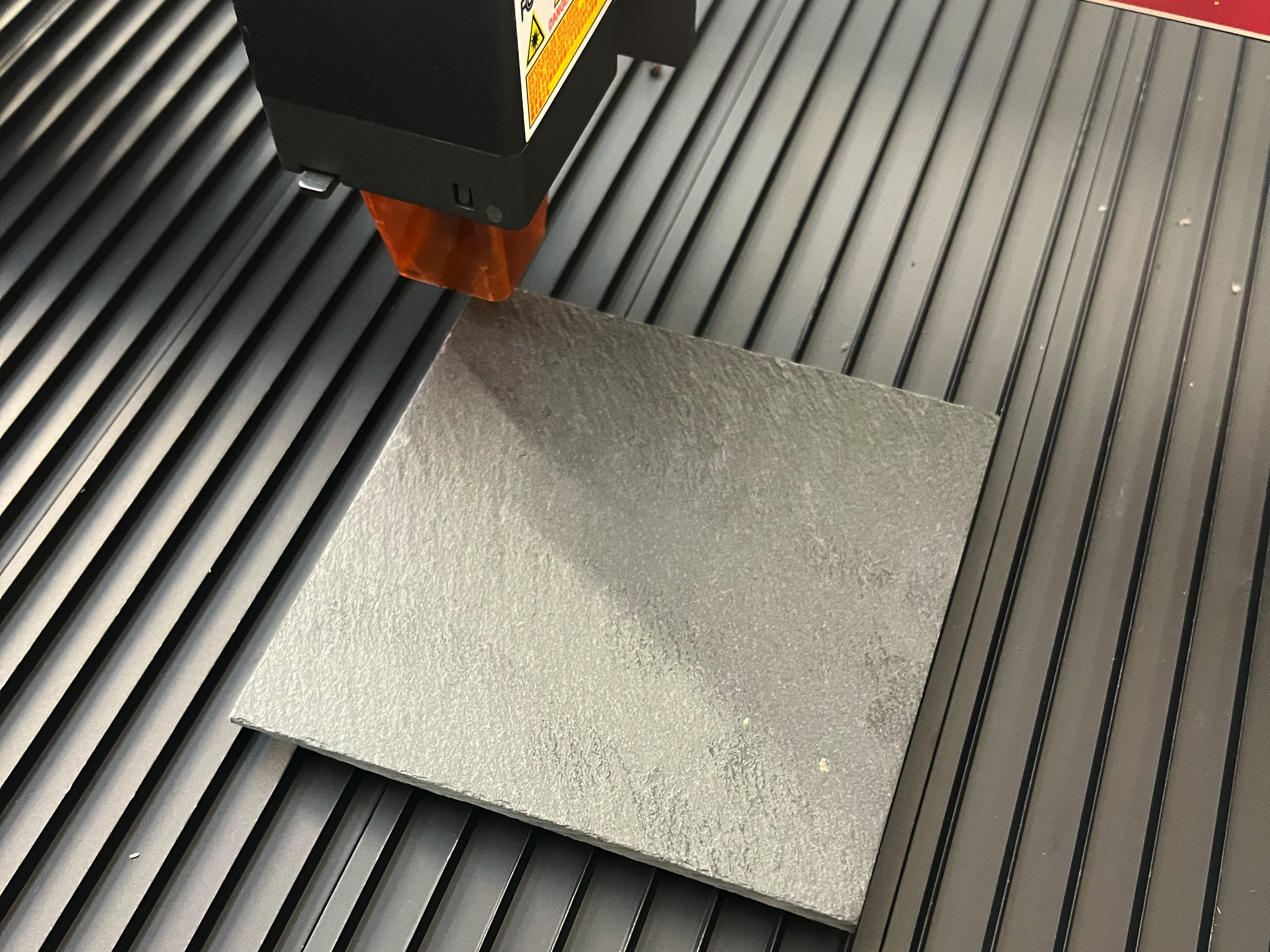

7. Position the Coaster and Run the Job
  1. Place the coaster near the center of your laser's workspace. It doesn't have to be exact, but try to provide roughly equal space from each side of the coaster to the edge of your workspace.
  2. Using the arrow keys in the Move window, Jog your laser to the same location on the coaster as you selected for the Job Origin. To refine positioning, you can lower the increment in the Distance field.
    • For our project, we selected top left for Job Origin, so we jogged the laser up and over to the top left corner of the coaster.
    • If you're using a circular coaster, you may want to pre-mark the center of the coaster with a ruler and pencil, and align to that mark. Alternatively, you can use the Center Finder tool.
  3. If your laser does not have a red dot pointer, you can enable and use the Fire button to aid in alignment. When you Fire the laser, it should pulse directly over the position on your coaster that corresponds to the Job Origin you selected. Make sure you are wearing safety glasses before ever firing the laser.
  4. Frame your project to verify alignment.
  5. Press Start to run the job!
