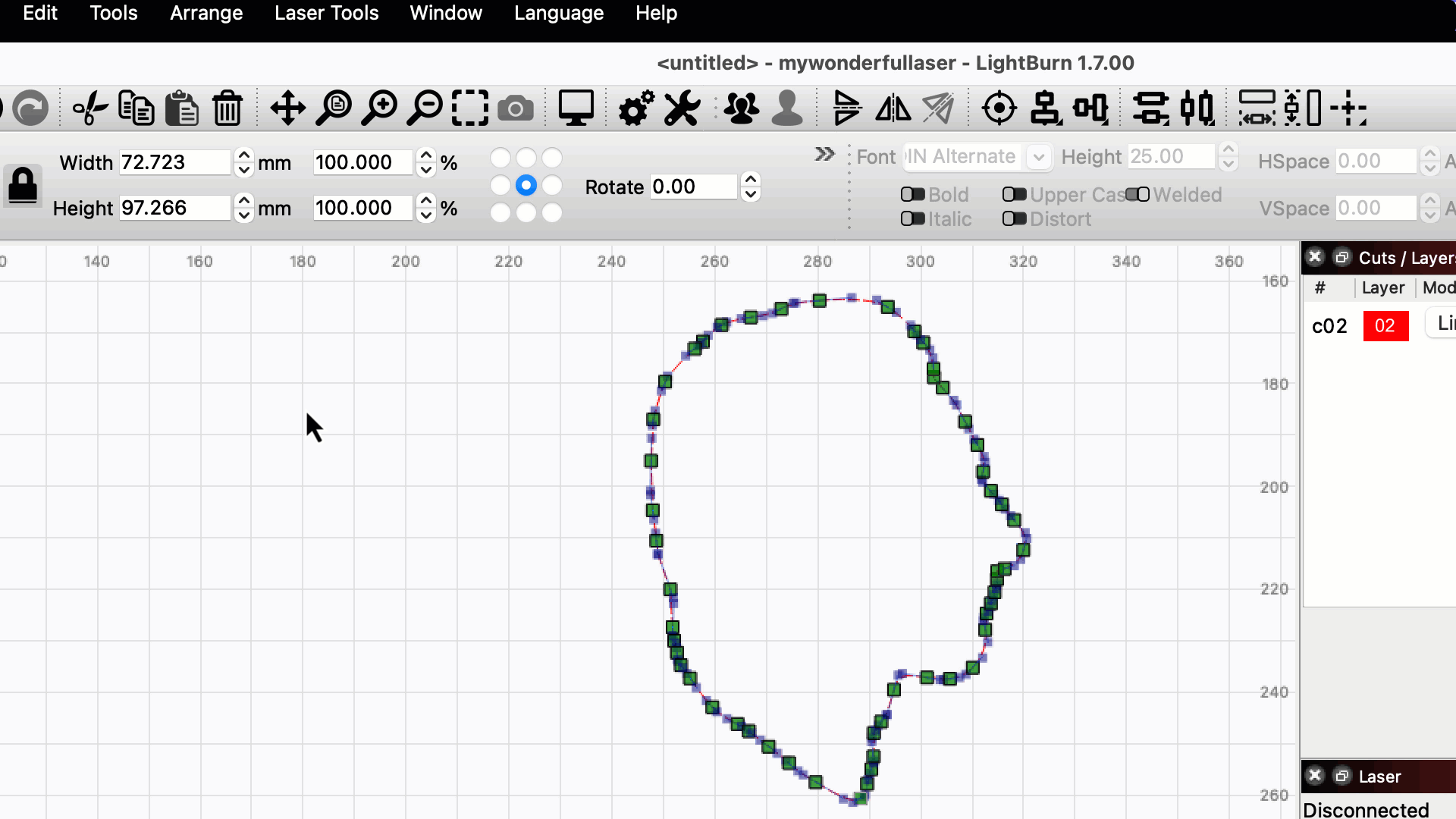

Auto-join selected shapes connects line or curve segments whose start and end nodes are directly on top of (or very near to) one another, but not technically connected. When the segments are connected, they are combined into a single path (a sequence of lines, curves, and nodes).
Auto-Join is most often helpful in cases where you've Imported graphics containing open shapes that you would like to use with a function that requires closed shapes.
To connect start and end nodes using Auto-Join, the nodes must be within .05 mm of one another.
To use Auto-Join, select all segments you want to join, then go to Edit → Auto-join selected shapes, or press Alt/Option+J.
Auto-Join demo
Troubleshooting
In some cases where Auto-Join fails to join segments with start and end points within the necessary .05 mm tolerance, it can help to first go to the Arrange Menu and select Break Apart (Alt/Option+B), before again trying Auto-Join.
