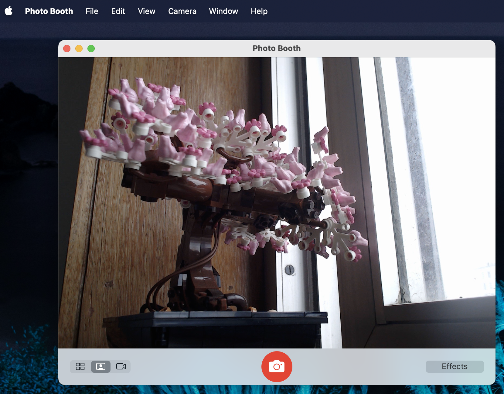

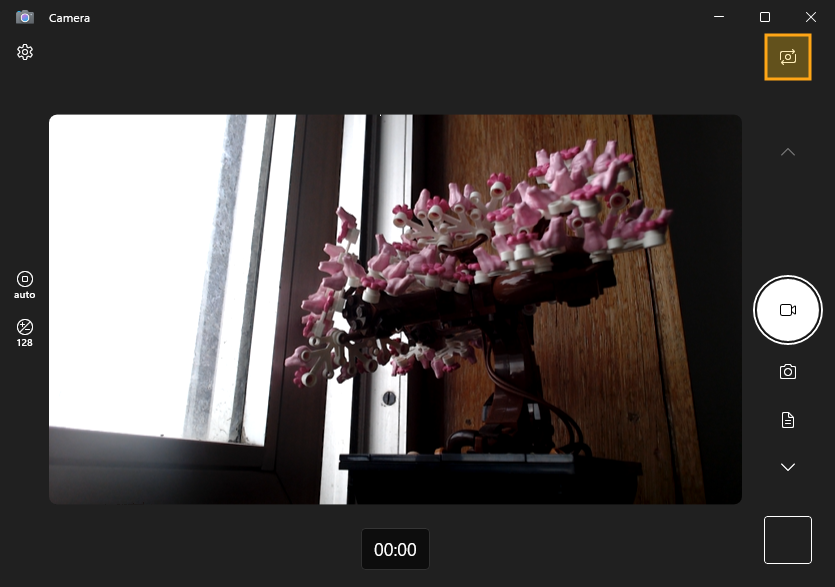

  • Make sure your computer is able to connect to the camera. If your computer can't access the camera feed, LightBurn won't be able to access it either. To do this, use your computer's built-in camera software (Camera for Windows and Photo Booth for macOS) to view the camera feed. Directions for both operating systems are below.
    I can see the camera and video feed
    If your built-in camera app sees your camera and gets a video feed, your computer can see the camera. Skip checking the USB cable and jump to making sure you've granted LightBurn permission to access your camera.
    I don't see the camera or there's no video feed
    If you can't connect to your camera and get a video feed, you'll need to get your computer communicating with the camera before worrying about LightBurn. Try checking your USB cable as described below.
    Open the Windows Camera app and select the camera you want to use in LightBurn. The highlighted button in the top right corner cycles through all of your connected cameras.
    Camera switching button highlighted in Windows Camera app
    Open the built-in Photo Booth app, and use the Camera menu to select the camera you want to use in LightBurn.
    Camera menu opened in Photo Booth app

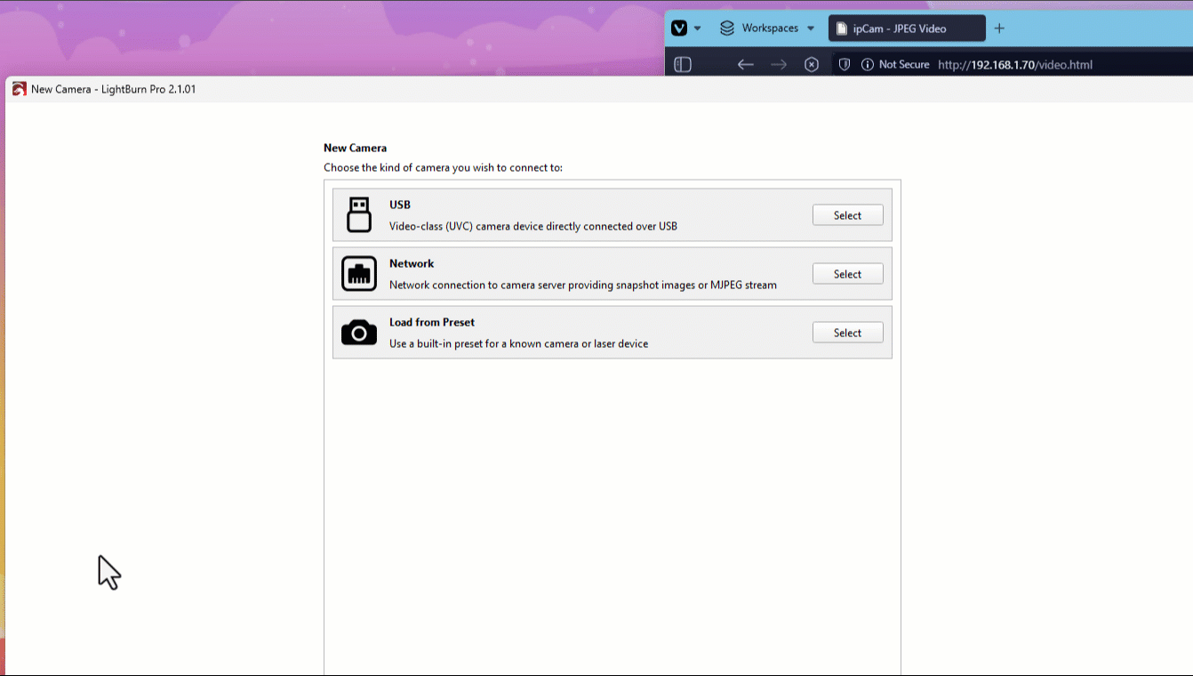

Getting the Correct Feed URL
The web URL provided by many camera manufacturers is to a page that displays the camera stream, not the camera stream itself. If you can see the camera preview in your browser but get an error saying "URL seems to be invalid. Ensure that you are connected to the same network as your device", this is often the reason.
In the GIF below, using the URL provided for my example camera (http://192.168.1.70/video.html) results in this exact error.
GIF of getting IP camera feed URL
To fix the error, try the following, as shown in the GIF:
  1. Right-click on the camera feed in the browser.
  2. In the context menu that comes up, choose Open Image, Open Image in New Tab, or Open Image in New Window. Depending on your computer's operating system and your preferred browser, these options may be named slightly differently.
  3. You should now have a page displaying a single image. Copy the URL from this page, and paste it into the Network URL bar. If this URL is valid, your camera feed should load when you click out of the box.
Why not copy the entire URL?
If you see a ? followed by a bunch of characters, it may or may not be a necessary part of the URL. This particular camera works fine with or without it.

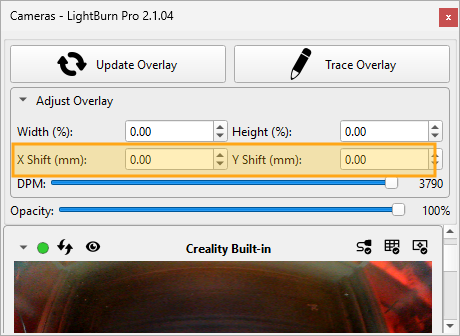

Any time your Camera Overlay is misaligned, please check the following:
  • Make sure your Start From mode is set to Absolute Coords.
  • Check the Adjust Overlay to make sure X-Shift and Y-Shift haven't gotten changed. Formost users, those values should be 0.
If these checks don't fix the problem, we have suggestions below for different situations.
Misaligned on First Setup
If your Camera Overlay is misaligned immediately after your first setup:
  • Re-run the camera alignment process, taking care to tag the target markers as precisely as possible.
  • To improve accuracy, zoom in on the target markers using the mouse scroll wheel or two-finger dragging.
  • If possible, increase the size of the target marker engraving using Pattern Width and Pattern Height. The farther apart the target markers are from one another, the more accurate the alignment will be.
  • If the alignment is close, but still a bit off, use the Width, Height, X Shift, and Y Shift fields in the Adjust Overlay section of the Cameras window to fine-tune placement and scale.

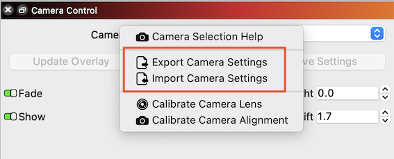

Misaligned When Switching to Thicker/Thinner Materials
Improvements in LightBurn 2.1
LightBurn 2.1 made improvements to how LightBurn's camera system handles camera alignment for different material thicknesses so you don't need to go through the export/import process described in older versions. You can read more about it here.
If you're using a version older than LightBurn 2.1, please use the older version of this page.
If you switch to a thicker or thinner material than the one you used to complete the alignment process, and your laser does not have an adjustable height bed, that will cause a misalignment — the height between camera and work area will have effectively changed.
The amount of misalignment will depend on the lens angle of the camera, the mounting angle, and how different the height is from the aligned height. If you're using a top-down view with a narrow angle lens, the difference will be much less than if your camera is wide angle, or viewing from an angle.
Fixing the Problem
Screenshot of camera alignment dropdown
