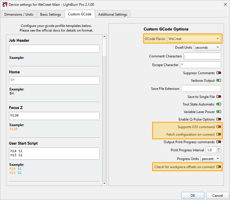

WeCreat Vision¶
The WeCreat Vision needs to be set up as a Custom GCode device, either using Create Manually or by importing a pre-configured bundle.
If you choose to add the machine manually, or already added one and aren't sure the machine is set up correctly, please make sure you use the following settings in the Custom GCode tab of Device Settings.
- GCode Flavor must be set to WeCreat.
- Supports G53 command must be disabled.
- Fetch configuration on connect must be disabled.
- Check for workpiece offsets on connect must be disabled.
