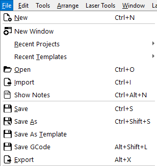

Use the file management tools to start New projects, Save projects you're working on, Open previously saved projects, and Import or Export artwork in alternative file formats.
Most file management options are available in the Main Toolbar, with a few additional options available in the File Menu.

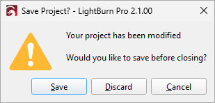

If you have an existing project open with unsaved changes, LightBurn will ask you if you'd like to Save before starting the new project, click No to discard the changes, or Cancel to abort the process.

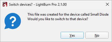

If you have multiple device profiles, and the device you were using when you Saved the file is not currently selected, LightBurn will ask if you'd like to automatically switch to that device profile.
Click Yes to switch or No to open the file with your current device.

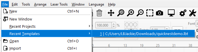

Recent Templates¶
Hover over Recent Templates in the File Menu to open a submenu containing a list of Template Files you've recently worked on and Saved.
Click any file in the list to Open it.

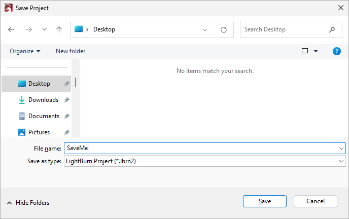

The Save and Save As commands offer the option of saving as .lbrn2 (default) or .lbrn (LightBurn Legacy Project).
Unless you need to maintain compatibility with extremely old versions of LightBurn or need an easily human-readable file, we recommend leaving the file type set to .lbrn2.
Saves your current project in .lbrn or .lbrn2 format.
If you haven't Saved it previously, a dialog window will open where you can name it and choose the location to Save it.
If you have already Saved a copy, the existing copy will be immediately overwritten with any new changes you've made.

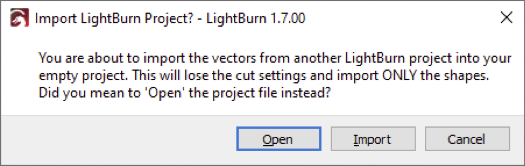

It is also possible to Import .lbrn or .lbrn2 files — however, Importing these types of files does not load the cut settings or any other project-specific information saved to the file. Only the graphics will be loaded.
In order to load graphics along with all other settings, you must use Open instead.
LightBurn will warn you if you attempt to Import a .lbrn or .lbrn2 file.
Click Open to load the graphics and all other settings, Import to load only the graphics, or Cancel to abort the process.
