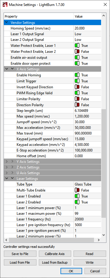

With the laser/controller connected to your computer and powered on, go to Laser Tools → Machine Settings to open the Machine Settings window. LightBurn will automatically read the settings from the controller when this window is opened.
As you're making changes, the Read button will tell LightBurn to read the configuration from the controller, and Write will save the settings in LightBurn back to the controller. For more information on the Machine Settings window, see our page on Machine Settings.
The top section of the list is referred to as user settings – these are settings that are intended to be tunable by the user if necessary. The lower section, under Vendor Settings, are things usually configured for you by the factory and should only be changed if you have a good reason for doing so.
Click to expand the Vendor Settings section, and, after acknowledging the warning, you'll see the below settings.
The first section is general configuration, and then there are settings that are specific to each axis, followed by a Laser Settings section, for configuration specific to the laser type.

To fix this, you'll need to go to the X Axis Settings and Y Axis Settings under Vendor Settings. Near the top of each will be three check boxes:
  • Invert Keypad Direction: Controls which way the arrow buttons move the laser.
  • Limiter Polarity: Tells the controller whether the limit switch triggers high (normally open) or low (normally closed) when contacted.
  • Direction Polarity: Controls which way the motor moves in general.

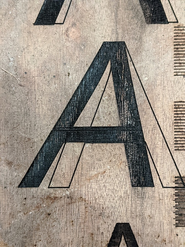

Fixing Skewed Engraving
An occasional problem with new setups, and sometimes even existing machines, is lines cutting correctly, but engravings coming out slanted or skewed, like this:
If your output looks like this, you likely have your motor pulse step polarity set incorrectly. On Ruida controllers, each axis has a setting called PWM Rising Edge Valid. This setting tells the controller whether the rising edge or falling edge of a step pulse is what the motor driver is looking for, and fixing it may correct skewed engraving.
To fix this problem, Find the PWM Rising Edge Valid setting on the X axis, and toggle the value – enable it if it's disabled, or disable if it's enabled. Do the same for the Y axis.
What is this setting and why does it matter?
A step pulse is a transition from low to high, or high to low. The controller will hold the line low, and pulse it high, or hold the line high, and pulse it low. The transition itself is what matters, and motor drivers will either look for a transition from low to high (rising edge) or high to low (falling edge) to accept as a Step.
If the laser controller believes that the motor driver is looking for the leading edge signal (when it transitions from low to high), it will pulse the line, and could change the direction line immediately after that. If the motor driver is waiting for the falling edge, it will see the direction change BEFORE the falling edge of the pulse, meaning that it will change direction one step too soon.
In the image above, the upper line of steps is interpreted as 4 steps in one direction, then two in the other. The lower line is interpreted as 3 and 3, and the only difference is which side of the step signal the driver is looking for.
