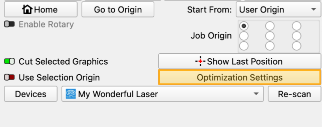

LightBurn's Cut Planner controls the order in which your laser cuts or engraves graphics in your project. The Cut Optimization Settings window is where you adjust the variables by which the Cut Planner decides on cut order and pathing.
To open the Cut Optimization Settings window, click the Optimization Settings button in the Laser Window.
Optimization Settings only take effect when the Enable Optimization and output re-ordering switch in the Optimization Settings window is toggled on. If Optimize Cut Path is toggled off, graphics are output in the order in which they were first created.
Optimization Settings controls in the Laser Window

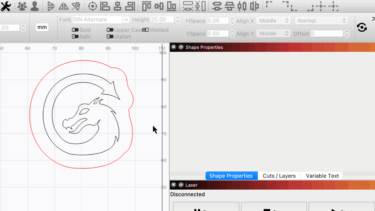

Orders cuts by Group — all objects in a given Group are cut together, then the next Group of objects, and so on. Ungrouped objects will all be treated as a single group for the purposes of this setting.
Order by Priority
Orders cuts according to individual Cut Order Priority. Priorities are ordered such that 0 is the first priority, 1 is the second, and so on. Assign Cut Order Priority in the Shape Properties Window.
Select objects and go to the Shape Properties Window to adjust their Cut Order Priority
Cuts / Layers Window order
