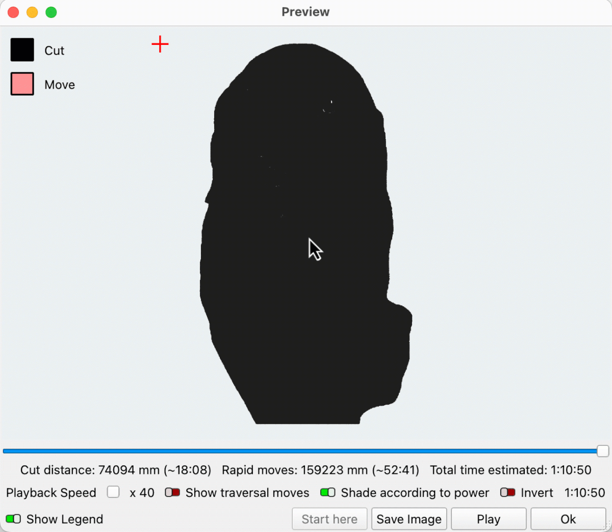

The Preview window is an accurate representation of what LightBurn will send to the laser. Black lines represent cut moves, while red lines are travel moves between cuts.
It's a good practice to check the Preview window before starting any job, to make sure the simulated output matches your expectations, or to identify any problems before it's too late.

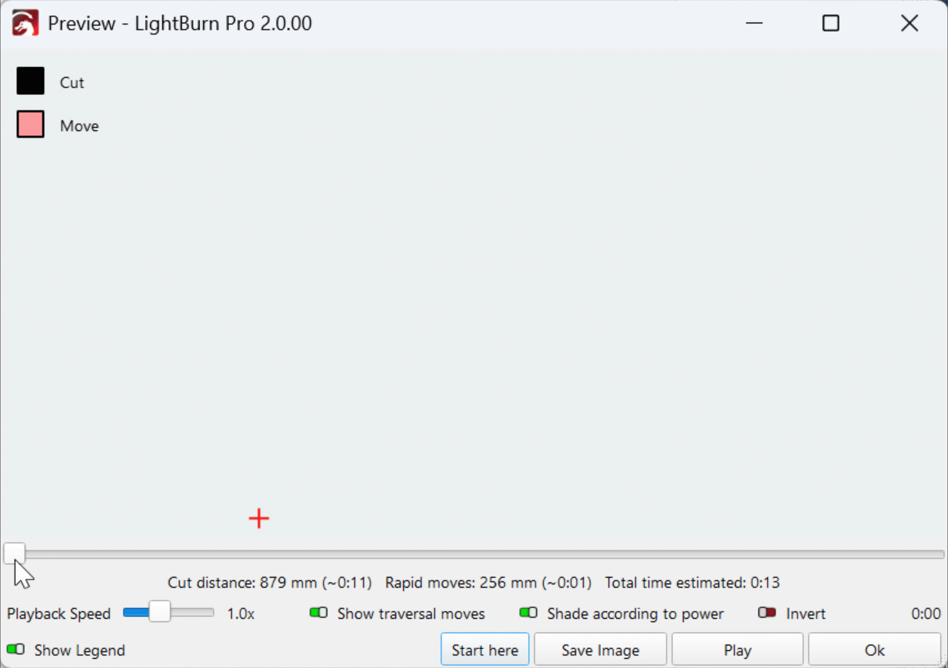

Time Slider
The Time Slider allows you to slide quickly through the project and see the cut order.

You can check the placement of your artwork relative to your laser's workspace by zooming out. The outer edge of your laser's cutting area is shown as a green border in the Preview window.
Zooming in to see detail of an image engraving
Job Time Statistics
Below the Time Slider are statistics about the job and the estimated run time. The Additional Settings tab in Device Settings can help you get more accurate time estimates – see the video above for help.
  • Cut distance shows the distance the laser will travel while on, and the estimated time it will take the laser to complete those movements in parentheses.
  • Rapid moves shows the distance the laser will travel while off, between cutting and engraving, and the estimated time it will take the laser to complete those movements in parentheses.
  • Total estimated time shows the combined time it will take the laser to complete all Cut and Rapid moves.

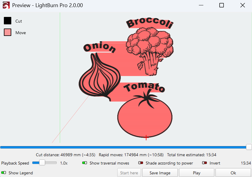

Preview Settings
The settings here only affect the Preview window – they don't change anything about LightBurn's output to the laser.
Setting Description
Playback Speed Sets the speed of playback with the Play button – ranges from 1/10 of actual speed to 40 times the actual speed.
Show Traversal Moves If enabled, shows travel moves in red. If disabled, travel moves are hidden.
Shade According to Power If enabled, uses grayscale shading to indicate higher and lower power cut moves. This only works with the Grayscale Image Mode, Power Scaling, or Ramp Length.
Invert If enabled, sets cut moves to white on a black background. Useful when engraving on dark surfaces that engrave lighter, such as slate.
Show Legend If enable, shows a legend in the top left indicating which colors represent Cuts and Moves.

Use the Start Here button to recover interrupted jobs by starting the laser at a precise time partway through the operation. Move the Time Slider to the point at which you want to start, then click Start Here.
