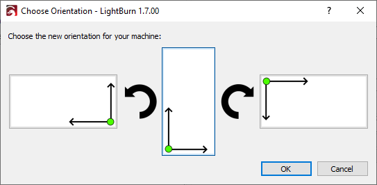

Swap X/Y Output to Laser
Enable this setting to rotate your LightBurn Workspace to match your machine's physical orientation, and swap X/Y output to your laser accordingly.
The green dot in the dialog window indicates the location of the machine's 0,0 point (the location it homes to) in the machine's physical orientation. Select the image that matches your machine's orientation, then click OK. LightBurn will automatically adjust your Origin and rotate your Workspace and output to your machine to account for the new orientation.
This option is intended for machines with Y dimensions that are longer than their X dimensions.
Choose orientation for X/Y Swap
