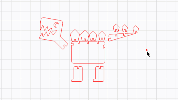

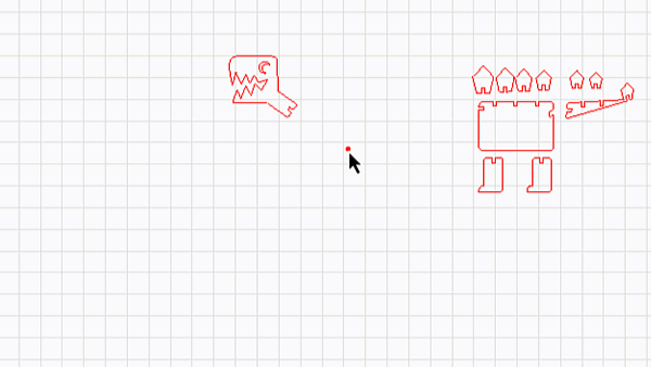

Move
The Move handle is a square located in the center of your selection area. When you hover over the Move handle, the four-arrow icon will appear.
  • Click, hold, and drag the Move handle to move the selection around your Workspace.
  • Release to place the selection in its new position.
  • Press Esc before releasing to deselect and return the selection its original position after releasing.
Move Example

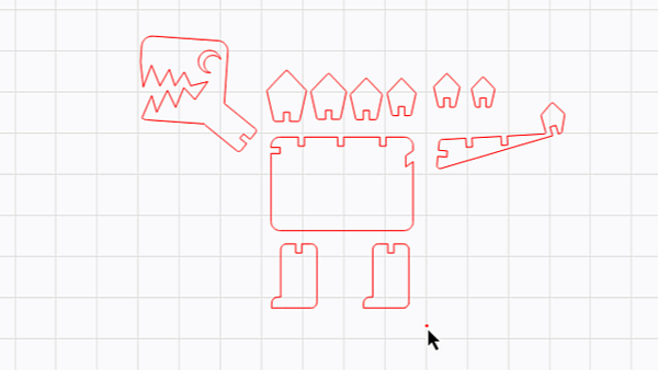

Size
The Size handles are squares located around the perimeters of your selection area — at each corner, and the midpoints of each side. When you hover over a Size handle, the two-arrow icon will appear.
  • Use the corner handles to rescale both dimensions of your selection while maintaining its aspect ratio.
  • Use the midpoint handles to rescale a single dimension at once.
  • When dragging any of the Size handles, the behavior is asymmetric — the other side of the object acts like an anchor and stays in place.
  • Click, hold, and drag a Size handle to rescale your selection. Drag outward to make it larger, or inward to make it smaller.
  • Release to set the selection to its new scale.
  • Press Esc before releasing to deselect and return the selection its original scale after releasing.

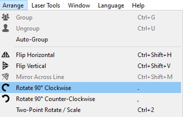

Rotate in the Arrange Menu
You can also select Rotate 90° Clockwise or Rotate 90° Counter-Clockwise from the Arrange Menu.

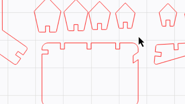

Shear
The two Shear handles are small squares located just above or below and just to the left or right of a corner of your selection.
  • The handle above or below skews your selection vertically, while the handle to the left or right skews it horizontally.
  • Click, hold, and drag a Shear handle to skew the selection.
  • Release to apply the new skew to the selection.
  • Press Esc before releasing to deselect and return the selection to its original skew.
Shear Demo

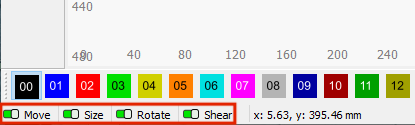

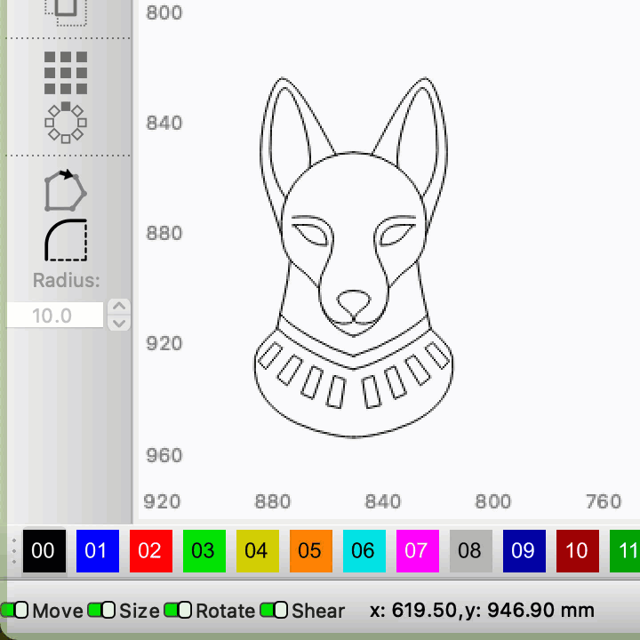

Transform Control Toggles
Use the Transform Control Toggles in the bottom left of the LightBurn window to enable and disable specific types of editing across an entire project, and prevent accidental edits, such as inadvertently scaling a design that contains strict sizing, or moving tightly nested parts.
Note
This feature is disabled when using Beginner Mode.
The Transform Control Toggles are all enabled by default. Each toggle enables or disables a different type of editing:
  • Move: shifting, repositioning, relocating, dragging, or rearranging objects.
  • Size: scaling, resizing, enlarging, or shrinking objects.
  • Rotate: spinning, turning, tilting, or adjusting the angle of objects.
  • Shear: skewing or slanting objects.
When a toggle is enabled, the corresponding Transform Controls appear around selected objects. As toggles are disabled the controls disappear, restricting that type of editing.
