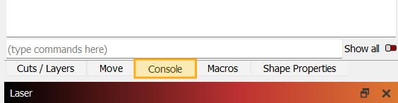

If you have a GCode-based device profile selected, the Console Window will be located in the upper right side of LightBurn, docked behind the Cuts / Layers Window, by default.
If you have closed the Console Window, go to Window → Console to re-enable it. To restore it and all other windows to their default positions, go to Window → Reset to Default Layout.

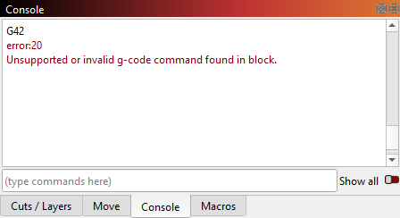

The Console Window will sometimes display alarm or error messages sent to LightBurn by the laser's controller, indicating that there was a problem with the machine's operation.
See Troubleshooting: GRBL Errors to find solutions to common alarms and errors.

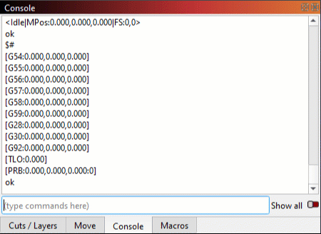

  • $I: display the controller's firmware version.
  • $$: display GRBL settings. See the official GRBL documentation for more information on each setting.
  • $#: display stored offsets in the machine's coordinate systems.
  • ?: display status and current position.
