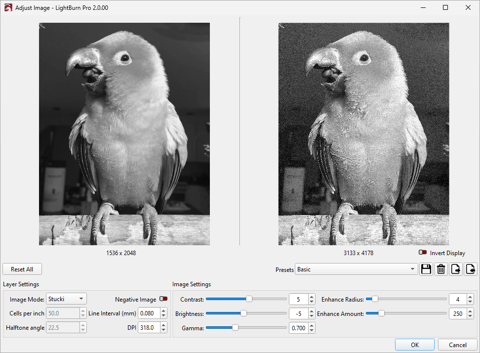

Adjust Image
The Adjust Image tool streamlines the process of tweaking Image Settings such as Contrast, Brightness, and Gamma while also changing Layer Settings, allowing you to adjust all of these properties from a single window, and see an instant preview of resulting output.
Learn More
The Adjust Image window
