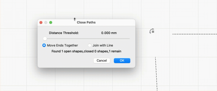

Select all paths you wish to close and go to EditClose selected paths with tolerance to open a dialog window.
Close selected paths with tolerance dialog window

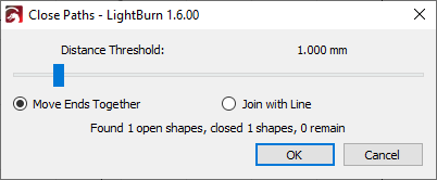

  • Use the slider to set the Distance Threshold, or tolerance, which determines the maximum distance between start and end points to be connected. Start and end points that are farther apart than this threshold will be ignored.
  • Select Move Ends Together to connect the start and end points by bringing existing lines together.
  • Select Join with Line to create a new line segment between start and end points.
  • The readout at the bottom of the window shows how many open shapes were found, how many shapes have been closed, and how many open shapes remain in your selection.
  • Click OK to confirm the changes and close the selected shapes, or Cancel to discard them and leave the shapes open.
