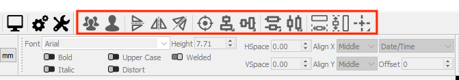

The Arrange Toolbars each contain a selection of tools found in the Arrange Menu, that are broadly used for positioning objects.
The toolbars come in a long version, for high-resolution screens, and a shorter one, with sub-menus to fit on smaller screens.
Sub Menu
Accessing the Arrange Toolbars
The Arrange Toolbar is located near the center of the top toolbar in LightBurn by default, to the right of the Main Toolbar.
Arrange Top Toolbar
If you have closed the Arrange Toolbar, go to Window → Arrange to re-enable it.
To restore it and all other toolbars and windows to their default positions, go to Window → Reset to Default Layout.
To enable the Arrange (long) Toolbar, go to Window → Arrange (long).

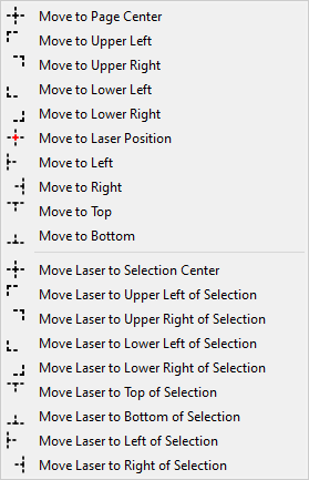

Move Selected Objects
Moves objects to a corner, midpoint, or center of your Workspace. If you have a Gantry style laser, it can also move selected objects to the last reported position of your laser head.
See Move Selected Objects for more information.
Move Selected Objects / Move Laser to Selection Dropdown
This button opens a dropdown menu containing all the Move Selected Objects and Move Laser to Selection options.
Move Selected Objects and Move Laser to Selection dropdown menu
