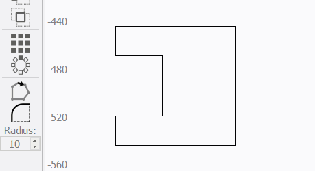

To add a radius, first click the Radius Tool icon in the Modifiers Toolbar.
Radius in Toolbar
Set the radius value to the size of the radius you wish to create — there must be enough room between the corner and nearby points to accomodate this value.

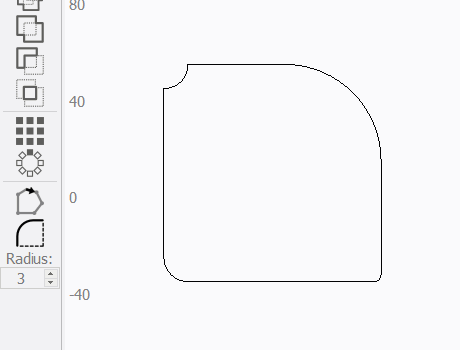

If you change the radius to a negative number it takes a fancy little bite out of the corner.
Select the object you want to modify, and click on a corner to apply the radius.
To exit the Radius Tool, press Esc on your keyboard.
Add radius

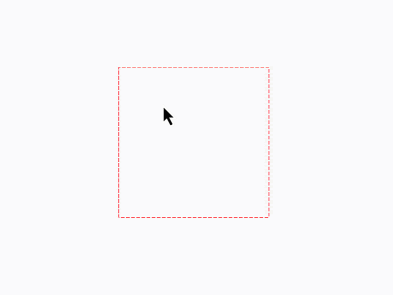

Rectangles also have a handle that acts as a shortcut for the Radius value. With a Rectangle selected, hold Ctrl / Cmd, and a blue corner radius control will appear. Drag the blue handle away from the corner to increase the radius of all four corners, and drag back toward the corner to decrease it. Dragging vertically creates a reversed radius, with a bite taken out of the corner.
add radius to rectangle
