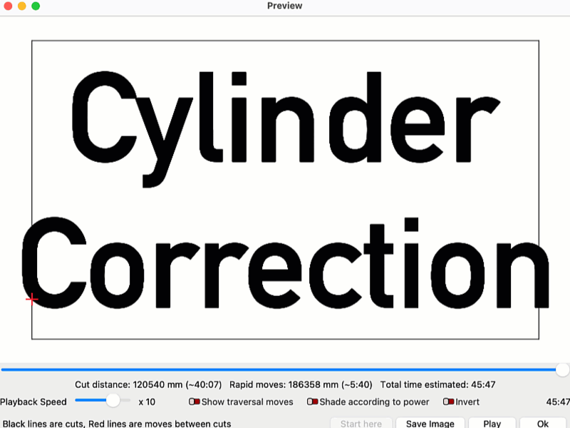

Cylinder Correction
Available for Galvo lasers only, Cylinder Correction is a special mode that warps the output of your design to correct for distortion caused by engraving cylindrical objects, without using a rotary. EZCAD users may be familiar with this tool by the name ProjectMark.
Open the Cylinder Correction Setup window by going to Laser ToolsCylinder Correction Setup, or clicking the Cylinder Correction button in the Modes Toolbar.
Learn More
