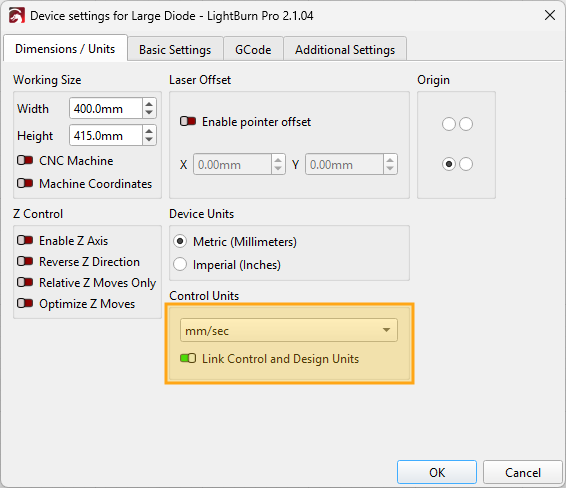

Cut Settings are Different
Sometimes, we hear from users that their cut settings changed. What's more likely is that your cut settings have stayed the same, but the units they're displayed in have changed.
If this happens to you, check your Control Units and make sure they're set to what you've been using.
Why It Happens
The Speed you cut at can display differently if your Control Units accidentally get changed. This happened to some users who used different units for designing and controlling when they installed LightBurn 2.1. If your Control Units change, your cut settings will be displayed in the new units.
As an example, let's say you usually cut plywood at 50 mm/sec. If your Control Units change, this could now display as 1.97 in/sec, or even .032 in/min, but the actual speed hasn't changed. This is easy to miss if you don't change your units often, beause it's easy to get used to thinking of speed as just a number.
