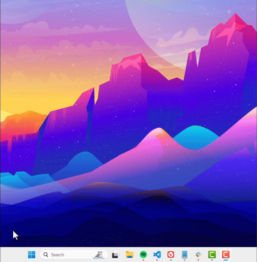

  1. Find the app shortcut: Open the Start menu and start typing "LightBurn". You should see the LightBurn icon come up. Don't click on it just yet.
  2. Open the app location in Windows Explorer: Right-click on the LightBurn entry and select Open File Location from the menu that comes up.
  3. Open the properties window: Right-click on LightBurn in the new window that opened and select Properties.
  4. Edit the target location: Find the line labeled Target: and add -d at the end, outside the quotation marks around "C:\Program Files\LightBurn\LightBurn.exe".
  5. Open LightBurn: Open LightBurn however you usually would.
After getting the Debug Log to send to support, make sure you disable logging by removing the -d you added.
