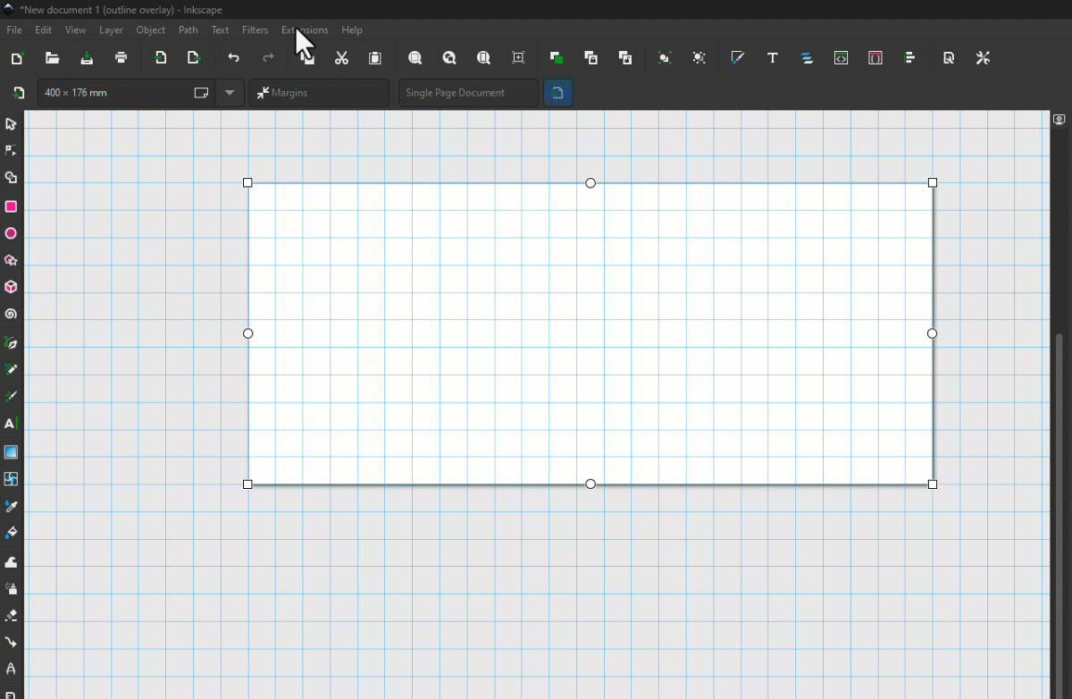

The first time you allow a new extension to connect to LightBurn using the API, you will need to approve that access in a pop-up window. You will have 30 seconds to authorize the access or it will be automatically rejected. If you're connecting over your network from a separate computer, the authorization has to be granted from the computer LightBurn is running on.
GIF showing the authorization process from the sample Inkscape extension

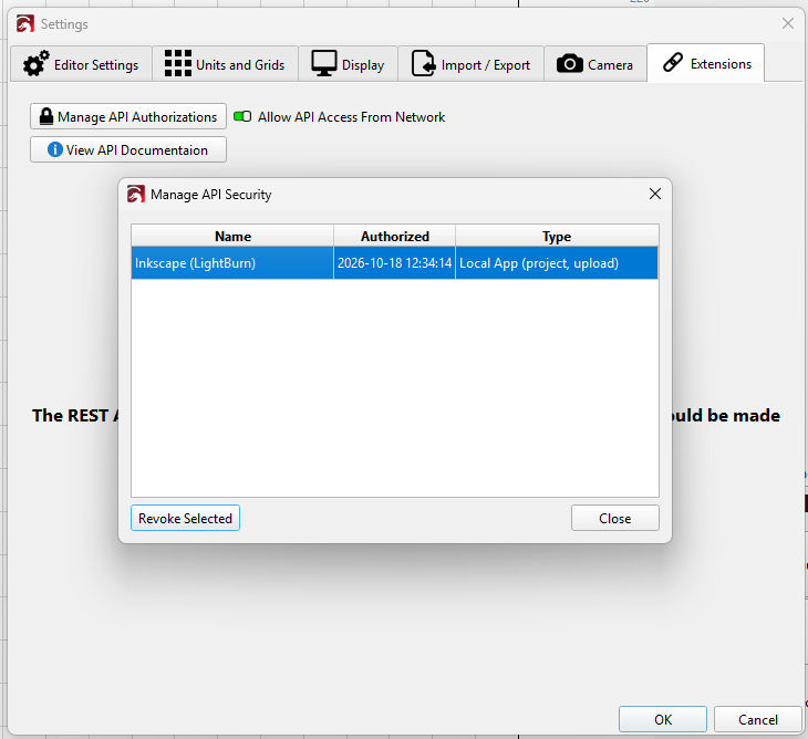

You can use the Manage API Authorizations button in Settings / Preferences → Extensions to open the Manage API Authorizations window to view and, if needed, remove API authorizations.
Screenshot of the Extensions tab of the Settings / Preferences Window showing the Manage API Security Dialog
Each API authorization currently registered in LightBurn on your computer will be listed, showing:
  • Name
  • Date and time of authorization
  • Type of API access
If an authorization is no longer needed or is causing problems, select it in the Manage API Authorizations window and click Revoke Selected to remove it.

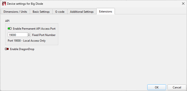

While the default for the REST API is for the most recently opened window to be the one listening, you can set and enable device-specific listening ports. This isn't necessary for most users, but it allows further control over which window is listening for API requests if needed. A device-specific listening port will listen from the first LightBurn instance that opens that specific device profile.
You might, for instance, want to set a device-specific listening port so that you can open LightBurn and connect to an external tool using the REST API, then continue to connect from that same window while working on a design in a different window.
To set a device-specific listening port, open the Extensions tab of the Device Settings window.
Screenshot of the Device Settings window with the REST API enabled
To enable device-specific listening ports in LightBurn:
  • Open the Device Settings window.
  • Enable the toggle switch for Enable Permanent API Access Port.
  • Change the per device port number if needed.
  • If you want to allow API access to LightBurn from other computers on the same network, go to Settings/Preferences and switch to the Extensions tab. Enable the Allow API Access From Network toggle.
