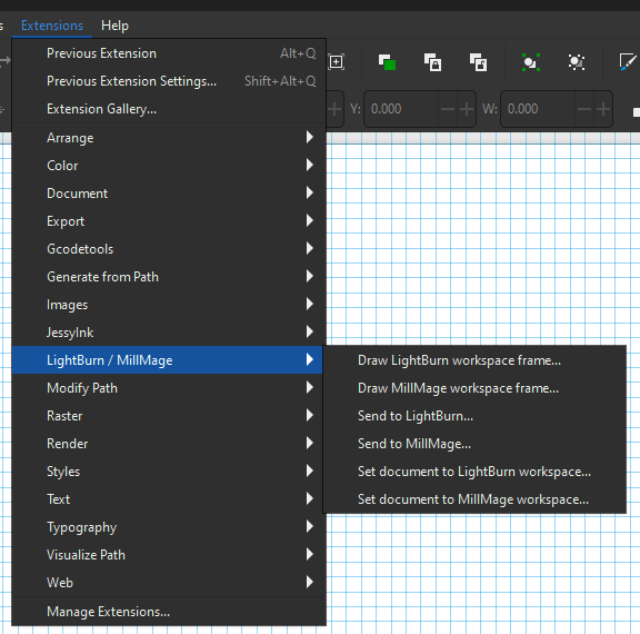

Our Inkscape sample extension talks to LightBurn / MillMage over the REST API to draw the machine workspace as a guide and send your drawing into it — de-duplicating coincident edges so shared cut lines aren't cut twice.
After installation, six new commands appear under Extensions → LightBurn / MillMage:
Screenshot of the Inkscape LightBurn/MillMage Extension commands in Inkscape

The commands appear under Extensions → LightBurn / MillMage.
Using the Extension
  1. Make sure LightBurn / MillMage is open (the API listens whenever the app is running).
  2. In Inkscape: Extensions → LightBurn / MillMage → Send to LightBurn (or Send to MillMage).
