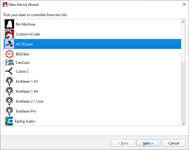

  5. In the New Device Wizard, scroll down and select ACCELaser from the list of device types. Click Next to continue.
    Screenshot showing the device type page of LightBurn's New Device Wizard

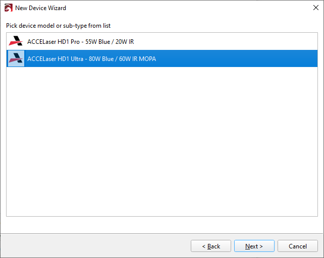

  6. Select your HD1 model from the list and click Next to continue.
    Screenshot showing the connection type page of LightBurn's New Device Wizard

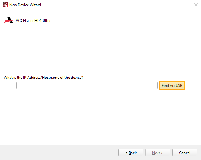

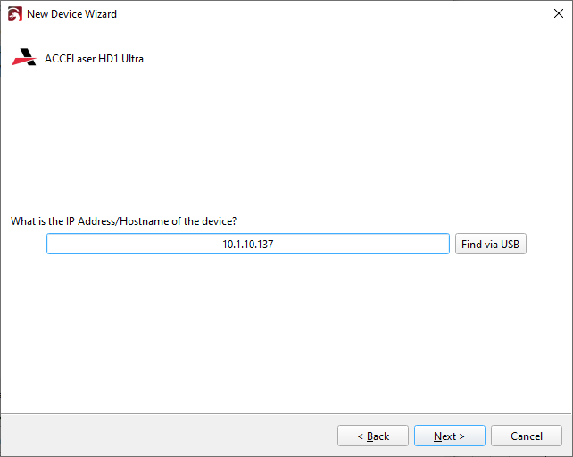

  7. Click Find via USB to automatically detect your machine's IP address and enter it in the field.
    Alternatively, you can find identify your device's IP address using the ACCELaser Handy app, and enter it manually.
    Click Next when done.
    Screenshot showing the IP address page of LightBurn's New Device Wizard Screenshot showing the IP address page of LightBurn's New Device Wizard

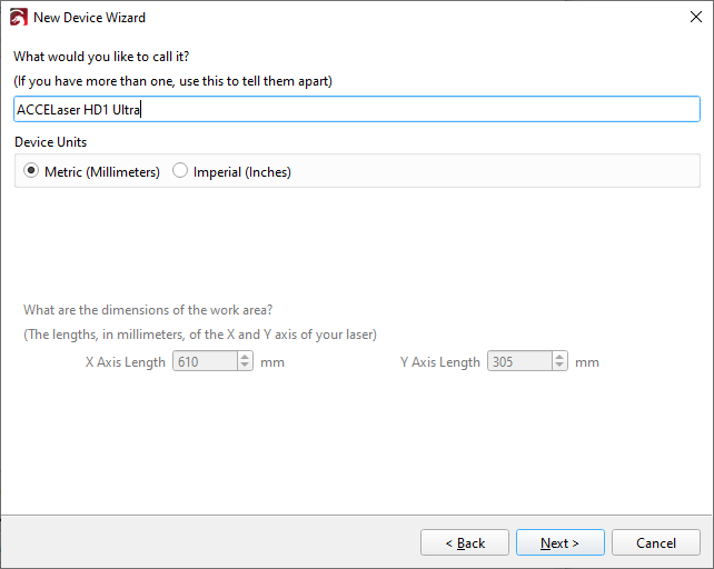

  8. Your device's working dimensions are entered automtically. You can choose to rename your device from the default model name, and set your Device Units to either Metric or Imperial. You can adjust units at any time later in the Device Settings window.
    Screenshot showing where to set the device name and size in LightBurn's New Device Wizard

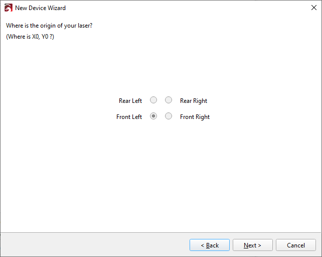

  9. The device origin is automatically set to the front left. Click Next to continue.
    Screenshot showing where to set the device origin in LightBurn's New Device Wizard

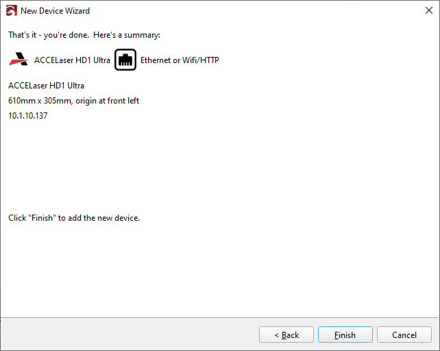

  10. Make sure the summary on the final screen seems correct — since most parameters were entered automtically, you'll only need to verify the IP address if you entered it manually. Click Back to go back and make changes, or Finish to save your changes.
    Screenshot showing the device summary in LightBurn's New Device Wizard

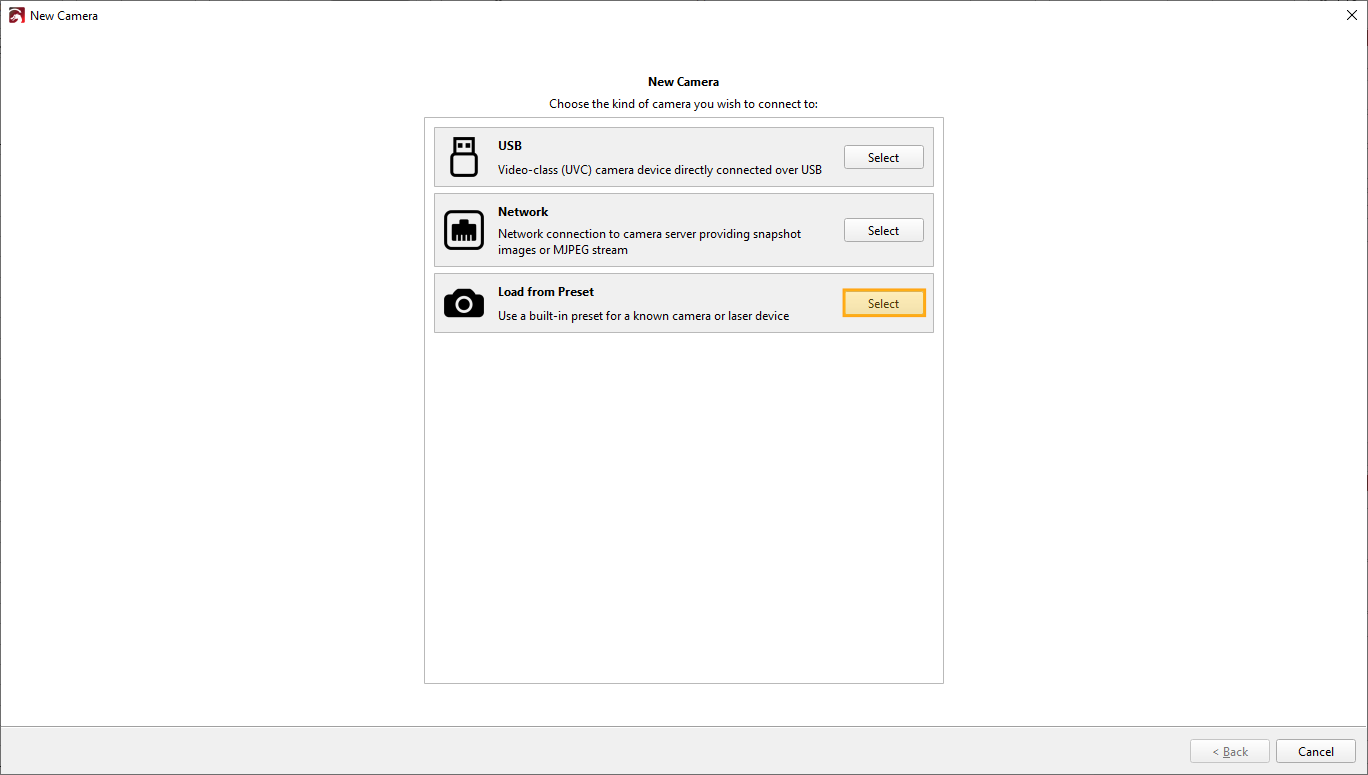

Adding the Cameras

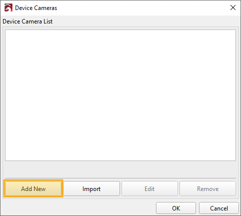

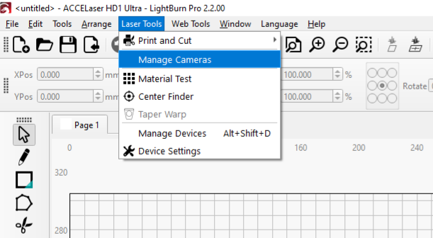

  1. Go to Laser Tools → Manage Cameras. Manage Cameras option in the Laser Tools menu
  2. Click Add New.
    Add New camera in the Manage Cameras window

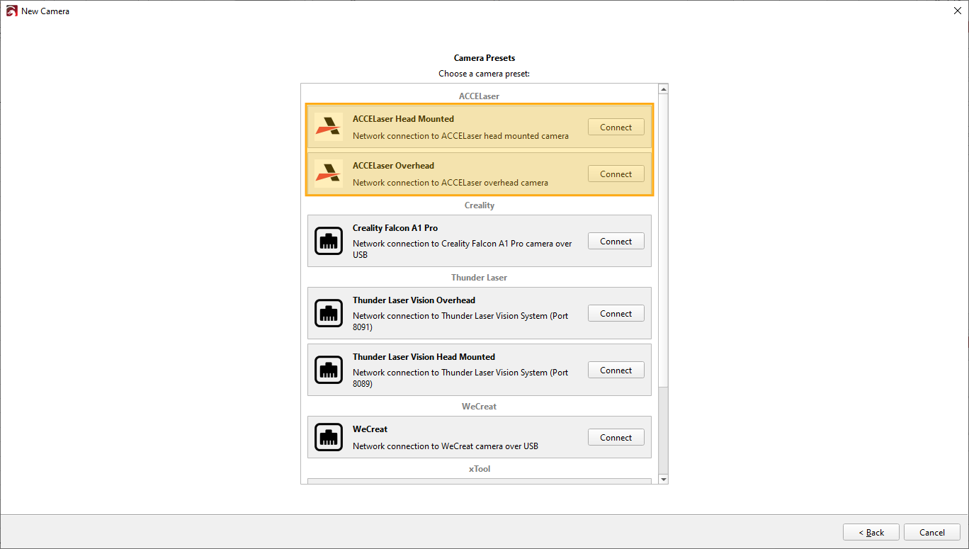

  3. Choose Load from Preset. Selecting Load from Preset from the Add Camera dialog
  4. Select ACCELaser Head Mounted or ACCELaser Overhead. Selecting ACCELaser head mounted from the preset list
  5. Repeat steps 1-3 process, then select the preset for the second camera.

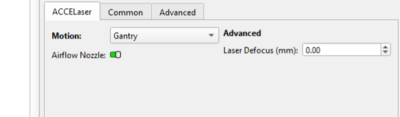

Gantry
ACCELaser Gantry Settings
Use the Gantry option when you need to cut through materials at relatively slow speeds using Air Assist.
The gantry system's maximum speed is limited to 400 mm/second.
Click an option in the image below to learn more about specific Gantry options.
Airflow Nozzle
Enables use of the Airflow Nozzle — this is a nozzle specially designed for better cutting airflow. You must also enable Air Assist in standard settings to use this nozzle.
Over Line
Entering an Over Line value extends travel distance past the ends of scan lines. This function works similarly to Overscanning for standard gantry lasers. Learn more about Overscanning here.
This option is only available if your layer is set to Fill Mode — utilizing the gantry motion system only is an uncommon use case. In general, you should select Hybrid Motion or Galvo for Fill operations instead.
Laser Defocus
Adjusts the focal height of this layer by the amount entered in the field. Negative values move the focal point lower, into the material, while positive values move it higher, above the surface.
When cutting thicker materials, use a negative value to adjust focus into the material.

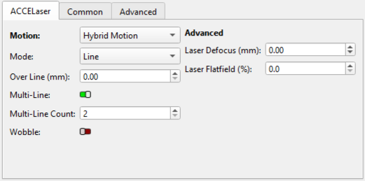

ACCELaser Hybrid Motion Line Settings
Speed is limited to 400 mm/sec, but you can increase effective speed by enabling Multi-Line.
For the best quality and stability in most Fill and Image jobs, use Line mode with Multi-Line disabled.
Multi-Line
Enable Multi-Line to have the laser process multiple scan lines at one time. This effectively increases the speed of the job by a multiple of the Multi-Line Count.
Multi-Line Count
This field controls the number of lines the laser will process at one time. 2 or 3 are common values that will increase speed significantly, though higher values may reduce quality on some materials. We recommend a maximum value of 3.
Multi Line effective speed limit is equal to 400 mm/sec (maximum gantry speed) times the number lines.

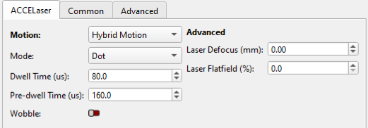

ACCELaser Hybrid Motion Dot Settings
Dot mode fires the laser at individual points instead of along continuous lines. It offers the highest precision of any mode, and is ideal for fine detail image engraving on materials like black acrylic or painted aluminum.
The Speed setting has no effect in Dot mode. Instead, two dwell settings determine speed.
Dwell Time
How long the laser fires at each point, in microseconds. Start with a value of at least 40 µs. Higher Dwell Times lead to the laser outputting more power at each point it fires.
Pre-dwell Time
How long the laser waits at each point before firing, in microseconds. Start with a value of at least 160 µs. Longer Pre-dwell Times give the galvo mirrors more time to settle before firing, and can increase job quality.

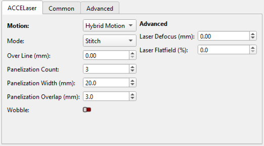

ACCELaser Hybrid Motion Stitch Settings
Your engraving is divided into multiple panels, each small enough to fit within the 40 x 40 mm galvo field. The galvo engraves each panel at full speed, then the gantry moves to the next panel.
Stitch is the fastest Fill mode, with speeds up to 4000 mm/sec, but small misalignments between panels can leave visible seams. It works best on materials where seams are hard to see, like cork and stone. On wood, seams are usually visible, so use Multi-Line instead.
Panelization Count
The number of overlapping passes used to blend panel edges. Values of 1–3 help compensate for stitching errors.
Panelization Width
The width of each panel. This must be less than 40 mm to fit within the galvo field.
Panelization Overlap
How much adjacent panels overlap. A value of around 3 mm helps compensate for stitching errors.
