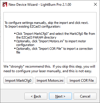

EZCad3
  • For EZCAD3 devices, the configuration files are typically called markcfg0, Motors.ini, and COR.
  • You can usually find MarkCfg0 by going to the EZCad3 application directory/folder, opening the PARAM folder, and selecting the MarkCfg0 file.
  • If Motors.ini exists, it's generally in the same location as MarkCfg0.
  • If your laser came with a COR file, it's usually in a separate folder called COR File.
See the window in LightBurn for additional details on where to look for the file.

Import EZCad3 configuration files
Importing EZCAD3 config files
Select your configuration file – typically found on the USB drive you received from the manufacturer – and click Next. LightBurn will show you a preview of the settings to be imported.
If you don't have a configuration file(s), click Next without selecting a file and you'll be able to enter settings manually. If your laser's manufacturer didn't provide the necessary settings, please contact them for assistance.

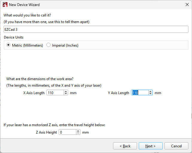

After entering the size of the work area, setting the name of the laser, and setting the travel distance of your laser's Z axis (if it's motorized), you're ready to connect to your laser.
Screenshot of the screen for seting name, field size, and travel distane of an EZCad3 laser
