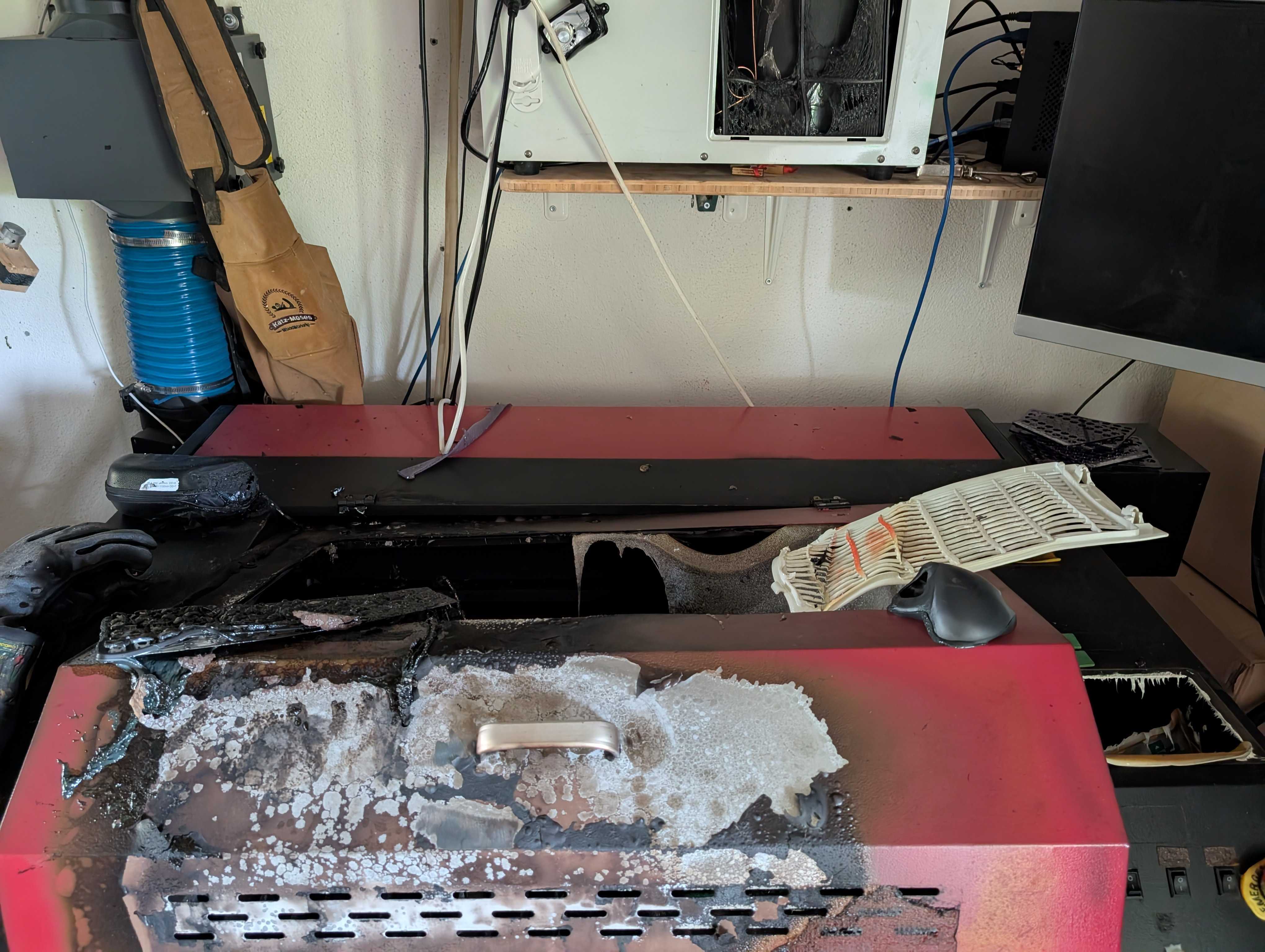

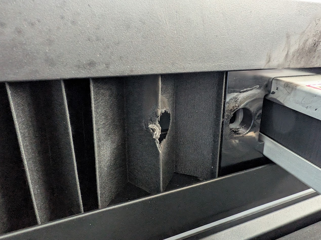

These two pictures are from two different incidents. In the first photo, close supervision of the laser and the quick reaction of the LightBurn staff member who was running it prevented a fire and further damage. In the second, proper preparations as well as quick reactions once the fire was noticed prevented a fire from becoming a tragedy.
A covering inside this laser got in the way of the laser beam, but the damage was spotted immediately and the laser was stopped before anything worse could happen.
A minor flare-up happened while the laser was unsupervised. Within a few minutes, this was the result.

The burnt laser above belongs to one of our staff here at LightBurn. He had a camera set up to watch the laser while it ran a job. He's typically very cautious, but relaxed a bit this time and let it run in the background. It only took a few minutes to go from the first hints of sustained flame to what you'll see in these pictures he's shared.
This GIF is sped up, but shows the material catching fire, which then spreads through the machine and into the crumb tray below the bed. In reality, this was about 4 minutes. At the start, when there were just a few small flames, this would have been easy to put out.
This laser had a metal frame, which helped contain the fire and protect the surroundings. For an open-frame or primarily plastic laser, the fire likely would have gotten out of control faster, with more damage. By the time our staff member got to the laser to put it out, the workshop was full of smoke. Fortunately, he was well-prepared with an easily accessible fire extinguisher, and was able to put out the fire before it spread further. Even so, the heat from the fire destroyed the chiller on the shelf above the laser in addition to the laser itself.

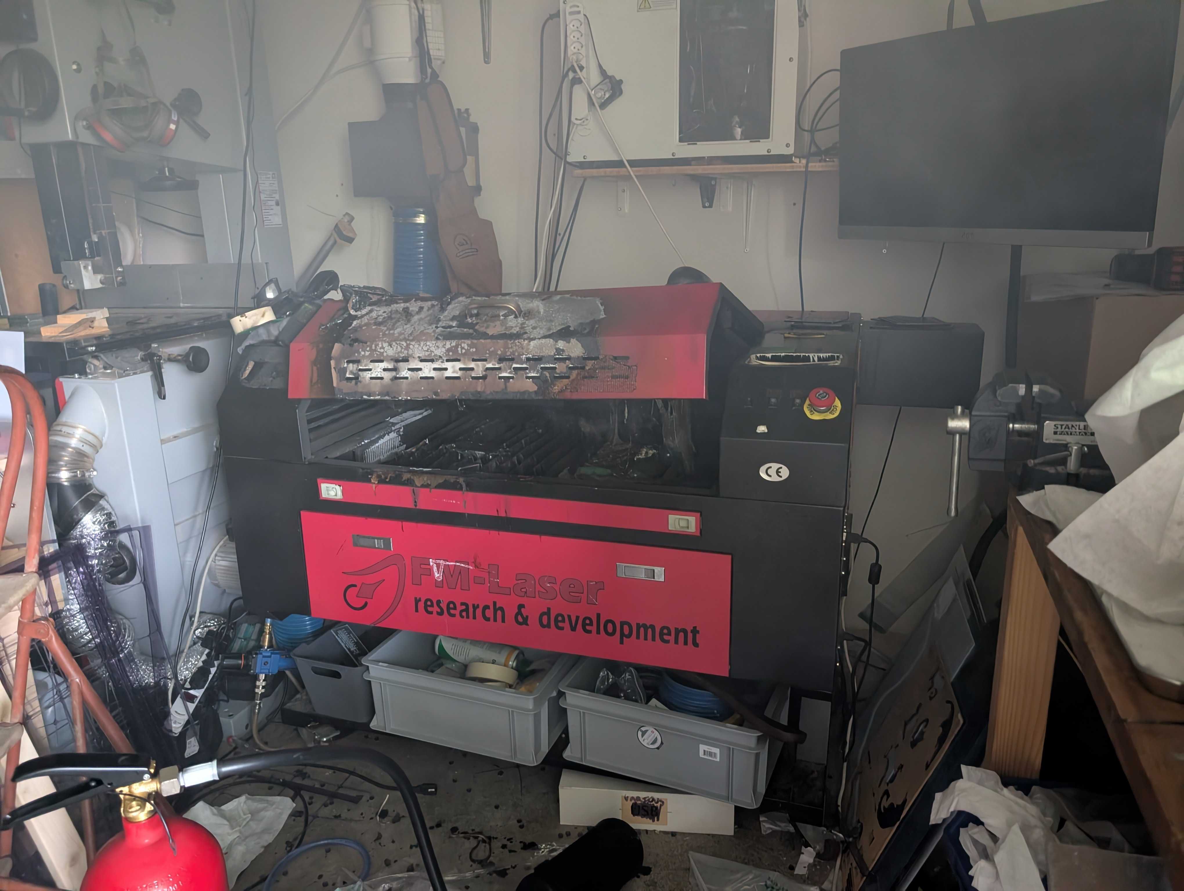

After the fire was extinguished.

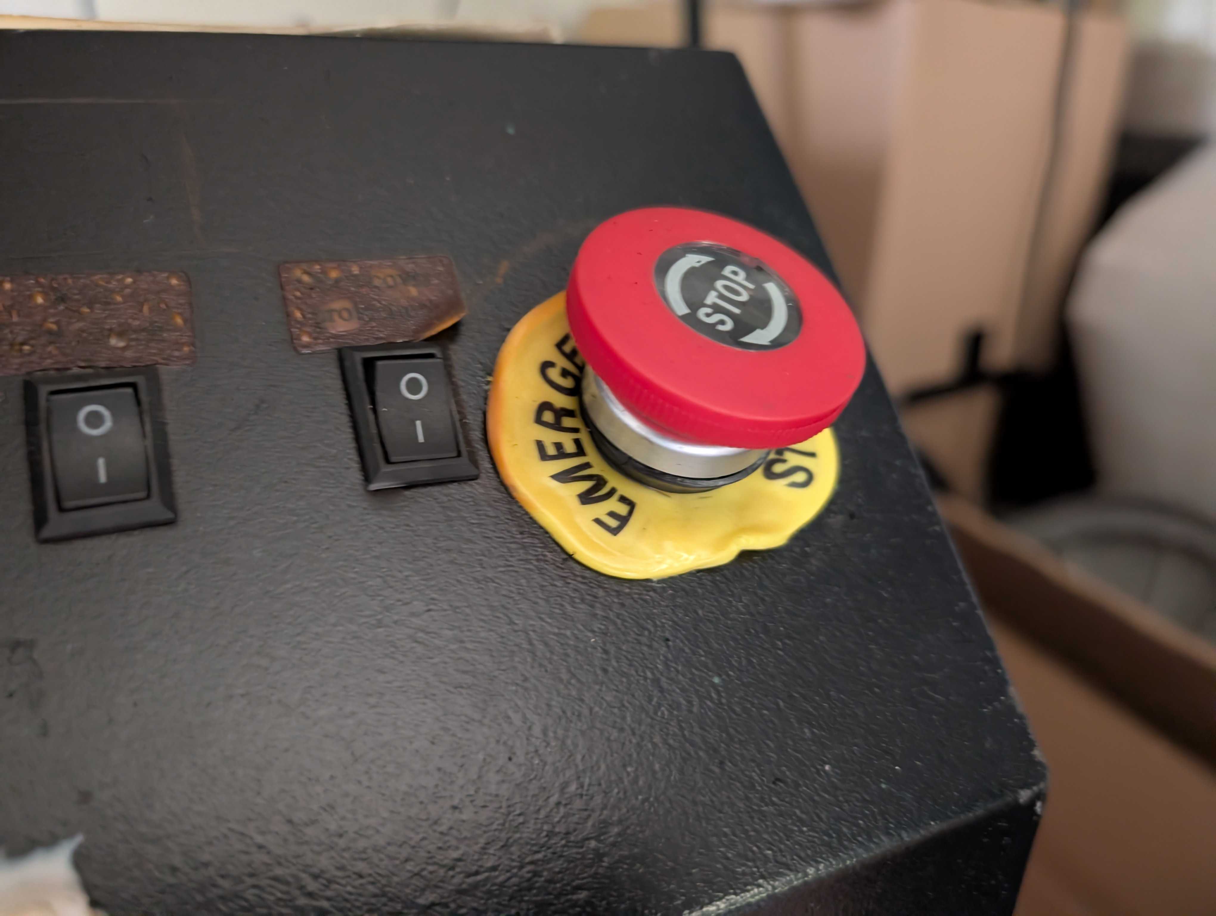

An emergency stop button like this is an important safety feature for being able to cut power to the laser immediately in an emergency situation.

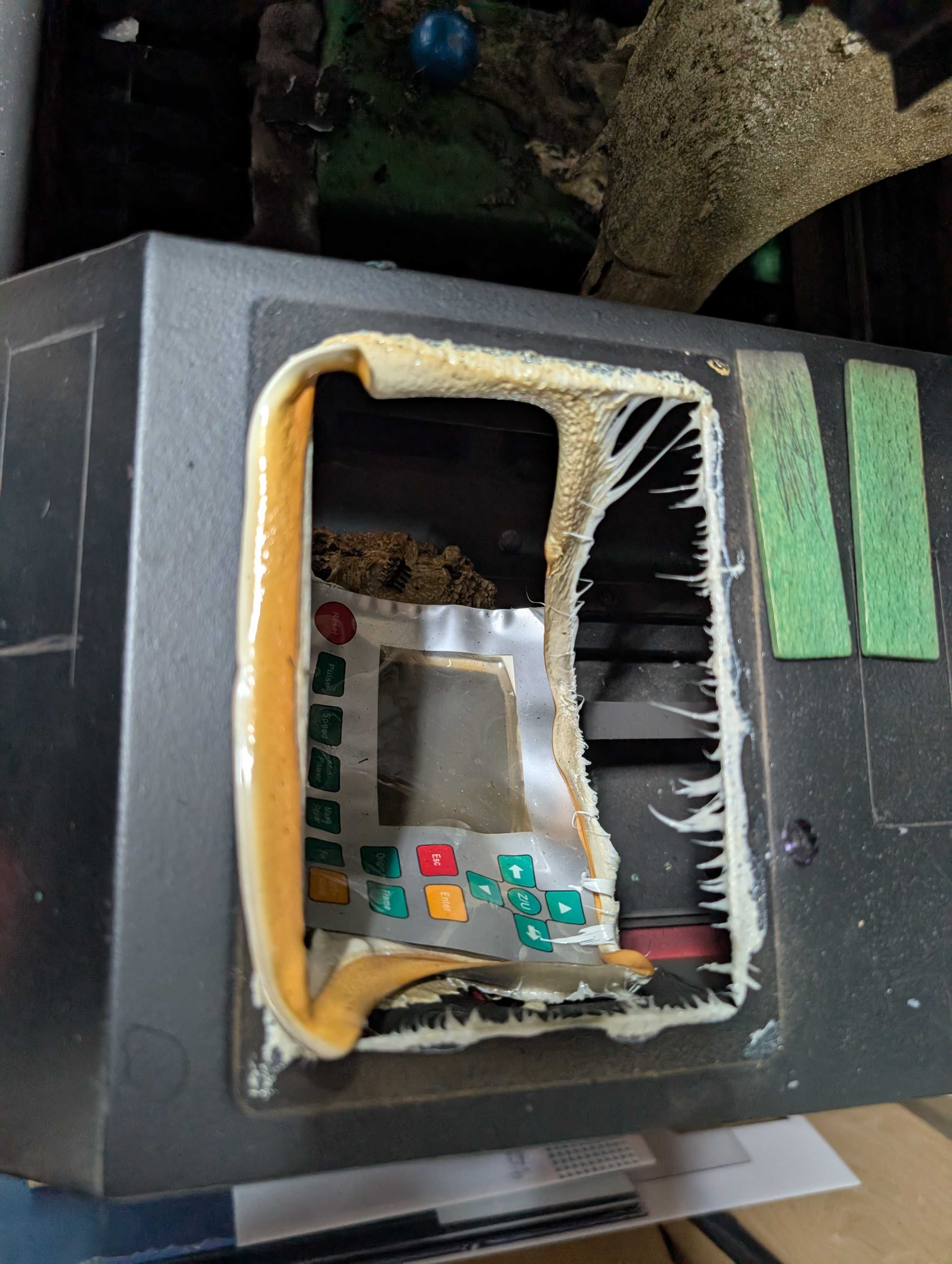

The panel holding the machine's Ruida control panel melted and dropped down into the body of the laser cutter.

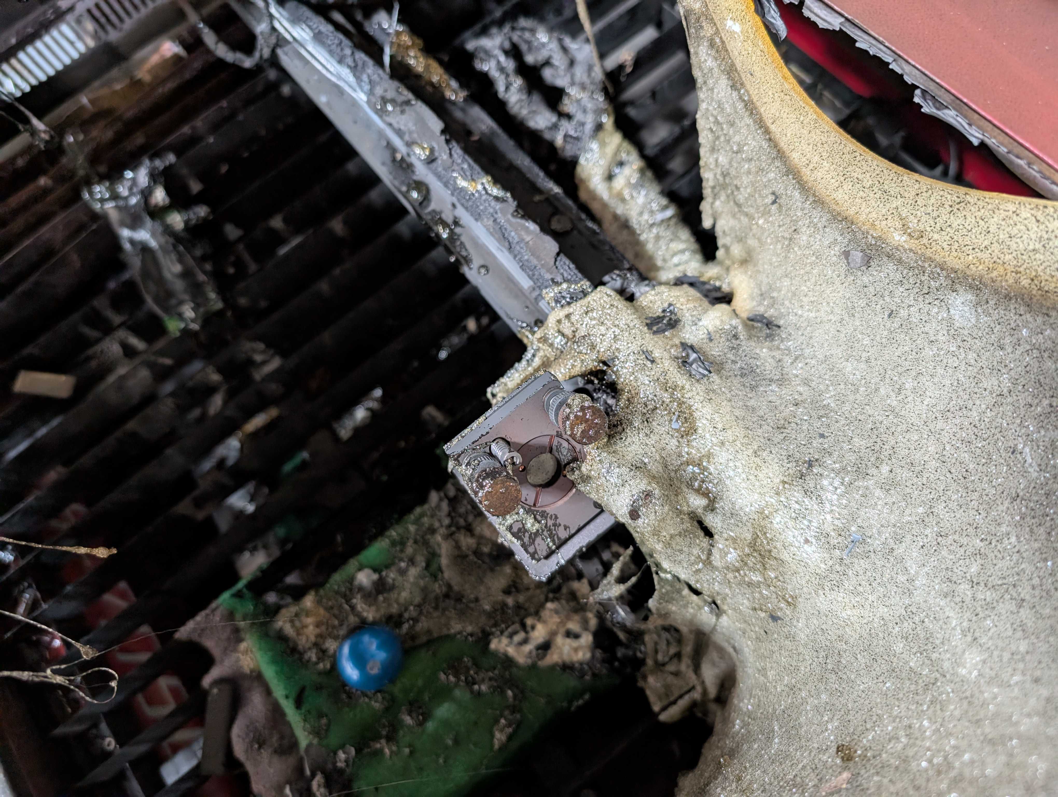

More damage inside the laser.
