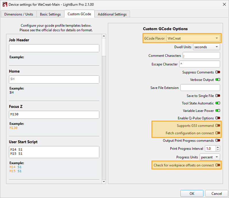

The WeCreat Vision needs to be set up as a Custom GCode device, either using Create Manually or by importing a pre-configured bundle.
If you choose to add the machine manually, or already added one and aren't sure the machine is set up correctly, please make sure you use the following settings in the Custom GCode tab of Device Settings.
  • GCode Flavor must be set to WeCreat.
  • Supports G53 command must be disabled.
  • Fetch configuration on connect must be disabled.
  • Check for workpiece offsets on connect must be disabled.
Screenshot of WeCreat settings

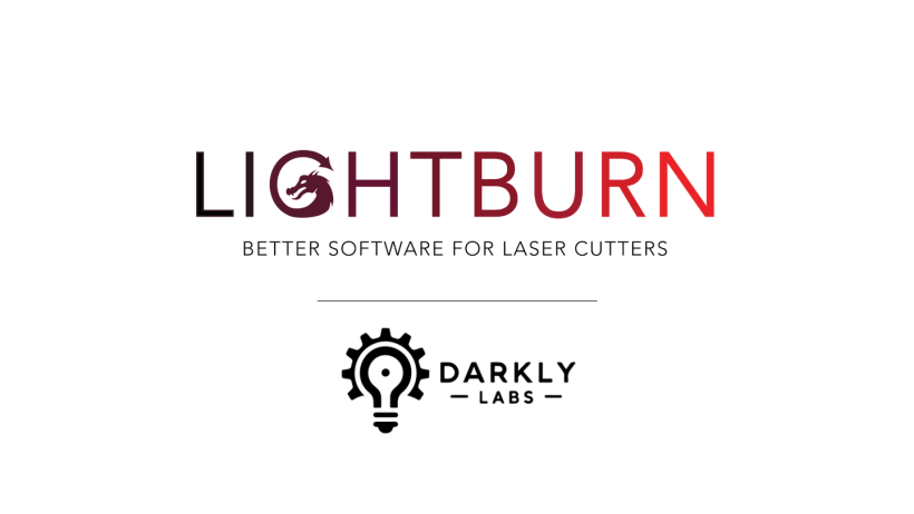

When you buy an Emblaser, the LightBurn license key that comes with it has a special tag that allows it to work with Darkly Labs machines. When you start LightBurn using a license with this special tag, you'll see the Darkly Labs logo on the splash screen at startup. If this logo is missing and you think this is an error, please contact support for further help.
Splash screen showing Darkly Labs logo
