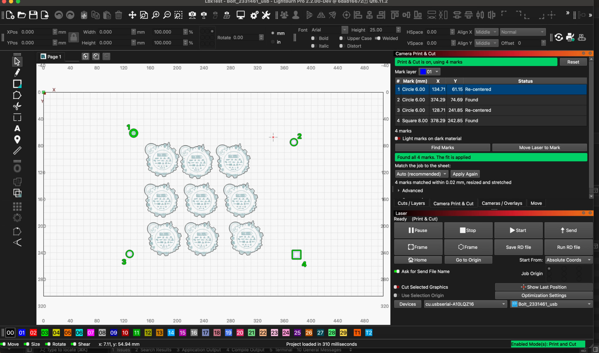

- Load your design, with its registration marks, and print it at 100% scale.
- Go to Window → Camera Print & Cut to open the Camera Print & Cut Window.
- LightBurn chooses the Mark Layer for you. Check to make sure it's correct, and if not, change the Mark Layer to the one you want to use. The marks and their locations appear in the list and are highlighted in the workspace.
- If you're using light marks on dark material, turn on Light Marks on Dark Material.
- Place the printed sheet in the laser.

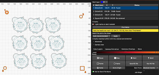

- Jog the head so the camera can see the mark named in the yellow line in the window, for example "Park the head over mark 1".
- Click Find Marks. LightBurn finds that mark, then moves to each of the others in turn.
- When every mark is found, the fit is applied automatically, and the window says Found all 4 marks. The fit is applied.
- If you want to be really certain, check the fit: select a mark in the list and click Move Laser to Mark.
- Run your job as usual. It is moved onto the printed sheet.

While the Camera Print & Cut window is open, every mark is outlined in orange, with its number beside it, so you can find marks even on a hidden layer or a pale layer color. Circles and donuts get a circle, and squares a square turned to match the mark. The mark selected in the list has a thicker, filled outline. Once the fit is applied, the outlines of the marks it used turn green.
This screenshot shows the marks in orange, with one selected, before the fit is applied
This screenshot shows the rings in green after the fit is applied.

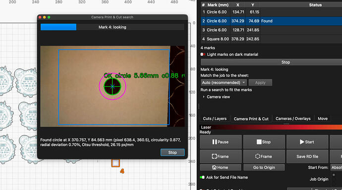

Click Find Marks to find every mark. Before you click it, jog the head so the camera can see the mark the window names. You can choose a different starting mark by selecting it in the list.
LightBurn searches around where it expects each mark. If it can't find one, it stops and shows Mark # not found. You can:
- Jog the head near the missing mark, then click Search Here.
- Click Skip to leave the mark out and carry on, as long as at least three marks remain.
Click Stop at any time to end the search.
Match the Job to the Sheet¶
Choose how the job may be adjusted to match the marks:
| Option | What it does |
| Auto (recommended) | Chooses the best of the options below for the marks found. |
| Keep size | Moves and rotates the job only. |
| Resize evenly | Also resizes the job, by the same amount across and down. |
| Resize and stretch | Resizes across and down separately, for a printer that stretches the sheet. Needs four or more marks to be checked properly. |
Below it, a line tells you how closely the marks matched, for example 4 marks matched within 0.08 mm, resized evenly.
Apply and Reset¶
The fit is applied automatically when every mark is found and they all match. Otherwise, check the warning, then click Apply to use the fit anyway.
While a fit is applied, a green bar at the top of the window says Print & Cut is on. Click Reset beside it to turn Camera Print & Cut off.

Click Camera view to see the last image the camera captured, with the mark it found outlined.
To check one mark without moving the head, select it in the list, jog the head so the camera can see it, and click Find Mark in View. The line below the image says where the mark was found and how big it is.
