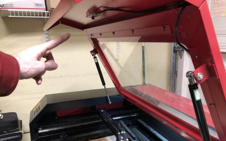

The best place to mount an overhead camera is directly above the center of the bed of the laser, with the bed completely visible. The best way to do this is usually to mount the camera on the inside of the lid, so the placement is correct when the lid is open.

Camera installed in a laser

  • The camera must be solidly mounted to be in exactly the same position when using it as it was when you performed the alignment process. If you mount it to the lid of your laser, make sure the lid opens to the same place every time. You can use a cord or rod to ensure the lid is always at the same position when opened.

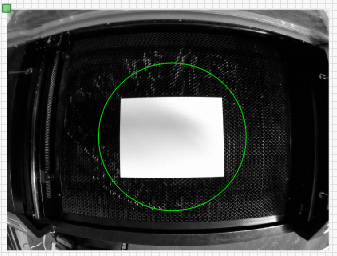

  • Focus the camera so as much of the bed is in focus as possible. Some cameras, like the 5mp-60, have a narrow focus depth, and if mounted high, can be tricky to focus. If this happens, focus on a circle that is roughly halfway from the center of the bed to the edge of the image, like this:
focus area
If you can't get the entire area in focus, try to focus approximately where the green circle is
