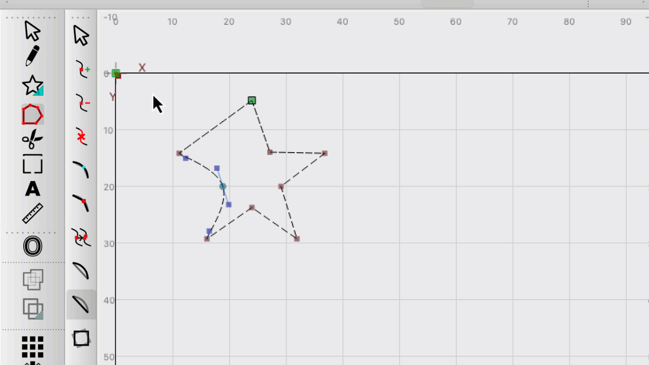

With the Select action enabled in the Edit Nodes Toolbar, you can select and adjust nodes and lines directly with your mouse.
  • Click and and drag on nodes, handles, or curves to move them.
  • Click any node or handle to select it, and then use the keyboard arrow keys and modifier keys to move it by the increments set in the Shape Move Increments fields in the Settings window.
  • With a node or handle already selected, hold Shift while clicking on another node or handle to add it your selection, then drag or use the arrow keys to move each selected node or handle in unison.
  • Click any straight line and drag to automatically turn it into a curve.
  • Drag disconnected nodes on top of one another to automatically join them, turning the lines on either side into a single shared path.
Mouse action demo
