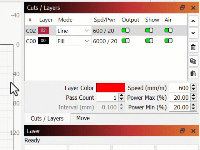

Right now, your circle is on the same layer as the QR Code and text. This means it'll be filled in like them as well. We'll need to move it to a different layer and give it its own cut settings.
My design is reversed!
A filled shape inside of another filled shape will act as a cutout, similar to a donut hole. We'll fix this in a moment. You can also see a more detailed explanation in How to Invert a Vector Engraving.
  1. Make sure the circle – but nothing else – is selected.
  2. At the bottom of the main window, look for the Color Palette. Select a layer other than Layer 00 or the Tool Layers, T1 and T2.
  3. In the Cuts / Layers Window, adjust the Speed and Max Power settings to a higher speed and lower power than your manufacturer recommends for cutting through the material you're using. This will let you engrave (or score) a line without cutting through.
  4. Preview your design. Your QR Code and text should still be filled in, but the circle should be just a line that the laser travels along.

The last piece of the design is the circle to cut out. You could do the same thing we did for the previous step – draw a circle and center it with the Alignment tools – but this is a wonderful opportunity to get familiar with the Offset Shapes tool.
  1. Make sure the circle is selected.
  2. Go to Tools → Offset Shapes or press Alt/Option+O to open the Offset window.
  3. Make sure the Direction is set to Outward and Optimize / Simplify results is enabled. Adjust the Distance so that it looks good to you – LightBurn will give you a live preview as you adjust it. Somewhere around 6 mm or ¼" should work well, but this is your coaster and it's up to you. Press OK to create the new circle.
  4. As you did before with the first circle, move this circle to a different layer and adjust the cut settings.
  5. See your laser's user guide for recommended speed and power settings to cut through the material you're working with.
  6. If your laser has an air assist, keep the Air switch on to enable air assist for this layer. Air assists are helpful during cutting operations.

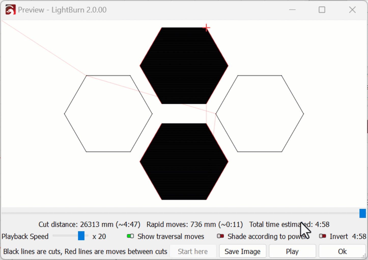

Now that your design is complete, preview it one more time. Remember that you can open the Preview window with Alt/Option+P. Press Play to preview what your laser will do. You can use the slider at the bottom to speed up or slow down the simulation.
In the simulation, you should see the following happen in order:
  1. Raster engraving to fill in the text and QR Code.
  2. Vector engraving the decorative border — the laser should follow the outline of the circle.
  3. Vector cutting the outer circle.
It's generally best to do engravings before cutting out your design. If you followed along with the steps above, your layers should already be in the right order. If they aren't, you can drag them around in the Cuts / Layers Window to change the order – by default, LightBurn will run each layer in order from top to bottom.
If you make changes, preview them again before moving on to cutting your design.
Learn More: Preview
Pressing play in the Preview window
When you first open the Preview window, you'll see a still image of the final result of your project — the contours to be scored or cut by Line Mode will be indicated by black lines, and the areas to be etched or engraved by Fill Mode will be shown as solid black areas, or, if your Line Interval is relatively large (or you zoom in close enough) as parallel lines running across the filled shapes.
You'll also see red lines — these lines indicate the path your laser will travel while not firing. You can toggle Show traversal moves at the bottom of the Preview window to switch between showing these moves or not.
Press Play to see a simulation of the movements and lasering operations your laser will perform when you start the job. In addition to making sure the laser will outline or engrave the correct graphics and areas, you'll be able to make sure it performs those actions in the order you want.
By default, the simulation will play in a close approximation of the job's real runtime, and Total time estimated is shown in the bottom right. You can adjust the Playback Speed slider to speed up or slow down the simulation.
See Preview Troubleshooting for help identifying and resolving any potential issues you spot in the Preview window.

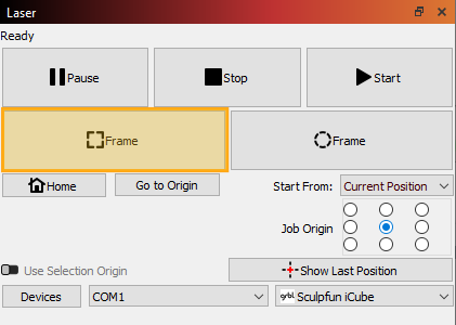

LightBurn has three different Start From modes: Current Position, User Origin, and Absolute Coordinates. For this project, you'll be using Current Position.
  1. Set Start From to Current Position using the dropdown in the Laser Window.
  2. Set the Job Origin in the Laser Window to the center of the artwork.
  3. With these two settings, your engraving will be centered wherever the laser is positioned when you start the job.

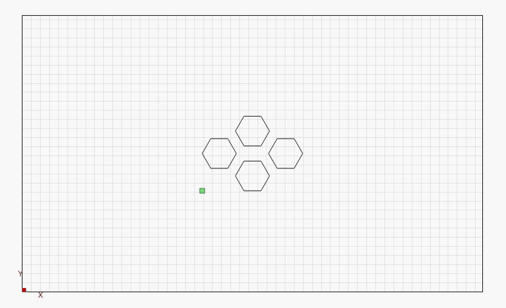

Learn More: Current Position
With Current Position selected, your job outputs relative to wherever the laser head is located when you press the Start button. The Job Origin control in the Laser Window tells LightBurn how to orient output relative to the laser head.
In this image, we're starting from the Current Position, with the Job Origin set to the lower left:
Current Position Bottom Left Job Origin
Notice the location of green Job Origin indicator. This represents the position of the laser when you start the job, so the laser is going to move slightly up and to the right from wherever it is, cut the four hexagons, and go back to where it started.
Why is the Job Origin offset from the graphics?
When using Current Position or User Origin, the green Job Origin indicator is always located on a corner, side, or at the center of an imaginary box — the smallest possible rectangle that can fully contain all graphics you're sending to the laser.
Below, we've added a Tool Layer to represent that imaginary box. Notice how the Job Origin moves around the box as we change the location in the 9-Dot selector.

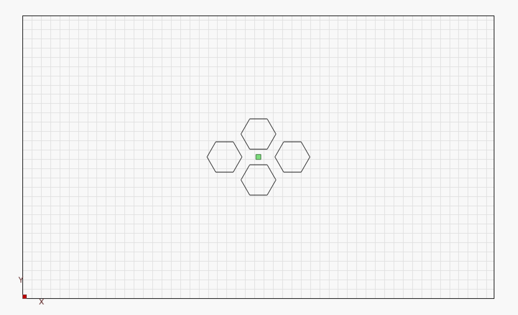

Changing Job Origin
Now imagine that you want to etch this four hexagon pattern onto a coaster or a phone case. Lining it up from the lower left is not easy. If you change the Job Origin setting to center, you get this instead:
Current Position Center Job Origin
The job will be centered around the current position of the laser head. If you position the laser head directly over the center of the item you want to etch, the output will be centered on the item.
  1. Jog your laser to the center of your coaster. If your laser has a controller display and keypad, you can use the buttons there to jog. If not, use the buttons in the Move Window.
Framing
The final check before you can run the job is to make sure that it will output in the location you're expecting.
  1. Click the Bounding Box Frame button to tell your laser to trace a box around the area the coaster will be cut and engraved.

    Framing with Current Position
    Here we've selected Current Position as the Start From mode, and the top right Job Origin position, so the laser moves down and to the left from its starting position:
    Current Position Top Right Workspace example
    Current Position Top Right Framing live example
    Here's Current Position again, but with the center Job Origin position selected — now the laser moves out from where it's sitting, and traces a rectangle centered on the location where it began:
    Current Position Center Workspace example
    Current Position Center Framing live example
