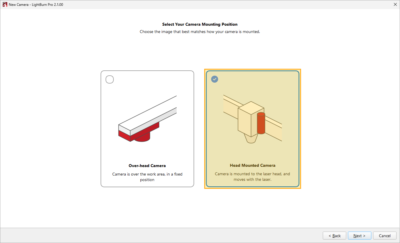

Head cameras are attached to a laser's head and travel with it as it moves around its work area. After properly Calibrating and Aligning your Head camera, LightBurn will be able to stitch together captures taken by the camera at multiple locations in the work area, producing an Overlay for your Workspace that you can use to position graphics over material.
Before configuring your head camera, make sure the camera is securely mounted to your laser head, with no ability to move or wiggle as the laser jogs. Before use, make sure the camera's wires don't interfere with the laser's movement.

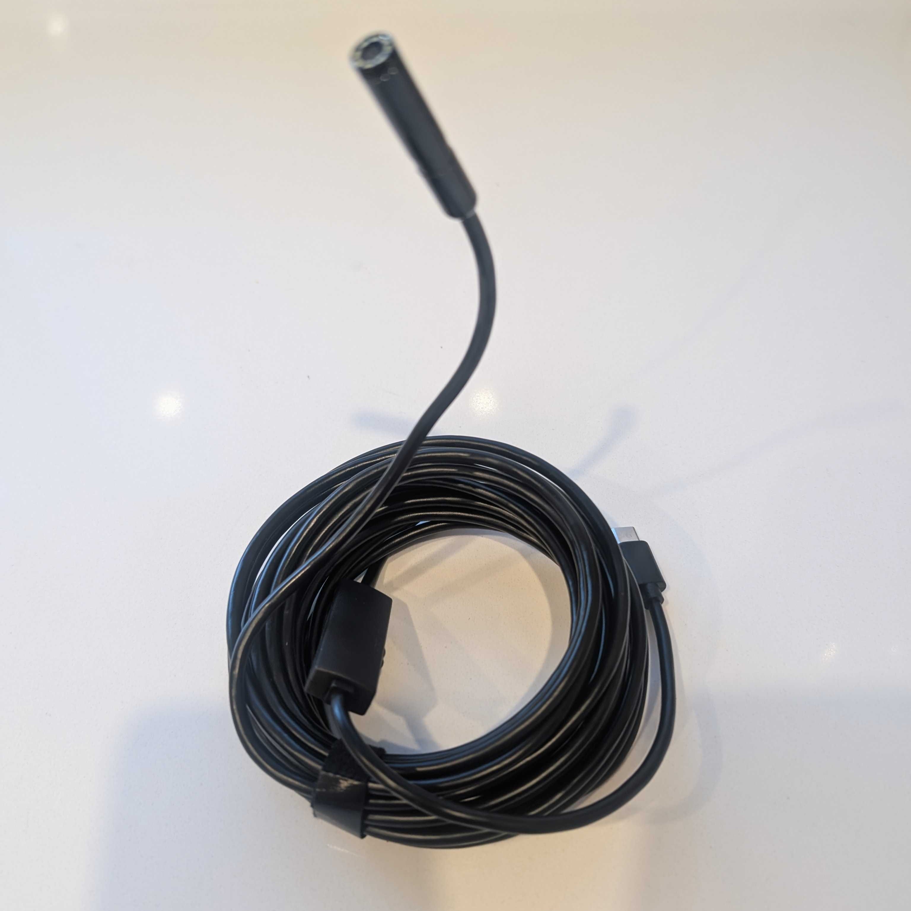

With growing interest in Head Cameras for compatibility with our new Camera Print & Cut feature, we've had more people asking for guidance on what to purchase.
If your laser didn't come with a head-mounted camera pre-installed, we recommend an inexpensive USB Endoscope Camera with a long, flexible USB cable. These cameras are also sometimes listed as a "USB Inspection Camera". Avoid cameras with built-in screens or rigid or semi-rigid cables that will interfere with your laser's motion. As of October 2026, these cameras are typicallly available for about $15-30 or €20-30 from common online retailers.
Example image of an endoscope camera with a coiled cable. This one has a semi-rigid cable but you should look for one with a flexible cable
Example image of the type of endoscope camera to look for. This one has a semi-rigid cable, but you should look for one with a flexible cable.
If you want to explore other options, any small, light camera you can mount securely to your laser head and connect to over USB or WiFi should work. Keep in mind that WiFi cameras that use RTSP will not work - IP cameras need to output individual frames or an MJPEG feed.
For more information on mounting your new camera, see Camera Intallation - Head Cameras.

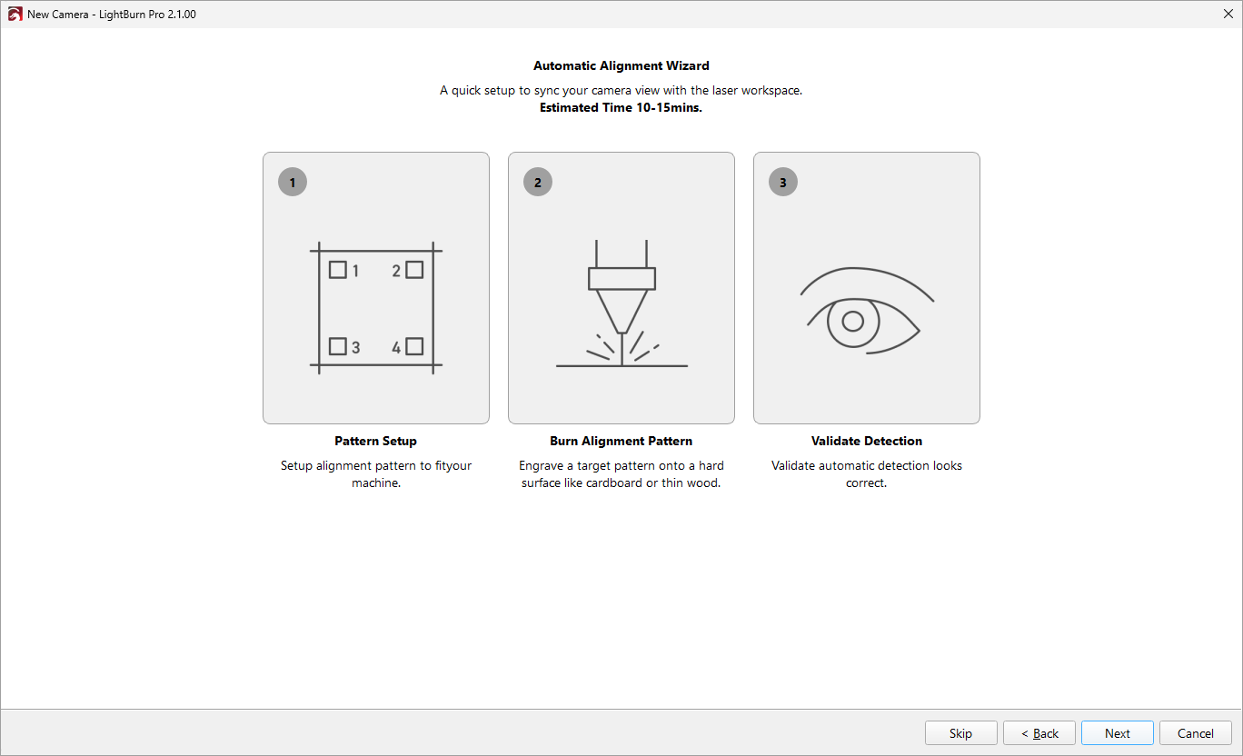

The Camera Alignment Wizard will walk you through the process, or you can continue reading for more detailed instructions. Click Next to continue to the next screen and select your alignment method.
1. Select Camera Alignment Method
You can use automatic or manual Camera Alignment. The automatic method is quicker and easier, but requires good lighting and high contrast between the marked pattern and the background material. Select the method you want to use and click Next. You'll see an overview of the process you've chosen. Click Next again to continue to set up your alignment pattern.
Overview screen for automatic alignment
Overview screen for automatic alignment.
Overview screen for manual alignment
Overview screen for manual alignment.

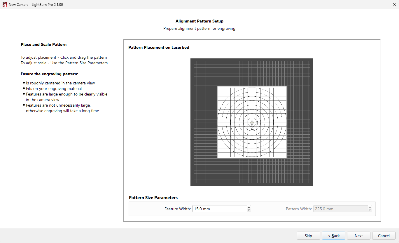

2. Alignment Pattern Setup
The automatic alignment process and the manual alignment process use different patterns, but the process is similar. Regardless of which pattern you're using, you can adjust the Feature Width under Pattern Size Parameters to adjust the size of the markings and the overall pattern size. The pattern should be:
  • Roughly centered in the camera view.
  • Sized to fit on your engraving material. Adjust the overall size by changing your Feature Width.
  • Created with features large enough to be clearly visible in the camera, but not so large they take an excessively long time to engrave.

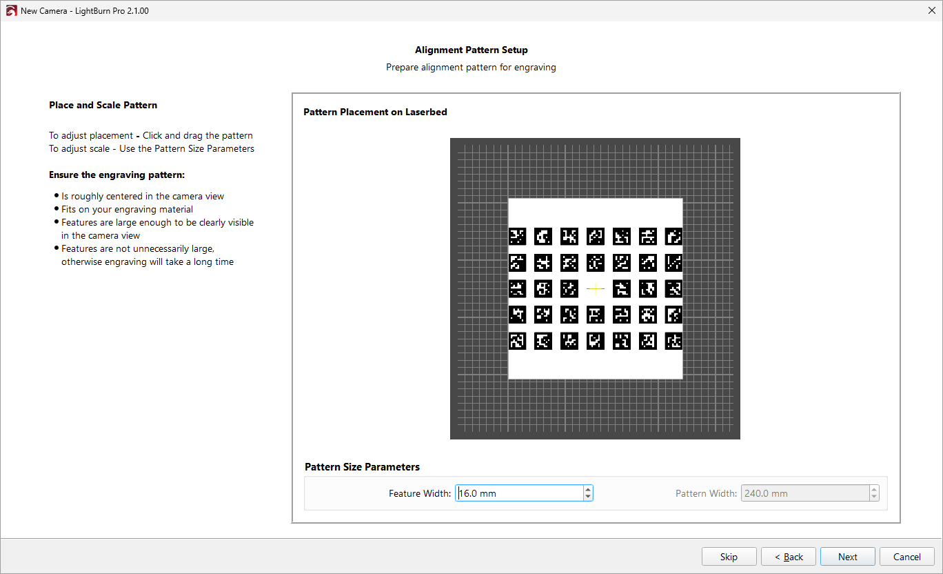

Automatic Alignment Pattern
The automatic alignment pattern uses AprilTags to allow LightBurn to automatically detect the position of the camera relative to the workspace.

Manual Alignment Pattern
The manual alignment pattern engraves a set of markers for you to identify, and uses them to guide you through aligning the camera to the workspace yourself.
Screenshot of Manual Alignment Pattern Setup

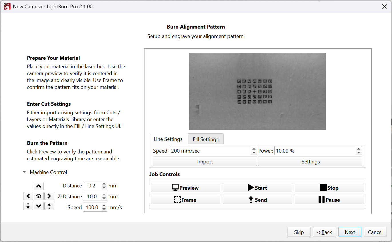

3. Burn Alignment Pattern
This step is the same between automatic and manual alignment, even though the actual pattern is different. Place your material in the laser cutter, make sure it's focused, and get ready to burn the alignment pattern.
Screenshot of burning alignment pattern
Use the camera preview to make sure the material is near the center of the image and clearly visible. Use Frame to make sure the pattern fits the material, and use Preview to see what will actually be burned. Use the Machine Control section in the lower left to move your laser head around if needed.
Adjust your cut settings to engrave a dark, crisp mark without cutting through the material. You can adjust your settings in a few ways:
  • Adjust speed and power right in the Alignment Wizard window, just below Laser Settings.
  • Click the Import button to load a layer from your Material Library.
  • Click Settings to adjust your layer settings in the Cut Settings Editor.
Run the job using Start or Send, however you'd usually control your laser.
Do not move the pattern after you burn it, or you will need to burn a new alignment pattern.

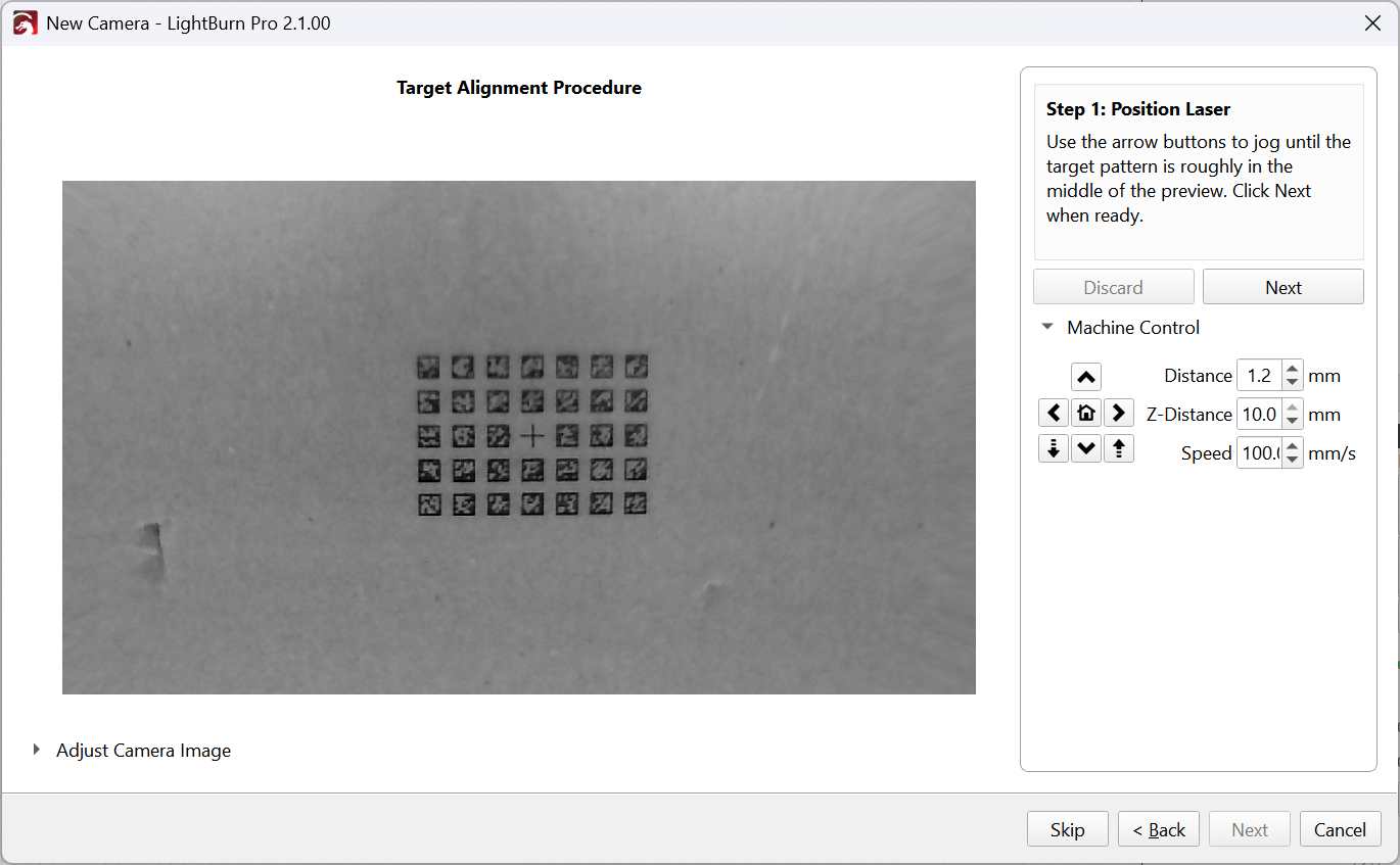

Automatic Target Alignment
Automatic Alignment uses the camera to read the AprilTags you've engraved.
1. Position Laser
Start by using the arrow buttons to jog until the target pattern is roughly in the middle of the camera preview, then click Next.
Screenshot of automatic target alignment process

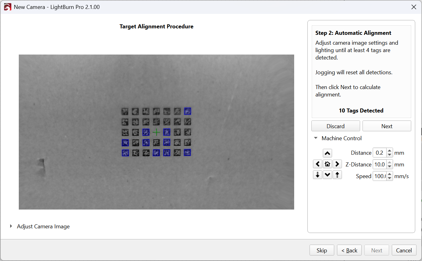

2. Detect Tags
Adjust the camera image settings and lighting until at least 4 tags are recognized. Recognized tags are highlihgted in blue. If you jog the laser, LightBurn will reset the detection of the tags. Click Next to calculate the alignment.

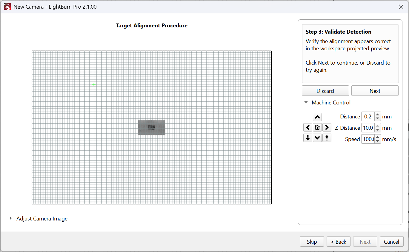

3. Validate Detection
Make sure the alignment appears correct in the projected camera preview. Click Next to continue, or Discard to try again.

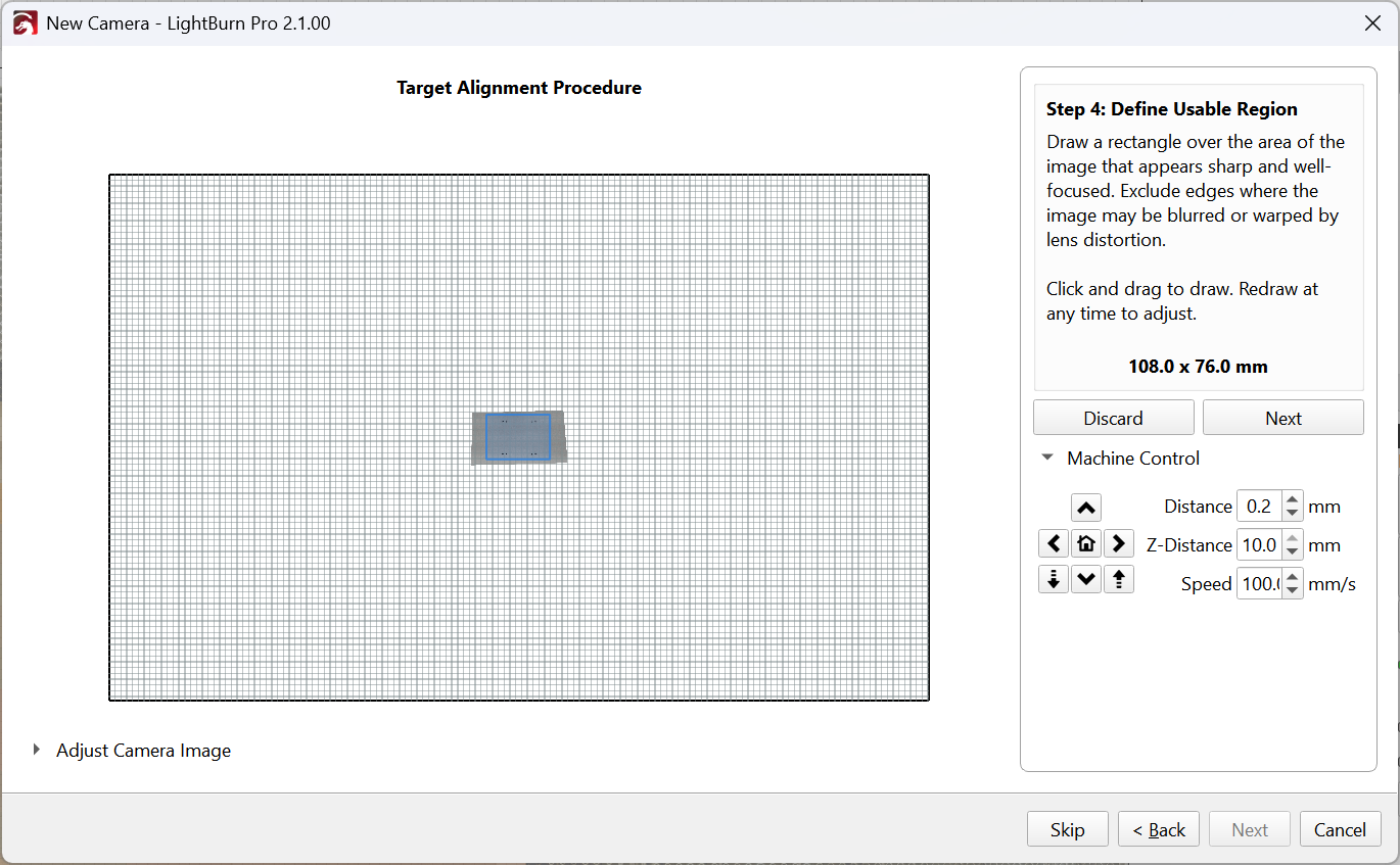

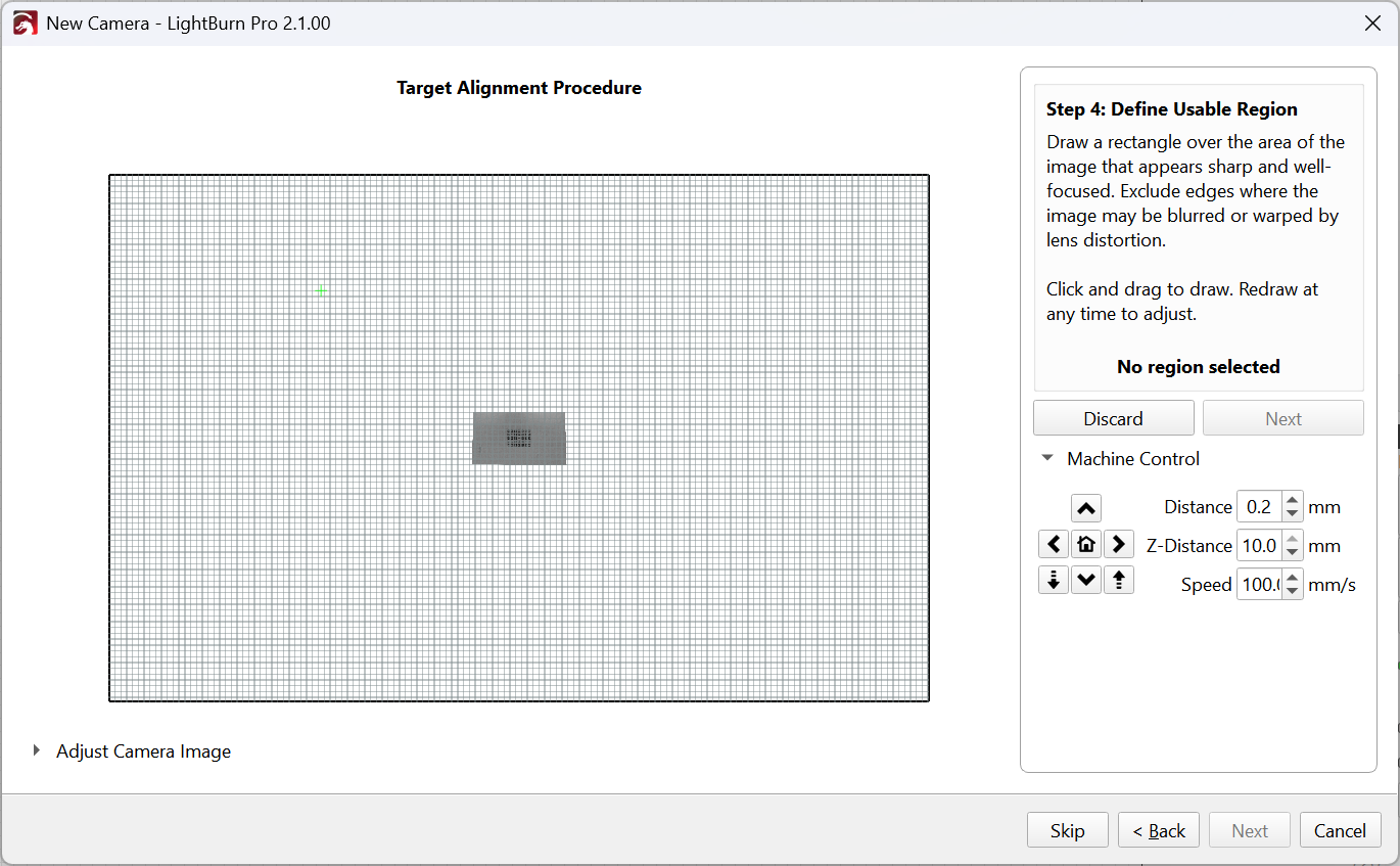

4. Define Usable Region
Click and drag to draw a rectangle over the portion of the image that appears sharp and well-focused. Leave out edges where the image is blurred or warped by lens distortion. You can redraw as much as you want to adjust this. Click Next to save the camera alignment, then Finish on the final screen.

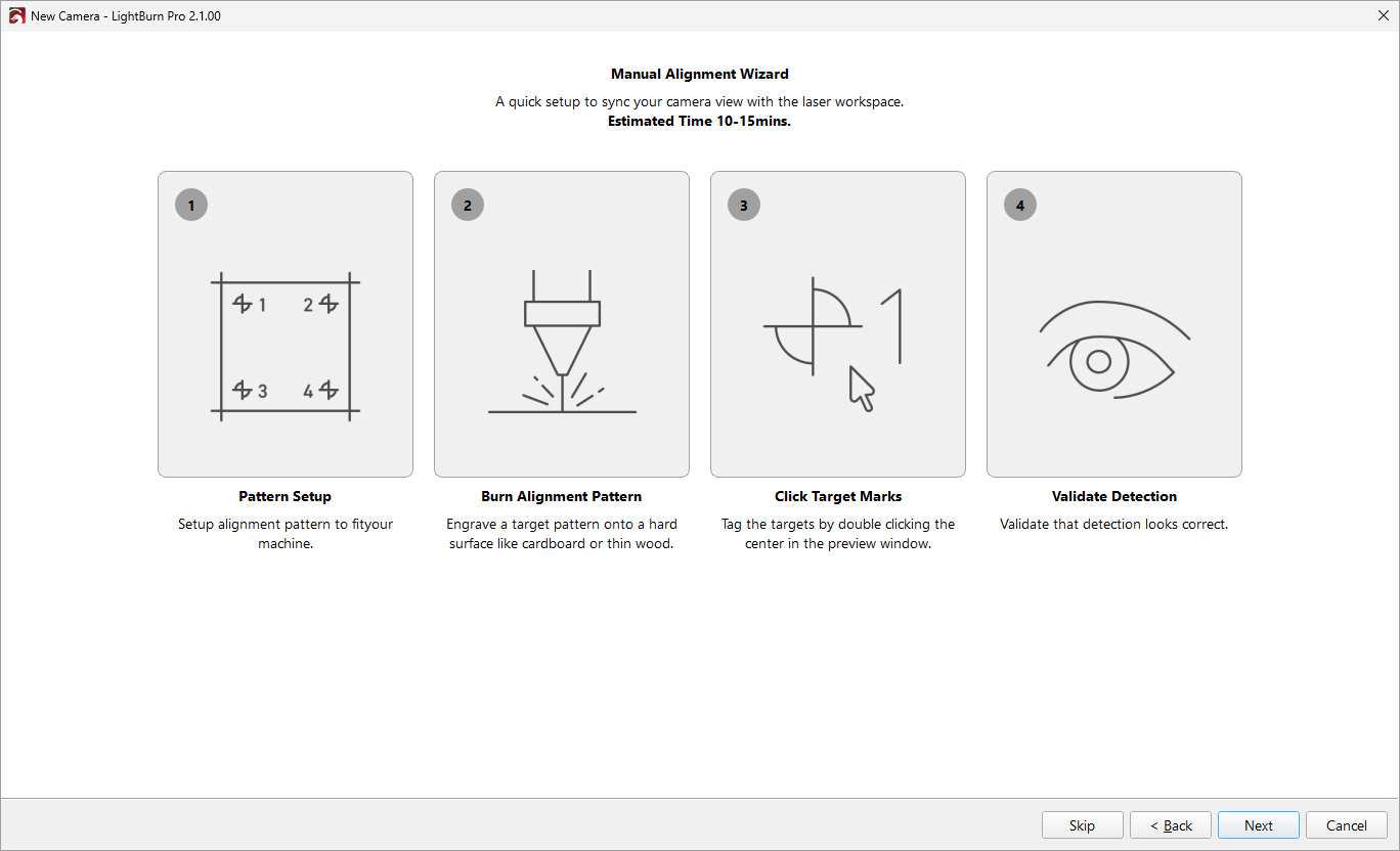

Manual Target Alignment will walk you through identifying the centers of the targets you've engraved and identifying the portion of the camera's view that's clear and well-focused.

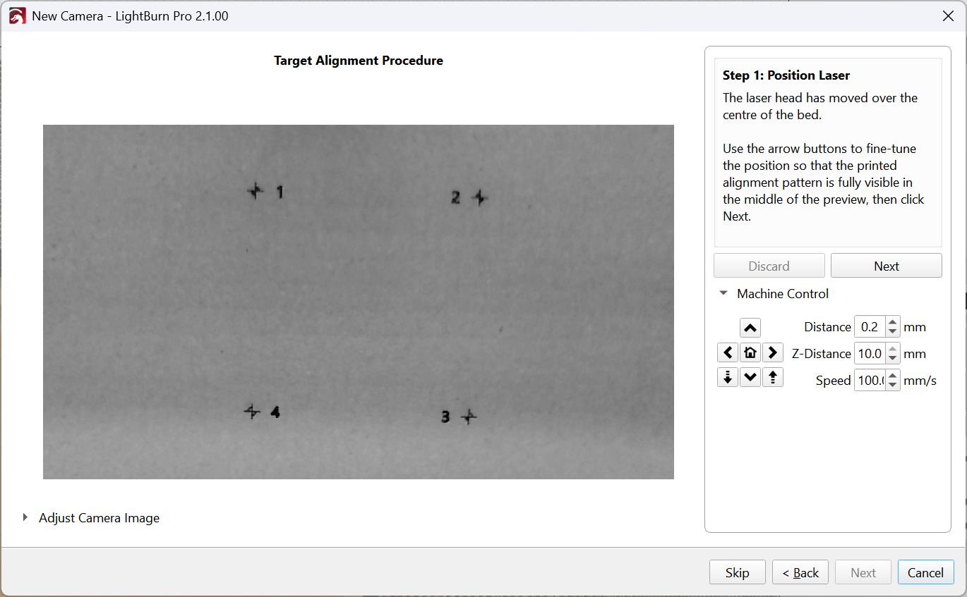

1. Position Laser

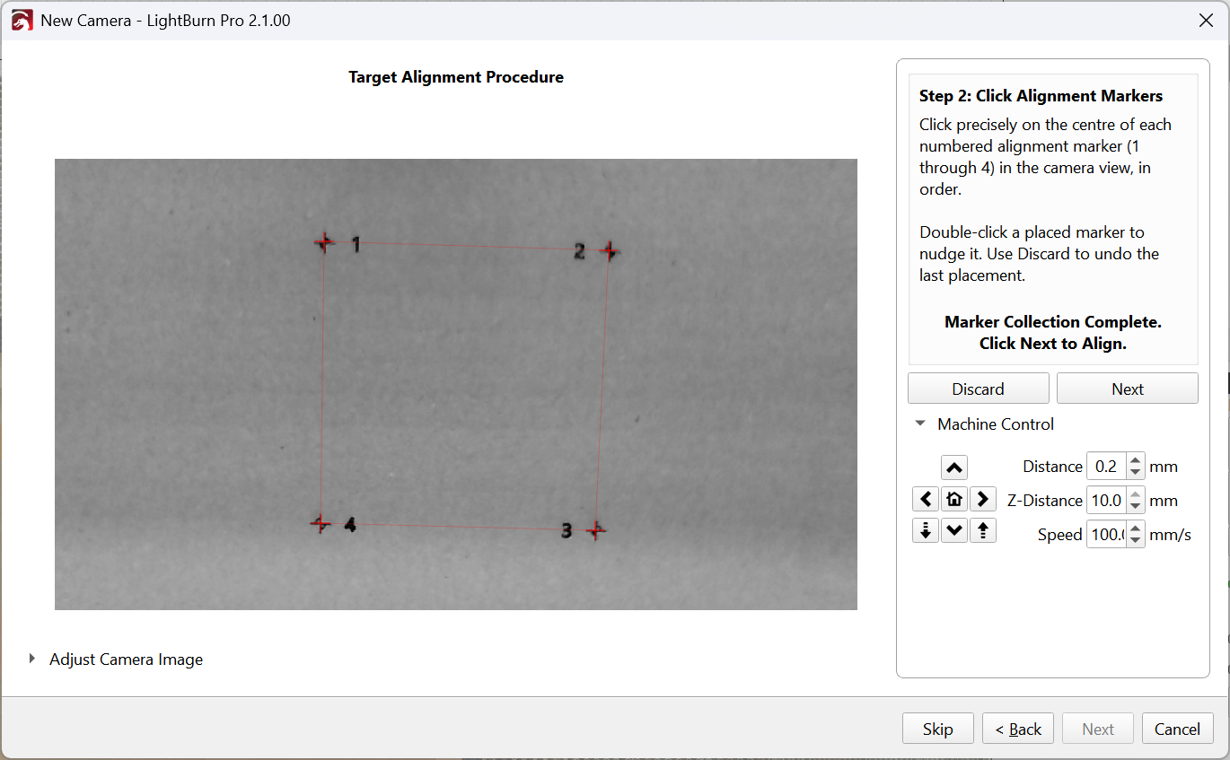

2. Click Alignment Markers
Click precisely on the center of each numbered alignment marker in order, as directed in the instructions. Double-click a placed marker to nudge it if you're slightly off, or click Discard to undo the last placement. When you've selected all four, a red box will connect all four markers. Click Next to continue and calculate the alignment.

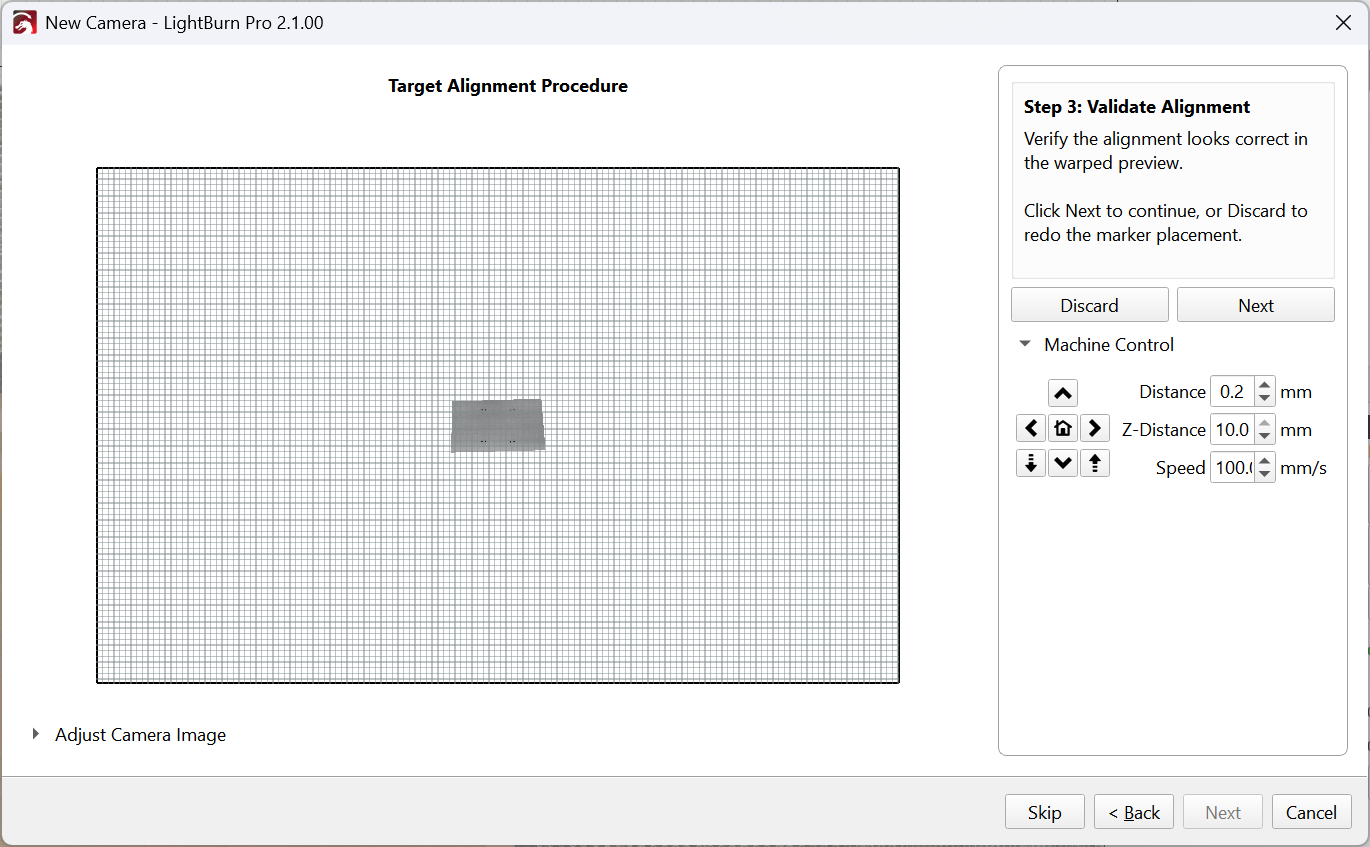

3. Validate Alignment
