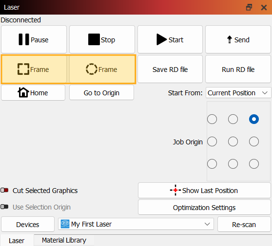

There are two Frame buttons in the Laser Window — clicking either will command your laser to trace a path around the area where your project will output.

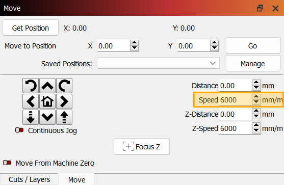

The speed at which the laser travels during Framing is determined by the value set in the Speed field in the Move Window.
The framing buttons in the Laser Window
Speed control in the Move Window

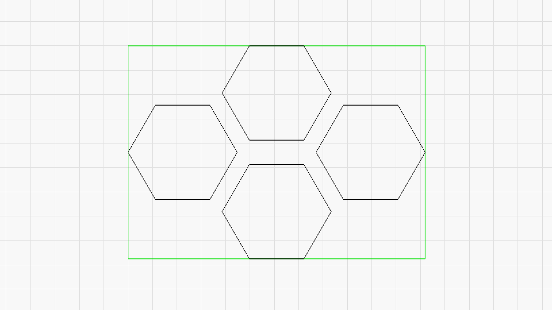

Bounding Box Frame
Bounding Box Framing commands the laser to trace a path defined as the smallest possible rectangle that will fully contain all graphics you're sending to the laser.
Here's a representation of that path in LightBurn:
Box Frame representation in LightBurn

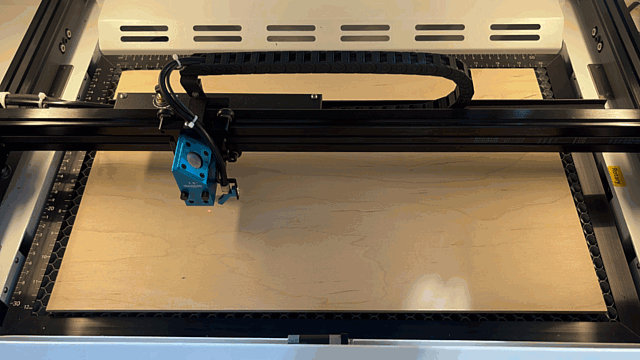

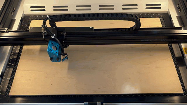

And here's the laser following that same path during Framing:
Live Bounding Box Framing example

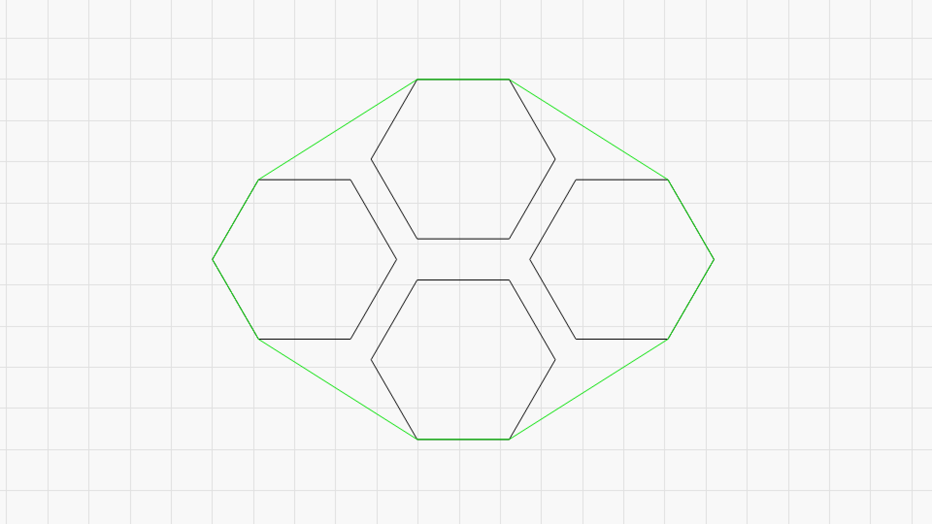

Rubber Band Frame
Rubber Band Framing commands the laser to trace the smallest possible path that fully contains all graphics in the design you're sending to the laser, as if a rubber band were stretched around them.
Tip
Rubber Band Framing is useful for lining up jobs with irregular shapes where a box outline doesn't fit well. For example, a long, thin diagonal shape, or a triangle.
Rubberband Frame representation in LightBurn
Live Rubberband Framing Example

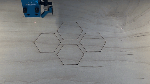

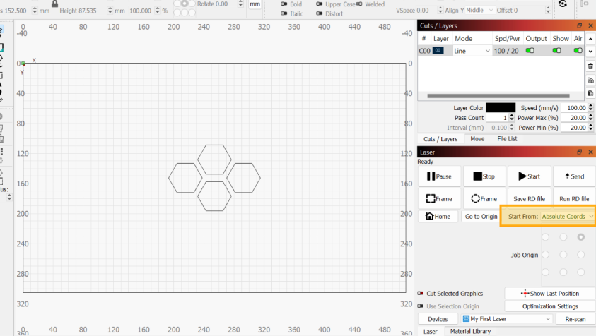

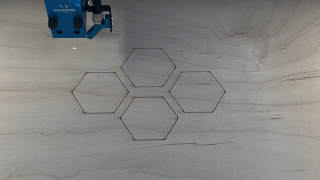

In the first example, we have Absolute Coords selected, and our four hexagon design placed directly in the center of the LightBurn Workspace, so when we press the Frame button, the laser traces a rectangle in the exact center of its work area:
Absolute Coords Workspace example
Absolute Coords Framing live example

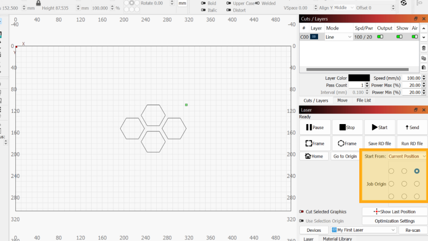

Here we've selected Current Position as the Start From mode, and the top right Job Origin position, so the laser moves down and to the left from its starting position:
Current Position Top Right Workspace example

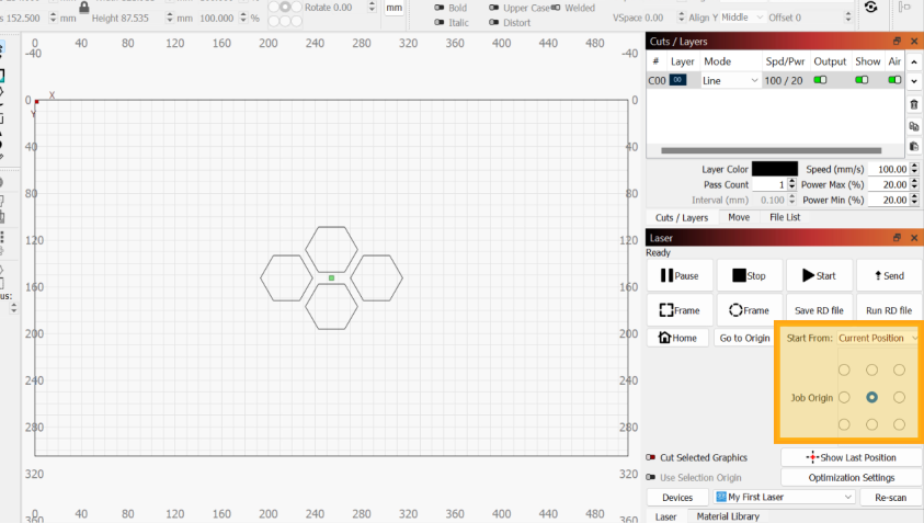

Here's Current Position again, but with the center Job Origin position selected — now the laser moves out from where it's sitting, and traces a rectangle centered on the location where it began:
Current Position Center Workspace example
Current Position Center Framing live example

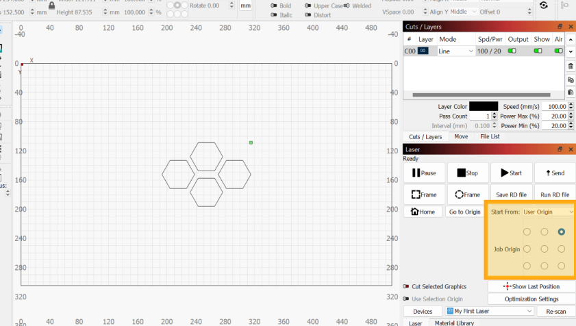

Finally, here's User Origin and a top right Job Origin — prior to Framing we'll jog the laser to the top right of its work area, then set the origin (in this case, we used a DSP laser and set the origin from the controller).
Note how even though we jog the laser down to the bottom left after setting the origin, when we press Frame it returns to the top right, to trace a rectangle determined relative to where we set the origin:
User Origin Workspace example
User Origin Framing live example
