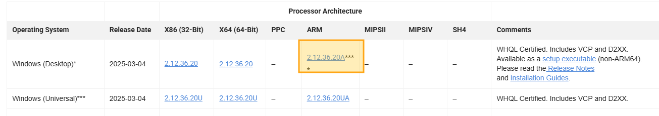

The FTDI driver needed for Ruida or Top Wisdom controllers is available for Windows on ARM, but requires manual installation.
  1. Download the Windows ARM driver here and unzip the folder in Windows.
    Download the ARM driver for Windows Desktop

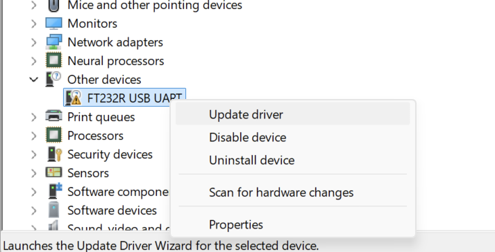

  2. Open Windows Device Manager and locate your laser cutter.
  3. Right-click on the device in Device Manager, and choose Update Driver.
    Screenshot showing how to manually install device drivers
  4. Locate the folder you already extracted and select it to tell Windows where to find the driver. Click OK.
