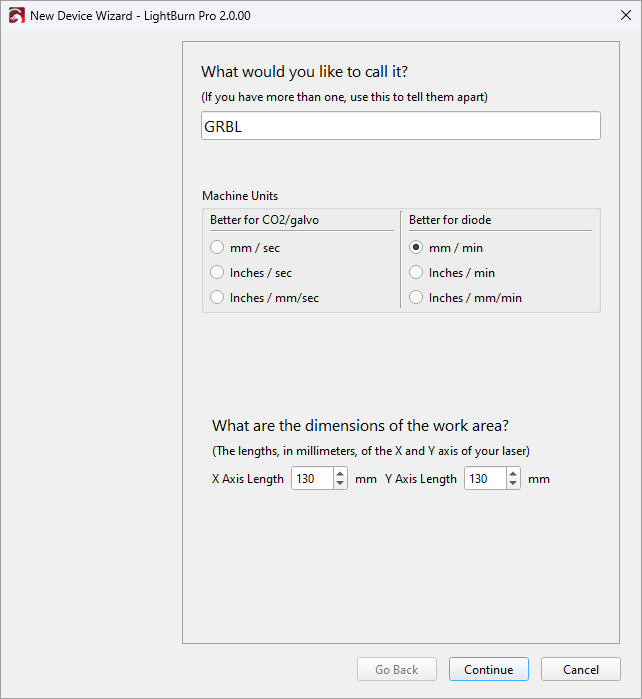

  7. Name your device, choose the units you want to use for this device, and confirm that the dimensions of the work area are correct.
    FindMyLaser
    Note
    Some lasers require additional information in order to complete the setup process. Continue below.
