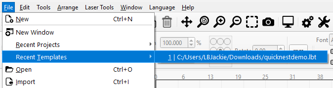

Recent Templates
Hover over Recent Templates in the File Menu to open a submenu containing a list of Template Files you've recently worked on and Saved.
Click any file in the list to Open it.
Read More
Recent Templates Submenu
