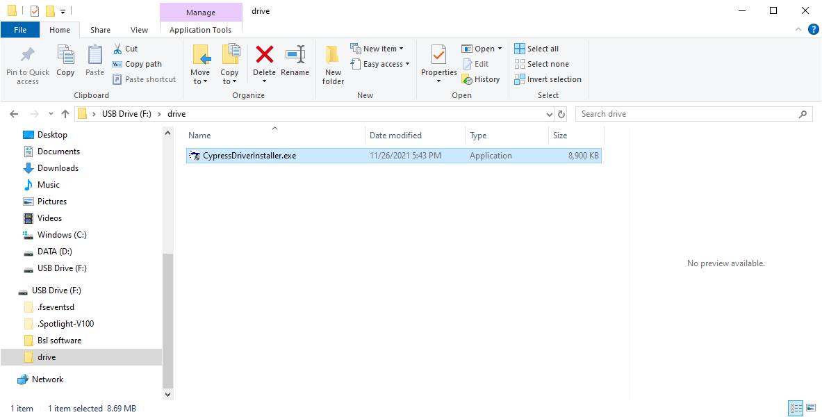

Install the Cypress Driver
Search the USB drive that came with your laser for the executable file that installs the Cypress driver. Double-click the file to begin the installation process.
The SeaCAD executable file
The CypressDriverInstaller.exe file will install the necessary driver for this laser. The specific name of this file may vary for your laser.

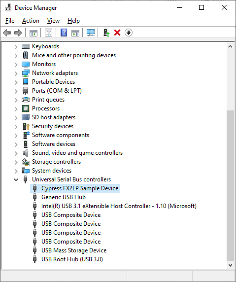

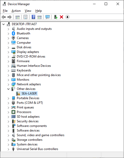

Verify Driver Installation
Opening Device Manager
To open the Device Manager, type "device manager" in the search box on the taskbar, then select Device Manager from the menu.
Your laser will appear differently in the Windows Device Manager before and after the driver has been successfully installed.
  • Before installing the driver, the laser will appear with a caution/warning symbol next to its name. If you see this, the correct driver is not installed.
  • After installing the driver, the laser will appear under Universal Serial Bus controllers as SEA-LASER (with no caution/warning symbol), Cypress FX2LP Sample Device, or something else similar.
Before Galvo Driver Installation
A BSL-based Galvo device as it appears before the driver has been installed
After Galvo Driver Installation
Success! A BSL-based Galvo device as it appears after the driver has been installed
