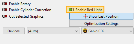

Enable Red Light
Note
This setting is available for Galvo lasers only.
Red Light enable switch
This switch controls whether your laser's Red Dot light is enabled. In order to see this switch in the Laser Window, your laser's Red Dot light must be controlled by an IO Port, and the appropriate port must be set in your Device Settings.
