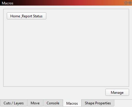

Screenshot of the macros window with one macro present
Use macros by either clicking on the buttons or using the assigned shortcut keys.
Accessing the Macros Window
If you have a GCode-based device selected, the Macros Window will be located in the upper right side of LightBurn, docked behind the Cuts / Layers Window by default.
If you have closed the Macros Window, go to Window → Macros to re-enable it. To restore it and all other windows to their default positions, go to Window → Reset to Default Layout.

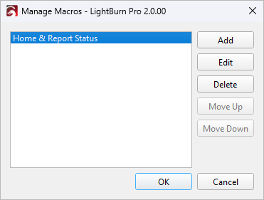

To create, edit, and rearrange macros, click the Manage button in the bottom right of the Macros Window to open the Manage Macros dialog.
This window allows you to add, edit, delete, and rearrange macros.

Edit a Macro
Edit a macro by selecting it in the Manage Macros window and clicking Edit. From here, the process is the same as adding a new macro.
Delete a Macro
Delete a macro by selecting it in the Manage Macros window and clicking Delete.
Rearrange Macros
Change the order in which macros appear by selecting the macro you want to move and clicking Move Up or Move Down, or by clicking, holding, and dragging a macro from the list to a new position.
