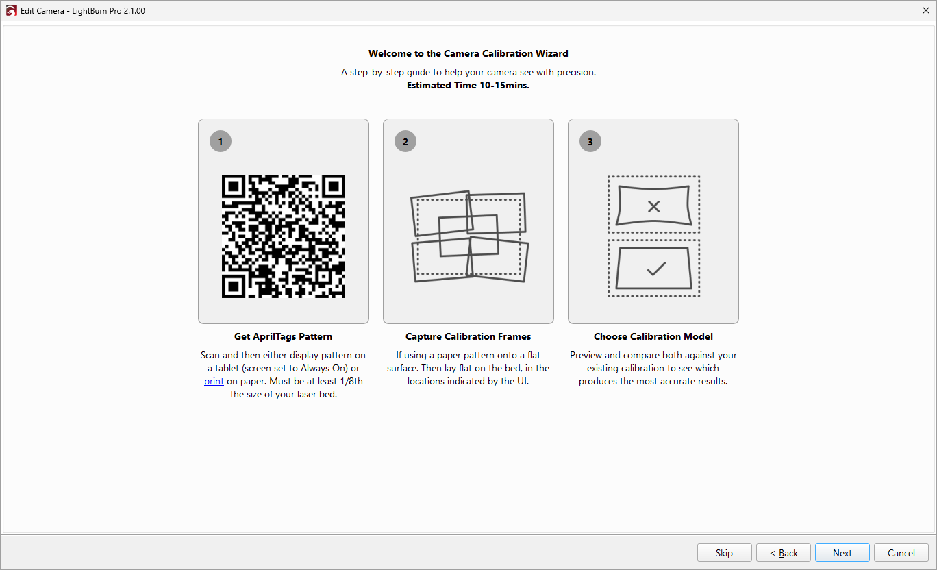

1. Prepare the Calibration Pattern¶
As described above, make sure you have the AprilTag pattern printed or loaded up on a tablet screen. LightBurn detects the tags and uses their location, size, and distortion to calculate the distortion of the camera lens.
2. Open the Camera Lens Calibration Wizard¶
There are a few ways to open the Camera Lens Calibration Wizard outside of creating a new camera:
- Click the Calibration button for the camera you want to align in the Cameras / Overlays Window.
- Click the Calibrate Lens button in the Edit Camera window.

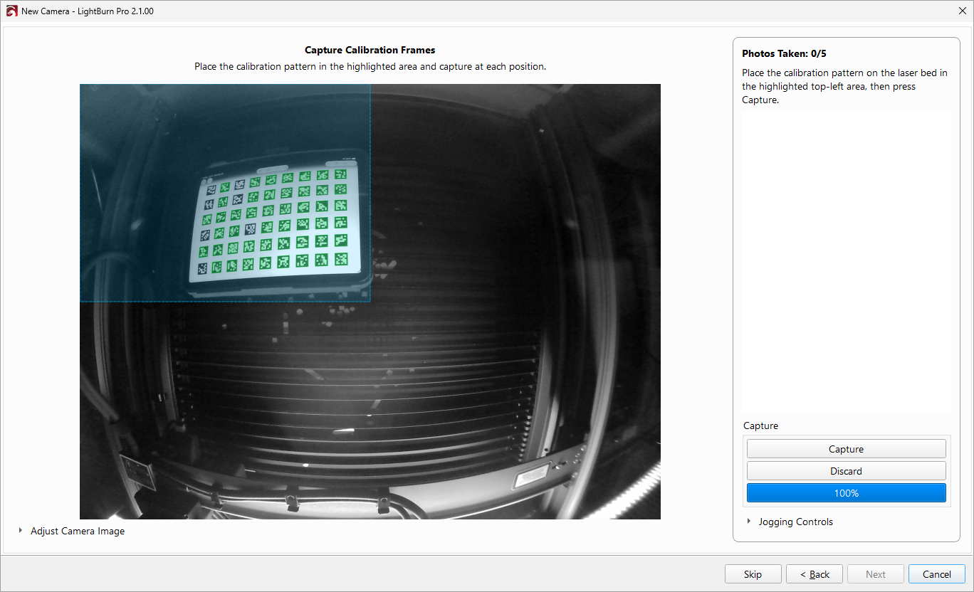

3. Capture Calibration Frames¶
The next screen will walk you through capturing Calibration Frames, which are images showing the calibration pattern in different parts of your camera's view. This is the information LightBurn needs to calculate distortion.
LightBurn's on-screen directions will show you where to hold the calibration pattern, and green highlights will appear on the AprilTags to show you when they are detected. If you're using Auto Capture, LightBurn will automatically capture the frames when the pattern is in a good place and the tags are focused. If you're not using Auto Capture, you'll need to use the Capture button to manually capture specific frames.
Camera Calibration With Auto Capture Disabled¶
- Place your calibration pattern in the camera's field of vision in the highlighted box (the blue overlay shown in the top left in the screenshot above). Detected tags will be highlighted in green. You can use the Jogging Controls in the bottom right to move the laser head out of your way.
- Click the Capture button to capture a frame. If you're unhappy with the frame you captured, you can discard it with the Discard button.
- Move the calibration pattern to fit in the next box and repeat the process.

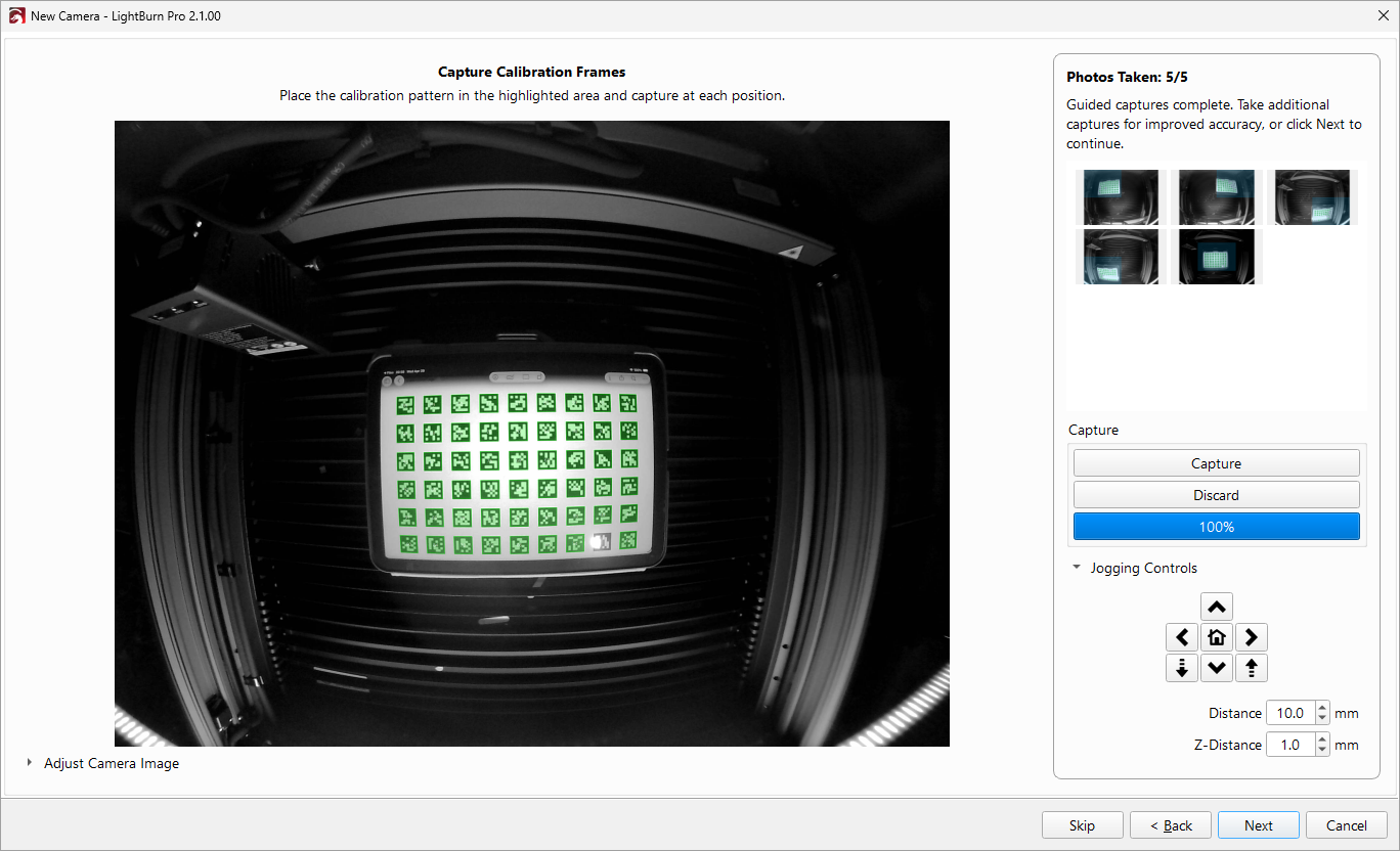

Camera Calibration With Auto Capture Enabled¶
- Enable the Auto Capture option in the bottom right corner of the Calibration Wizard.
- Place your calibration pattern in the camera's vield of vision, following the on-screen directions to guide your placement. For the first few captures, the placement won't be very specific, but after that, LightBurn will start giving you specific ways to hold the calibration pattern.
- If you can't achieve one of the calibration frames LightBurn requests, you can choose Skip and LightBurn will recommend a different placement.
- As LightBurn gets closer to being ready to capture a frame, the highlighting on the tags will shift from red to green.
- When a suitable calibration frame is detected, the highlights will be bright green and LightBurn will automatically capture the frame and move on to the next position.
Capture Complete¶
After you've captured the required frames, your view of the calibration tags should be more accurate than at the beginning, but don't worry if it's not quite right yet. You can continue to capture additional frames if you want, but in the next step you'll choose a calibration model to complete the process.

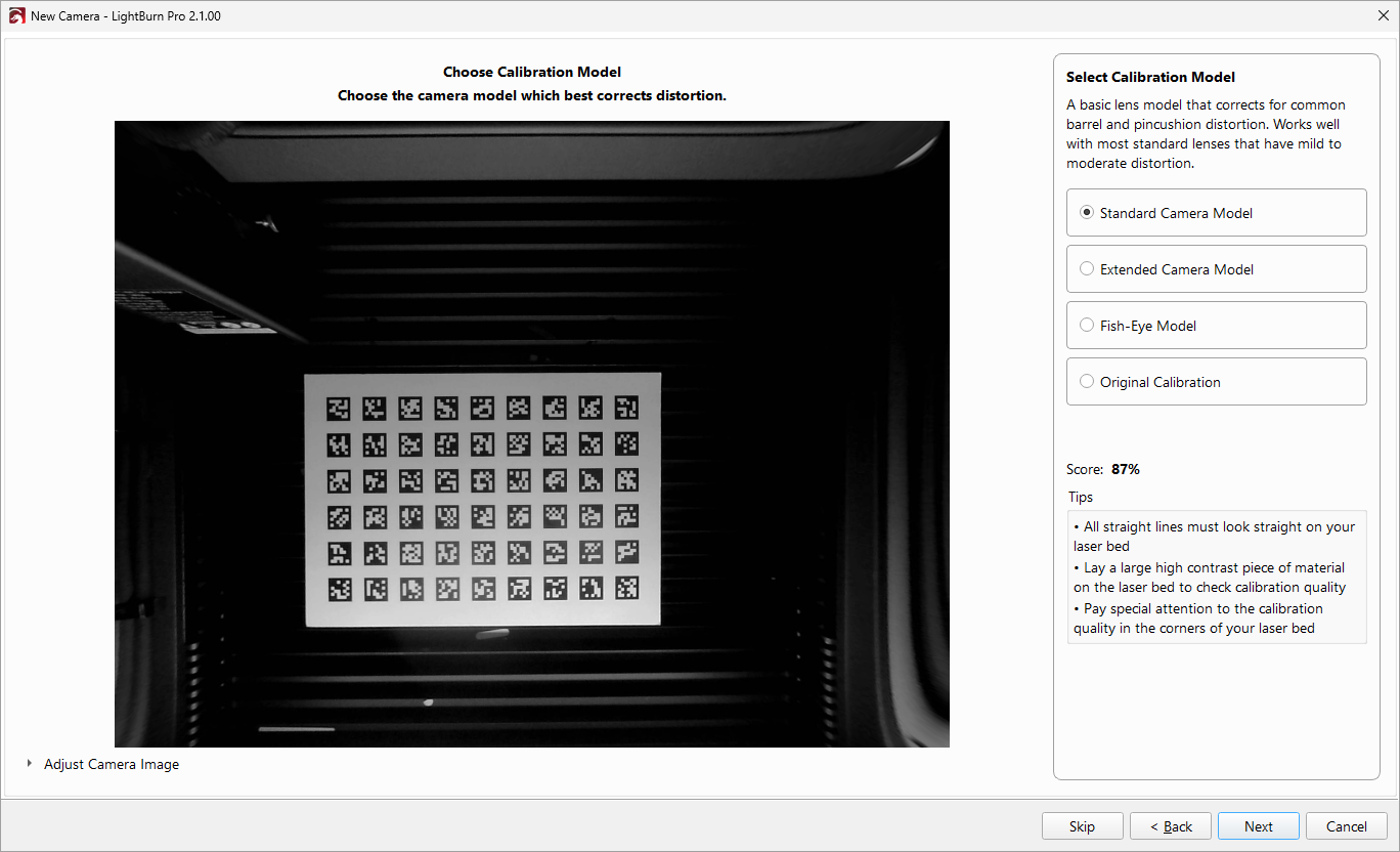

4. Choose Calibration Model¶
There are 4 different mathematical models LightBurn can apply for the corrections.
Click the model options on the right to preview what the camera image looks like under each. A large, high contrast pattern (for instance, the calibration pattern) can be helpful for checking the accuracy of the calibration. Select the model that looks the most accurate and click the Next button to continue. The Extended Camera Model works well with most lasers, but it's worth trying all of them.
If none of the models look accurate, click Back to capture additional samples or restart the process.
Tip
Look for lines you know are straight in the real world. If they're wavy or curved in the capture, that means there's distortion in the selected model.
Each model includes a description with more information.
Calibration Scores
The percentage score shown for each calibration model can be a helpful indicator, but a higher score doesn't guarantee a better calibration. Pick the model that looks most correct, even if it doesn't have the highest score. The Extended Model often produces the best results for cameras with very distorted lenses. The Fisheye Model is designed for fisheye lenses, which are a very specific style of lens, not just any camera with a very wide field of view.
Why isn't a high score always better?
The score comes from the average error between where LightBurn expects the calibration tags to be according to the calibration model and where they actually are. A calibration that only covers the center of the image tends to score higher because the center only has a little bit of distortion. Once you include the edges in the calibration, the model has to account for more real-world imperfection, so the score tends to drop, even though the calibration itself can be more accurate.

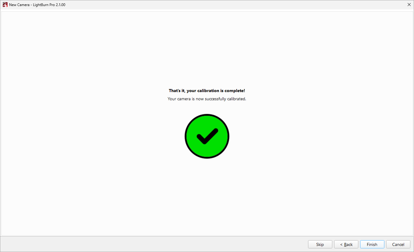

5. Success!¶
On the final screen, click Finish to close the process and save your changes. Next, you'll need to do Camera Alignment to align your camera to your workspace.

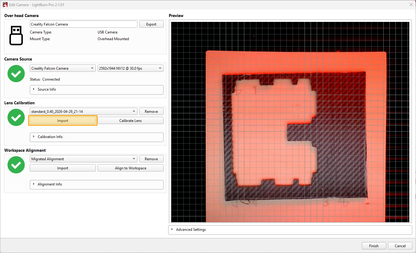

Import Existing Calibration¶
If you've already calibrated your camera and exported a LightBurn Camera File, you can import and reuse that calibration. Camera Lens Calibration only depends on the camera, not the mounting within the device, so even if you've moved the camera, you can still reuse the lens calibration.
- Open the Edit Camera window in one of the following ways:
- In the Laser Tools menu, select Manage Cameras, then select the camera you want to edit and click the Edit button.
- In the Cameras / Overlays Window, right-click on the camera you want to edit to open the context menu and select Edit.
- Select the Import button in the Lens Calibration section. See the screenshot below for the location.
- Select your
.lbcmfile and click OK.
