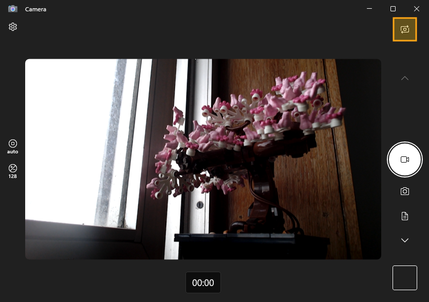

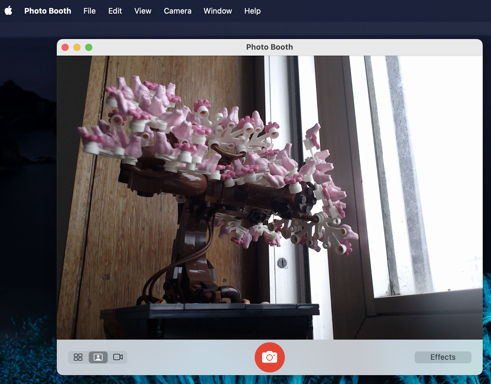

  • Make sure your computer is able to connect to the camera. If your computer can't access the camera feed, LightBurn won't be able to access it either. To do this, use your computer's built-in camera software (Camera for Windows and Photo Booth for macOS) to view the camera feed. Directions for both operating systems are below.
    I can see the camera and video feed
    If your built-in camera app sees your camera and gets a video feed, your computer can see the camera. Skip checking the USB cable and jump to making sure you've granted LightBurn permission to access your camera.
    I don't see the camera or there's no video feed
    If you can't connect to your camera and get a video feed, you'll need to get your computer communicating with the camera before worrying about LightBurn. Try checking your USB cable as described below.
    Open the Windows Camera app and select the camera you want to use in LightBurn. The highlighted button in the top right corner cycles through all of your connected cameras.

    Open the built-in Photo Booth app, and use the Camera menu to select the camera you want to use in LightBurn.
    Camera menu opened in Photo Booth app

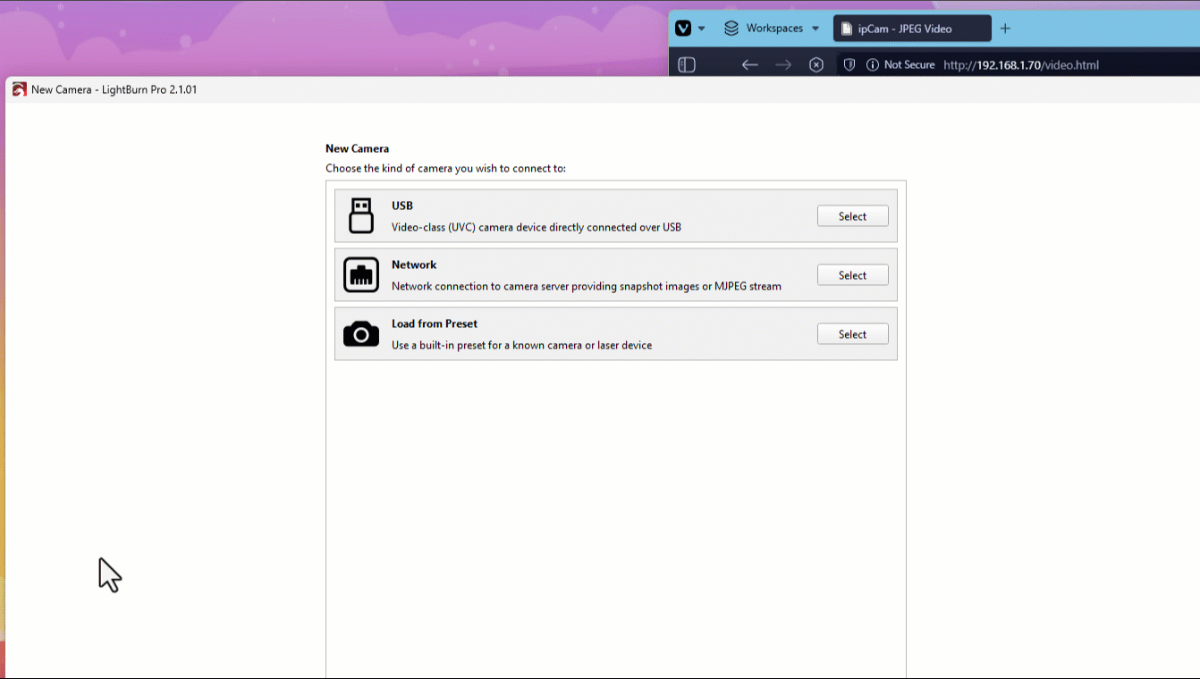

Network Cameras
Typically, the URL for the video feed should be provided by the hardware manufacturer, or within the software if software is included.
Most security-style IP cameras use RTSP to stream video, which is not supported in LightBurn.
In general, if you can load your network/IP camera feed in a web browser and see a simple video feed — no UI for commands or controls — it should work in LightBurn. Any URL starting with rtsp:// is using the RTSP protocol and is not compatible. Some RTSP cameras can provide both RTSP and MJPEG streams. See your camera's user guide for more information.
If you're looking to buy a new camera, look for one with MJPEG streaming.
Getting the Correct Feed URL
The web URL provided by many camera manufacturers is to a page that displays the camera stream, not the camera stream itself. If you can see the camera preview in your browser but get an error saying "URL seems to be invalid. Ensure that you are connected to the same network as your device", this is often the reason.
In the GIF below, using the URL provided for my example camera (http://192.168.1.70/video.html) results in this exact error.
GIF of getting IP camera feed URL
To fix the error, try the following, as shown in the GIF:
  1. Right-click on the camera feed in the browser.
  2. In the context menu that comes up, choose Open Image, Open Image in New Tab, or Open Image in New Window. Depending on your computer's operating system and your preferred browser, these options may be named slightly differently.
  3. You should now have a page displaying a single image. Copy the URL from this page, and paste it into the Network URL bar. If this URL is valid, your camera feed should load when you click out of the box.
Why not copy the entire URL?
If you see a ? followed by a bunch of characters, it may or may not be a necessary part of the URL. This particular camera works fine with or without it.
If this method didn't work:
If right-clicking on the video feed doesn't offer you the option to Open Image, Show Image, Load Image, or something similar, you may not be able to get a valid video feed, or you may need to get the feed another way. Please reach out to support for help, and include what camera you're using.

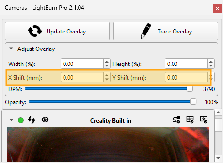

Any time your Camera Overlay is misaligned, please check the following:
  • Make sure your Start From mode is set to Absolute Coords.
  • Check the Adjust Overlay to make sure X-Shift and Y-Shift haven't gotten changed. For most users, those values should be 0.
Screenshot of the Cameras window annotating where to adjust the X-Shift and Y-Shift values
Demo of adjusting the X-Shift, Y-Shift, width, and height values for the Camera Overlay
If these checks don't fix the problem, we have suggestions below for different situations.
